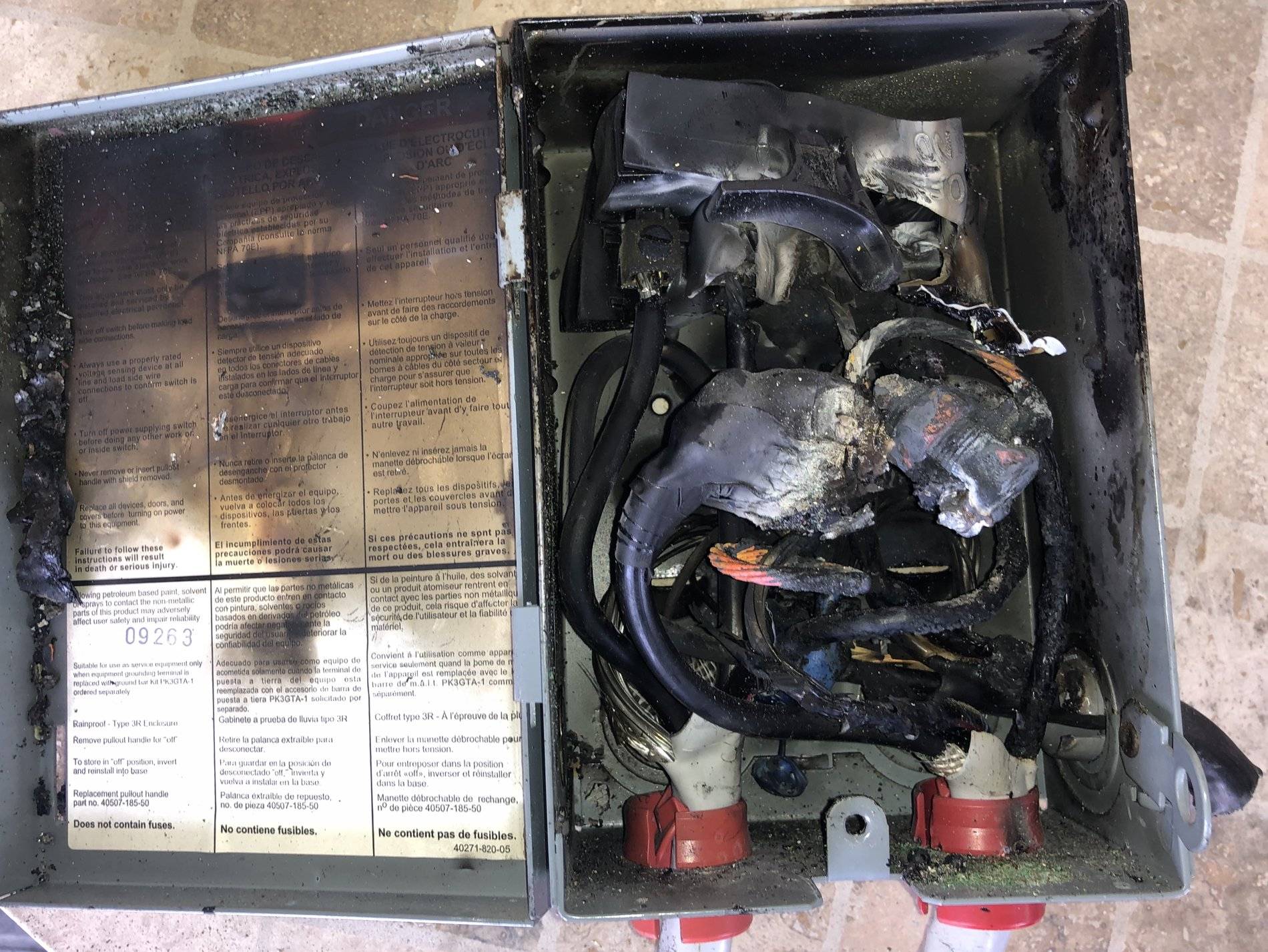

+10000000 for what epirali said - the ONLY way a EVSE/Charger "knows" what a circuit can handle is via the kind of PLUG-Adapter the unit is currently using…
there is _NO METHOD_ to "check" what a circuit can handle - the Porsche Unit and Tesla unit "imply" the correct current (volts * amps) from the current adapter attached to the unit.
you should only be using the sorts of adapter that match the breaker and wiring for the plug you are plugged into.
this is what can happen if you try and pull 40/50 amps across a 30 amp circuit - good thing the metal box stopped the fire

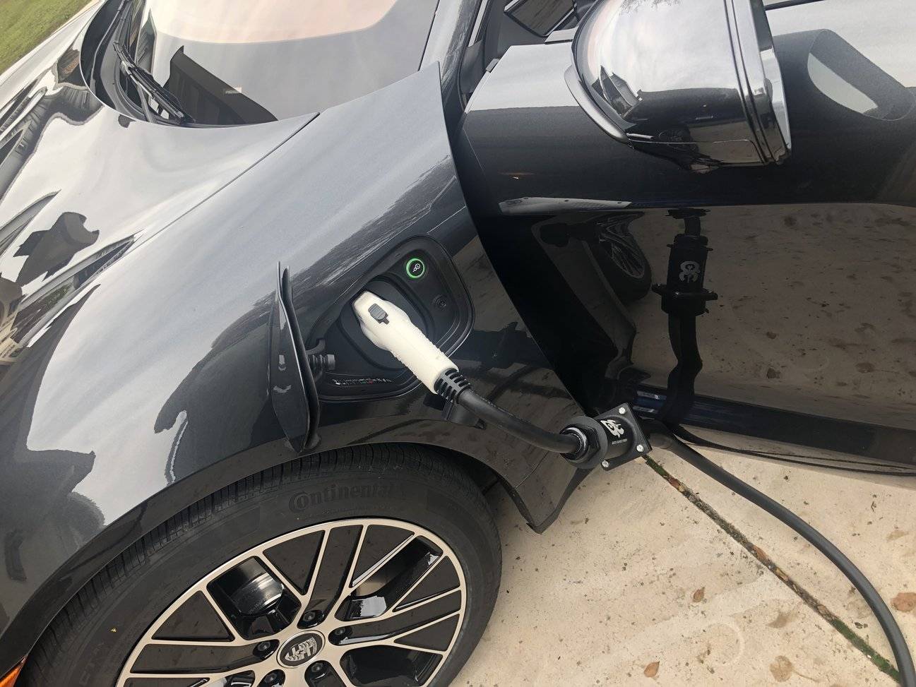

So does the vehicle, in this case the Taycan, know what you are plugged into, especially in homes, whether a 120v plug or a Dryer plug with 40 amps or 60 amps? how is this controlled so that the vehicle doesn't attempt to use too much amperage and trip breakers or cause potential fire hazard if someone has a too high amp breaker but a too thin gauge wire.? There must be some sort of control, either automatic or manual.
there is _NO_ control.
you trust that the correct wire is installed for the correct breaker - it's a building code violation and a fire hazard to say for example use a 50 amp breaker with wire only rated for 20 amps - therefore the ENTIRE system is based on the premise that electrical circuits are installed in such a way that the wire & breaker & plug are all "matched" to the correct anticipated loads - in this system the breaker is the fail safe - it is supposed to "trip" if the electrical current exceeds it's rating (old days it was a fuse) - the breaker trips before the the "wire" will fail/melt/catch-fire - at least that is the theory - breakers are only about 99.99% reliable, which means they can fail - the last "safety" in that system is that your device electrical cord has a particular plug type- and the plug type also is matched to the maximum current the device should ever use - therefore the device should also never use more than the current indicated by it's plug - keeping the whole system "safe"...
this all falls apart and can cause great danger if you buy a $29 plug adapter from Amazon that coverts a 50 amp device plug (say an EV charger) to fit into a 20 amp plug in someones/your home - the device will still attempt to pull 50 amps, but will now be doing so with a breaker/wire/plug only rated for 20 amps - if you're lucky the breaker will trip before any damage occurs - if you're unlucky things will melt and potentially catch fire.
so if you TRUST that the breaker and the wire are "matched" - then you can plug _ANY_ device into that plug that uses _LESS_ than the breaker rating…if you somehow manage to plug a 60 amp device into a 30 amp plug (via an adapter you find on Amazon) then you could potentially pull too much current across the 30 amp rated wire, it will melt and if you lucky short out, and if you're not lucky start fire.
if you are converting plug types YOU ARE RESPONSIBLE for knowing what you are doing!
For example converting a NEMA 14-50 plug (the standard plug on the Porsche Charger) to a 30 AMP plug (NEMA 10-30/14-30) the Porsche Unit will "assume" it has a 50 amp circuit - it will NOT know you have plugged it into a 30 amp circuit- and will happily sit there and pull 40 amps from the 30 amp wire/plug/breaker...one of several things may/could happen
  1. the 30 amp breaker will trip because of the overcurrent load - this is why we have breakers
  2. the breaker could fail and not trip - at which point the wire will most likely overheat and short out or start a fire
@louv got away with his conversion because his father installed a 30 amp circuit that was OVERSPECIFICATION - even though there was a 30 amp plug for the dryer, the wire was 60 amp rated, and the breaker was 60 amps - so there was no danger in converting the stock Porsche NEMA 14-50 plug to the dryer's 30 amp plug…
but in general the plug type indicates the maximum current (volts * amps) that the plug and it's wiring and breaker are rated for.
it's dangerous to covert from a 50 amp plug to a 30/20 amp plug type if the device in question will pull the full 50 amps.
the "AUTOMATIC" systems are in the fact he PLUG currently attached to the EVSE/EV-Charger - it is assumed that you are plugging into the correct plug type - and therefore building codes will make it such that the plug type has correct wire/breaker for that type of load.

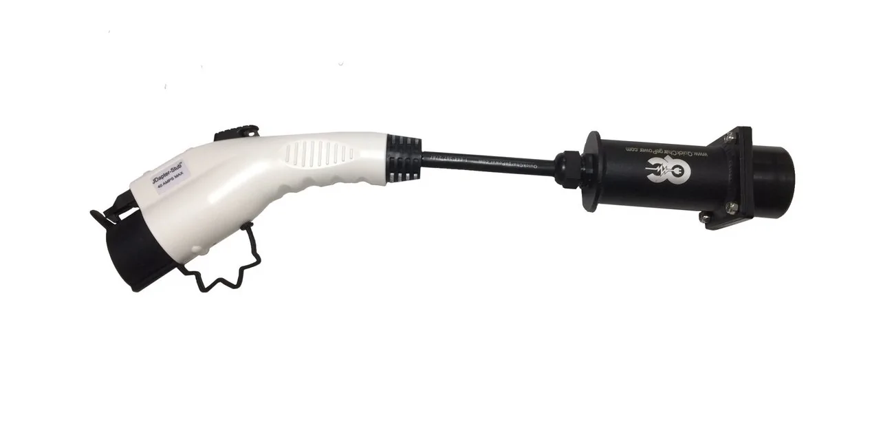

If you have an existing Tesla charging install that you are super happy with - and you are wondering if you can charge your Taycan using your existing Tesla chargers (both Wall Charger and Mobile Charger) - the answer is _YES_!!!
You only need to purchase the following adapter - and your Taycan can/will happily charge from your existing Tesla charging system
https://shop.quickchargepower.com/JDapter-Stub-40-Amp-Tesla-Charge-Station-Adaptor-JDPTRSTB.htm
Porsche Taycan Amperage usage control considerations for home charger 792312474_9081a692ae2d26d7bcb12e03ab73a14e8dc897f0
Basically this adapter coverts any Tesla L2 to a standard J-1772 plug - enabling your Tesla chargers to charge _ANY_ J-1772 EV (like the Taycan, but also Bolt, Cayenne Hybrid, Panamera eHybrid, Leaf, Mercedes, etc…)
This will allow you to integrate your Taycan into your existing EV garage and not have to switch between Tesla and standard J-1772 chargers.

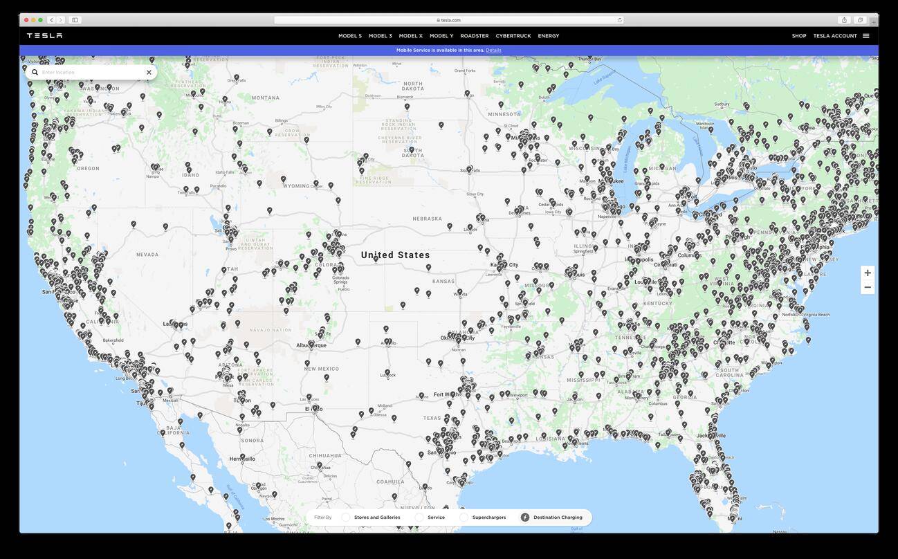

Tesla Desintation chargers are normal L2 20-80 amp chargers installed/available at businesses - and mirrors the Porsche Charging Service for L2 chargers are destinations where people go.
Porsche Taycan Amperage usage control considerations for home charger _37_12_pm_774b5cafbf06cc5b94a4f30c7b6ae93f9d465183
There is no "network" and there is no membership required, and there is typically no billing - use of the chargers are at the descretion of the business owner where the charger is installed. All you need to use one of these L2 charger is a car that can plug-in - and the jDapter is the adapter that will let your J-1772 Taycan plug into _ANY_ Tesla L2 charger.
This adapter will NOT allow you to use the Tesla Supercharger network - sorry!
I have carried this adapter in my Bolt's for years and I use it both at home and while on the road - many times at hotels/business that may in some circumstances only have Tesla L2 chargers on site!
It's a must have for any serious EV owner in my opinion given the proliferation of Tesla L2 chargers over the past 8 years and is cheap insurance if you plan to drive around with your Taycan and want the maximum opportunity to charge your Taycan where ever you may find a charger (Tesla or otherwise).
https://www.tesla.com/findus?bounds=58.187042720255945,-89.06853315875554,7.61104618126224,-154.63493940875554&zoom=5&filters=destination charger

This adapter converts the Tesla UMC connector to a standard J-1772 EV charging connector - it allows _ANY_ J-1772 EV to charge from a Tesla L2 charger (NOT superchargers). For those of you that don’t know Tesla supports what they call a Tesla Destination charging network (chargers installed with Tesla’s assistance at various locations all over North America - these chargers vary in Amperage from 20-80 AMP’s and are typically free if you are a customer of the associated business).
Even if you do not plan to use a Tesla charger for your mobile or home charging situation - this adapter is highly recommended by me for EV road warriors as it will "force multiply" the number of L2 chargers you will have access to while traveling. With this adapter in the car you can charge at any public J-1772 charger AND any Tesla Destination chargers you happen to encounter! So more choice for L2 charging - win win!
For existing owners of Teslas (I know you're out there) that have existing Tesla charger at home this Adapter will let you Taycan charge from your existing Tesla UMC and/or Wall charger - so you do not need to buy a new charger for the Taycan.
The link below is an interactive map of all the Tesla L2 Destination chargers - if you have the $239 adapter you can use these charging locations (with permission) in addition to normal J-1772 chargers - so you great expand your potential charging solutions if you have this adapter.
https://www.tesla.com/findus#/bounds...arger&name=usa
You do not need a “membership/account” with Tesla for use of these chargers, usage is at the discretion of the associated business owners - NOT Tesla. Many of these business have both J-1772 and Tesla chargers on site, and carrying this adapter simply offers you the choice of using a Tesla charger if all the J-1772 chargers are occupied - most business owners won’t care. In some rare cases some businesses have ONLY Tesla chargers and this adapter would let you charge your EV should you encounter this situation. Other forums have had extensive discussion on this topic and I believe it is well established that this adapter is a MUST have for any serous EV road warrior, even _IF_ you do not plan to use a Gen-2 Tesla UMC for your home charging solution.
