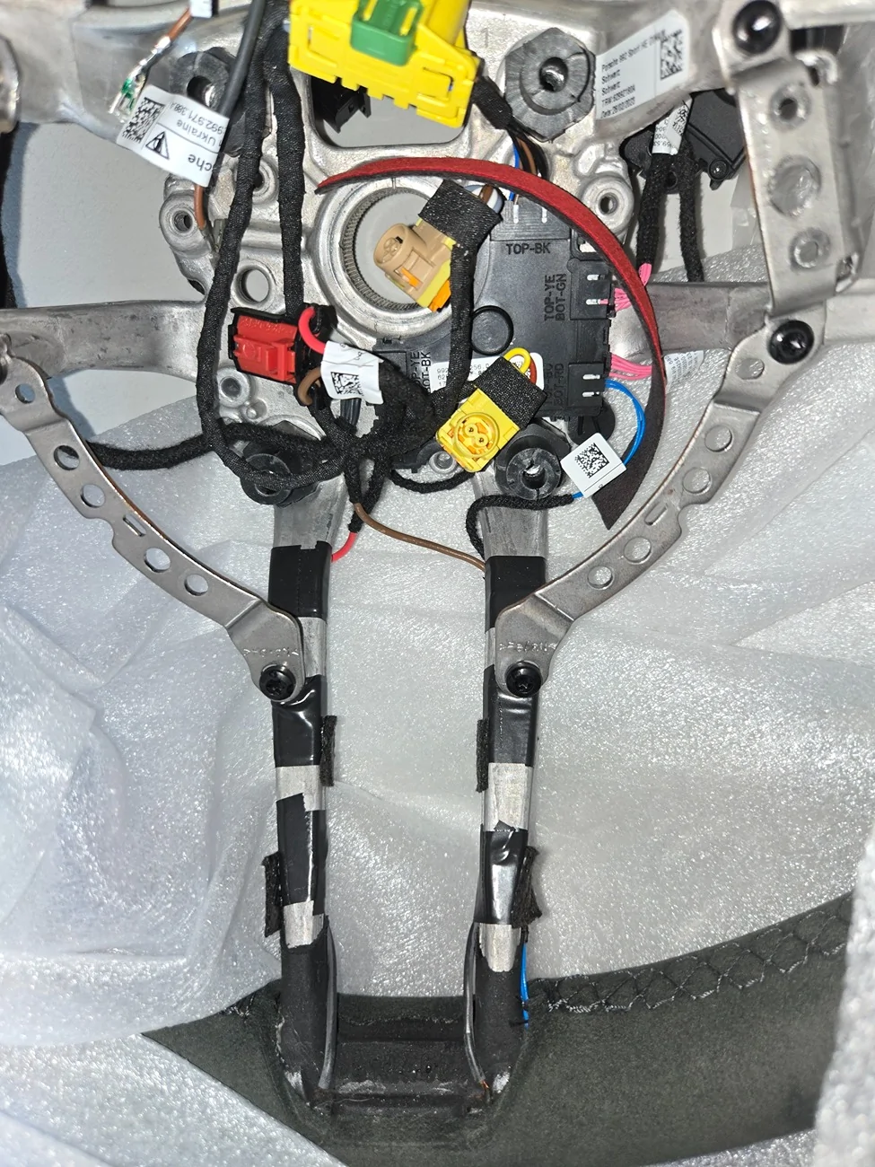

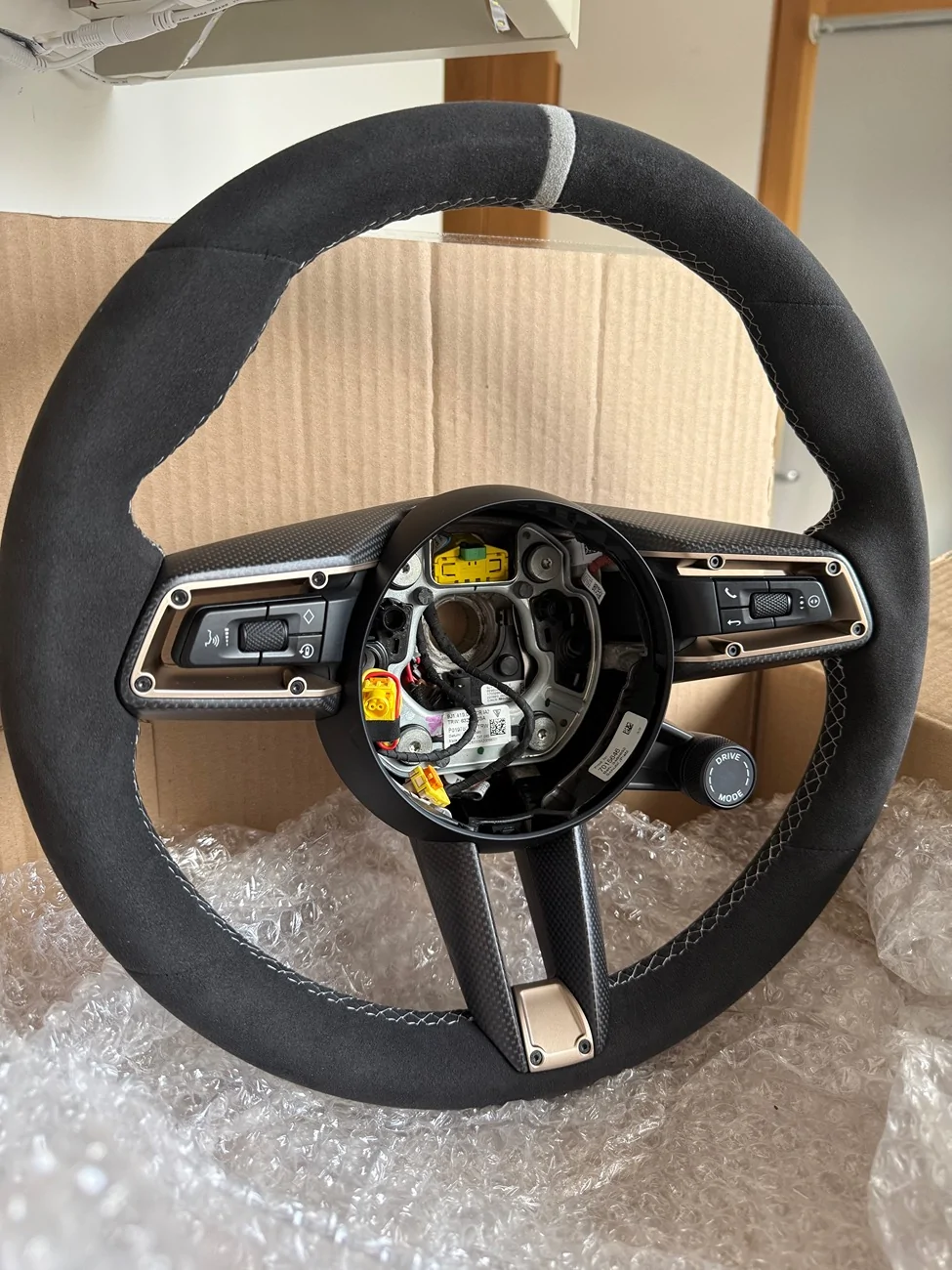

I have an Alcantara wheel to go on my car, will swap everthing. The new wheel is heated, as is mine but doesnt appear to have a heating switch, just a couple wires where the switch would be. Are the switches easy to swap over as well?

So in the photo there is the heating wires at the bottom, surely there must be a way of swapping the button over from my ecisting wheel, anyone?

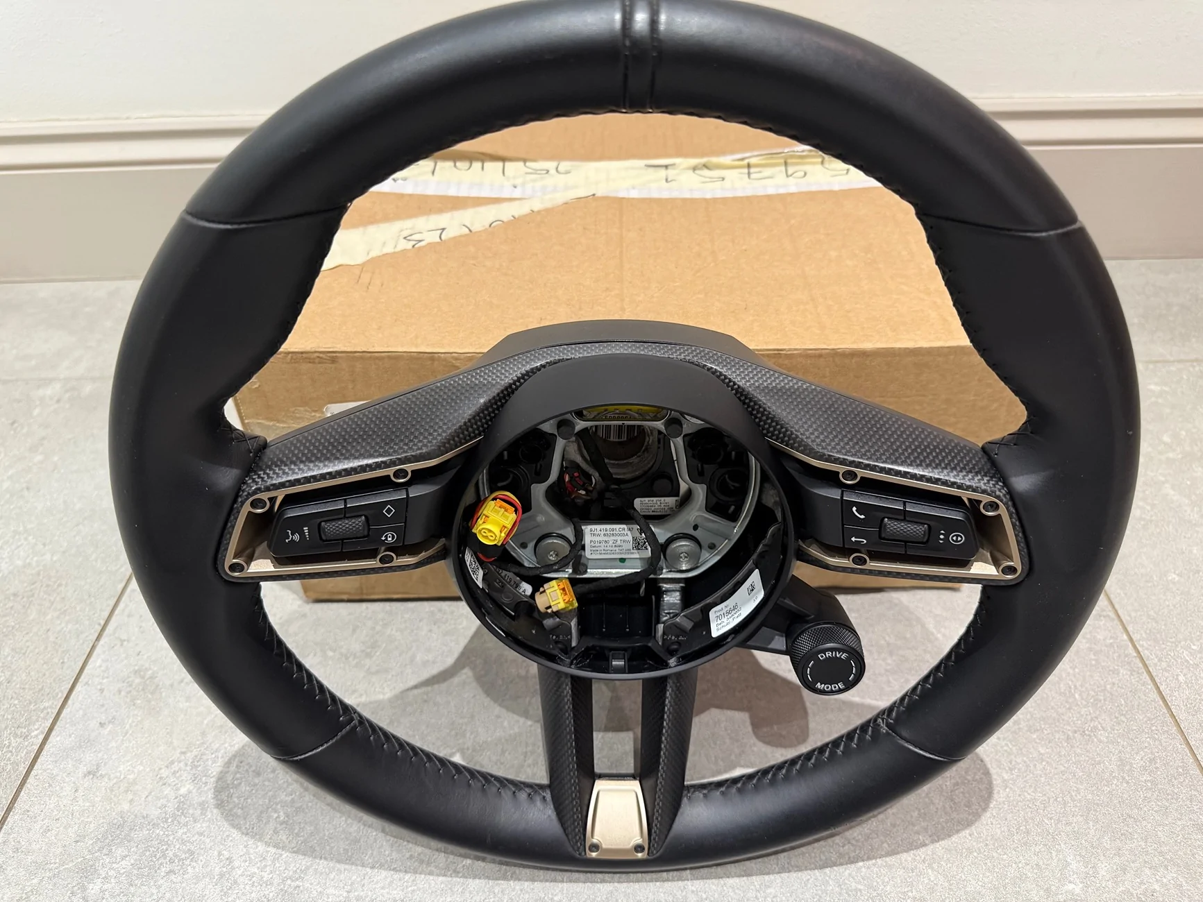

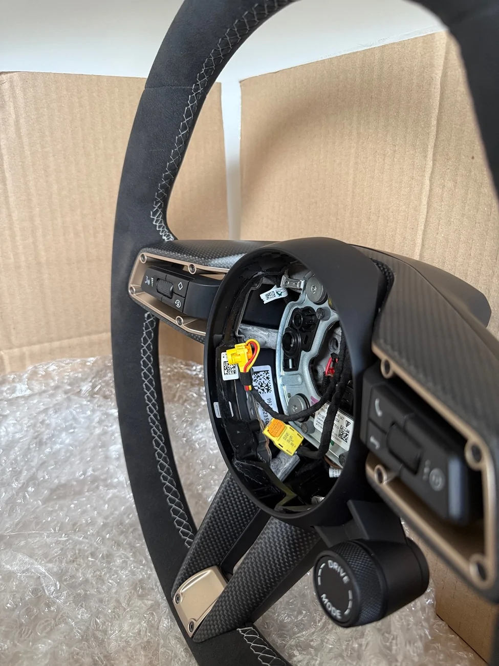

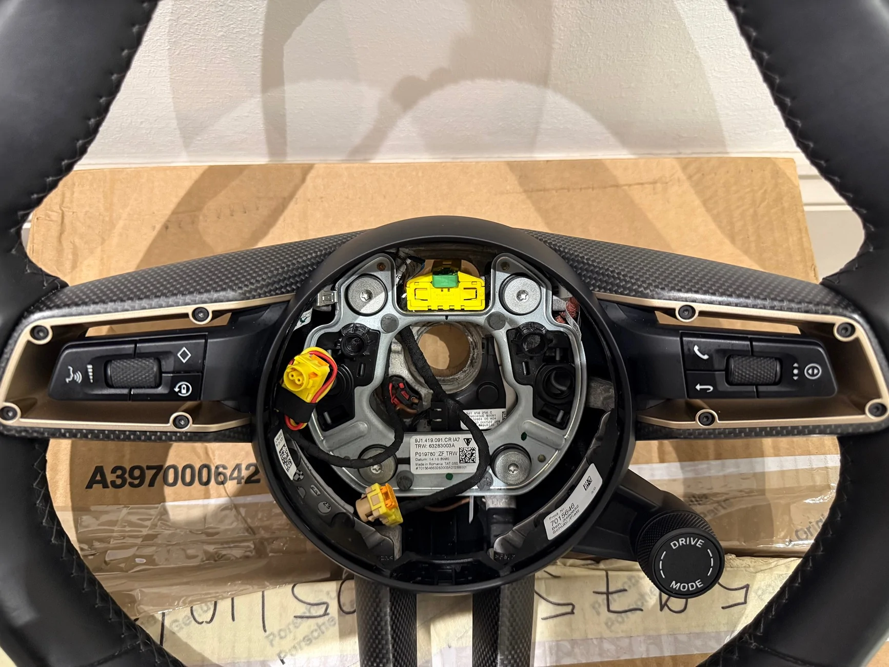

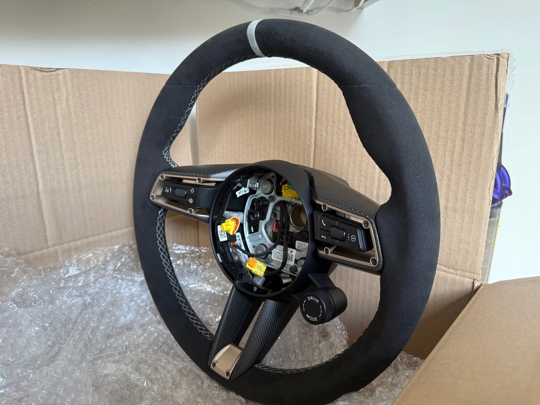

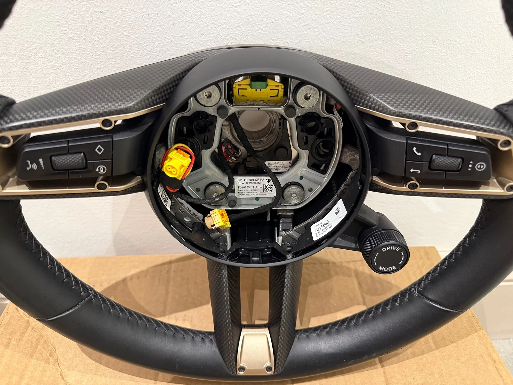

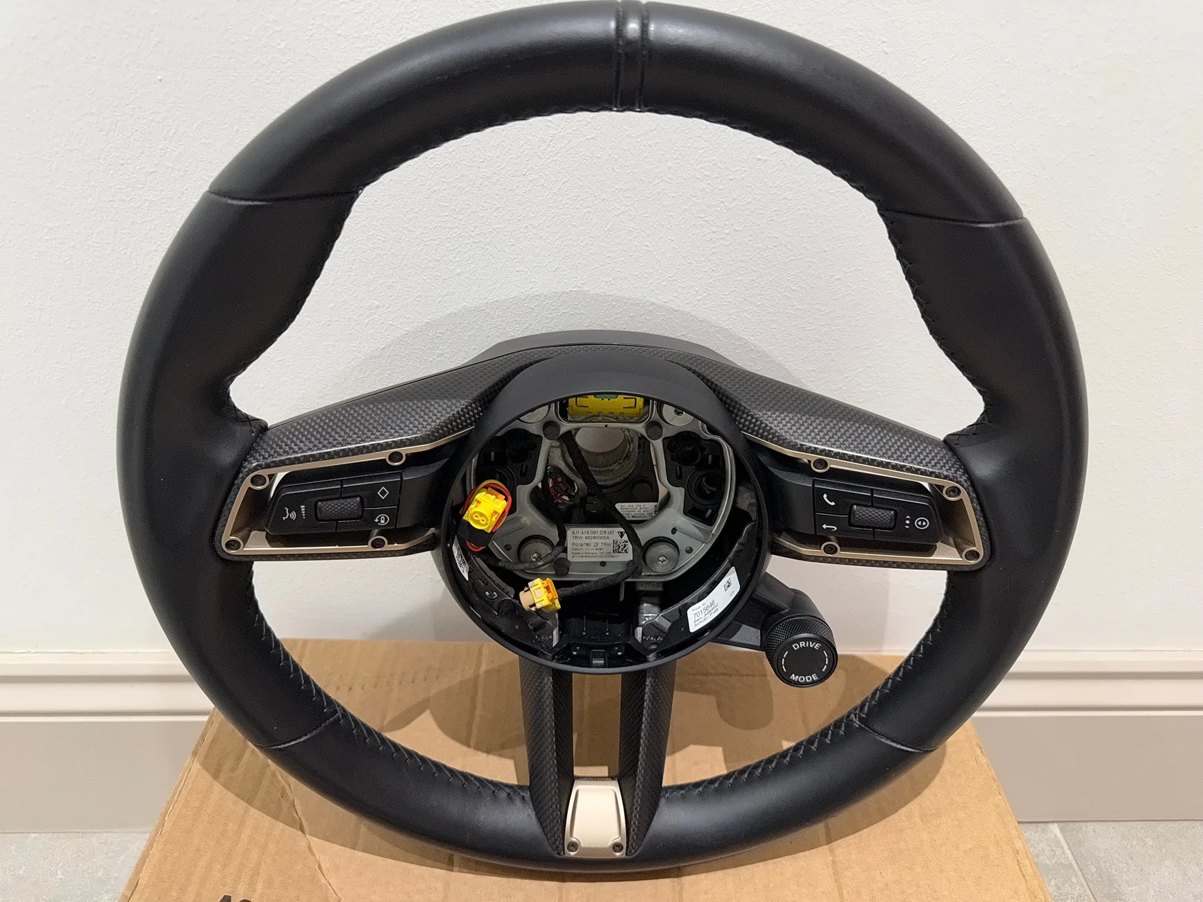

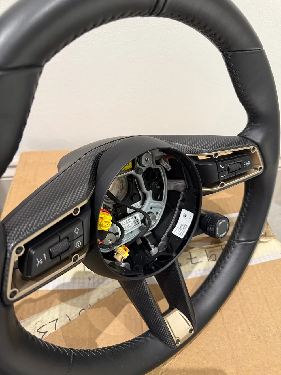

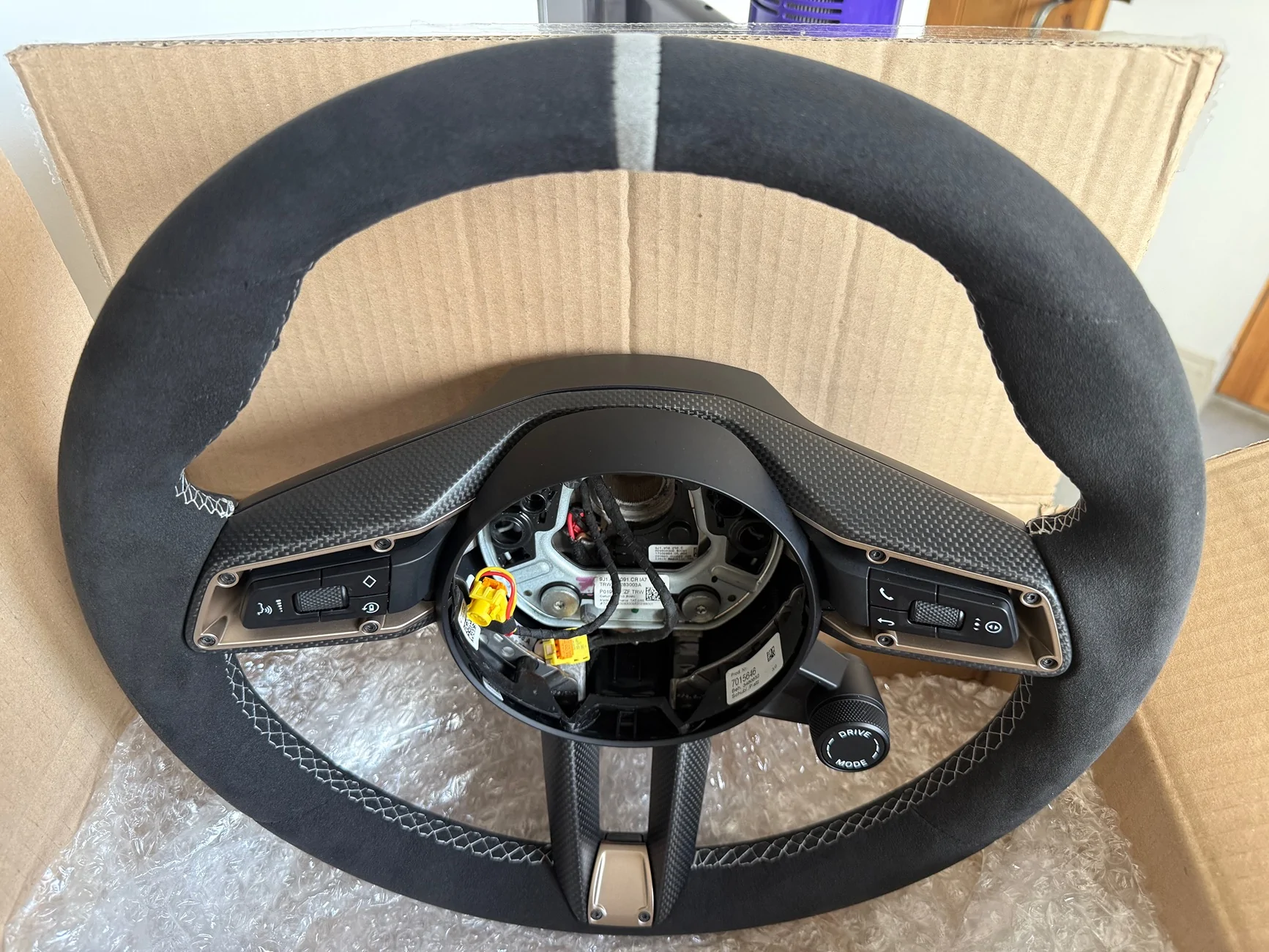

So, I’ve finally got round to buying a brand new second hand wheel, with the plan to get re covered by Jack Royal (uk) in oem race tex style Alcantara.
The wheel I’ve bought has the oem carbon trim and neodyme and is also heated. I dont have heating currently.
First q is, is are all the wheels the same thickness or is race tex thicker? The re trim can make the wheel thicker?
Second q, so if I strip the wheel down of the inner modules to avoid coding all will be good when I swop over? Jack Royal charge £20 to remove the plastics but may be worth it to avoid me breaking the clips on the carbon trim?

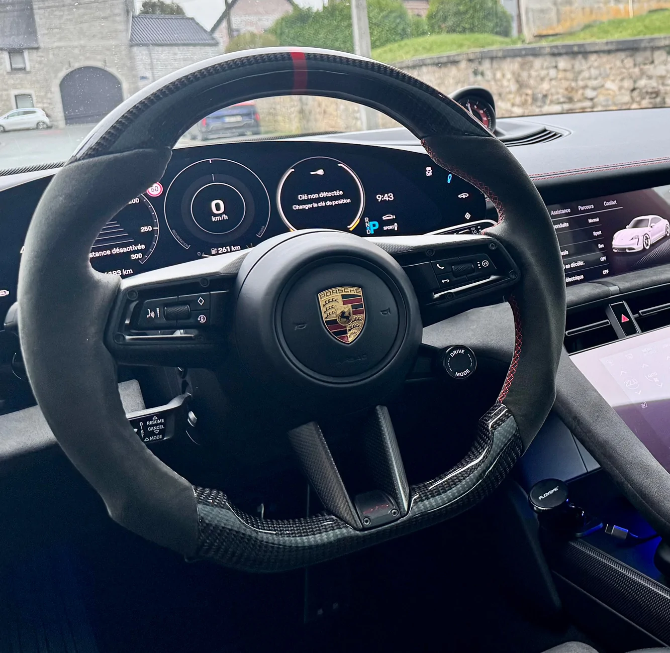

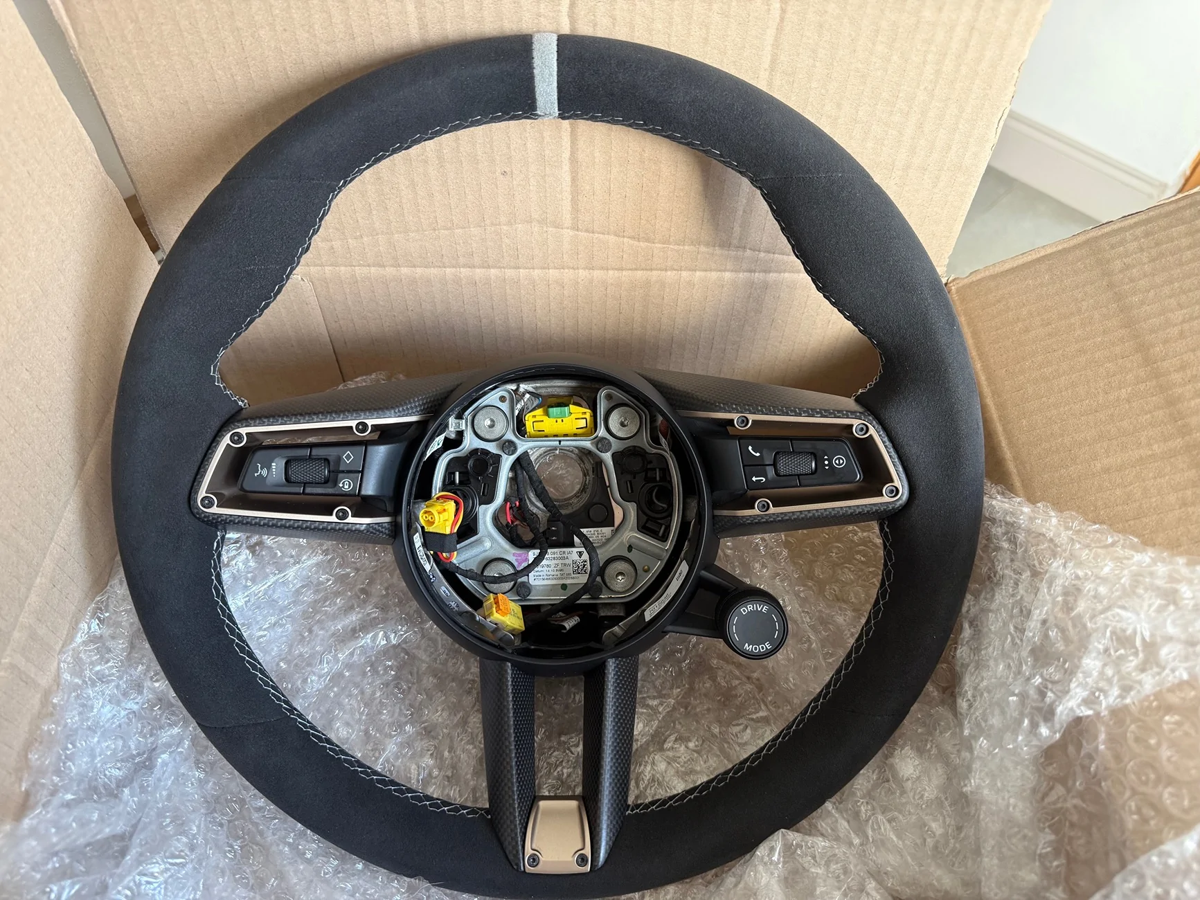

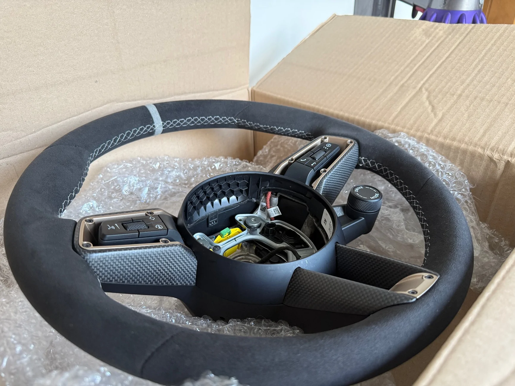

Finally got round to getting the wheel re trimmed by jack royal (uk). Very happy. Looks mint. My car is crayon so decided to go with stitching/ band to match.

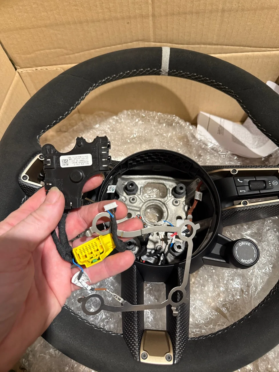

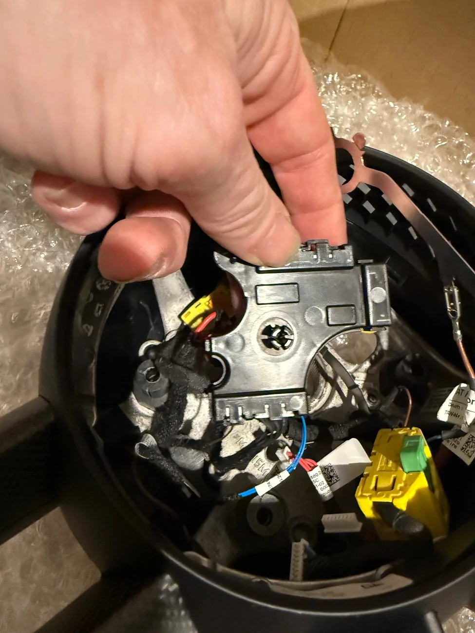

Ordered a XZN Triple Square Spline Bit Socket Set with a selection of bits but believe it to be the m12 I need to remove the main bolt to remove the wheel.
Also, removed the module from this wheel with the 5 or 6 connectors. Fairly nerve racking this bit trying not to pull on the wiring and damage it but all the tabs are out!
