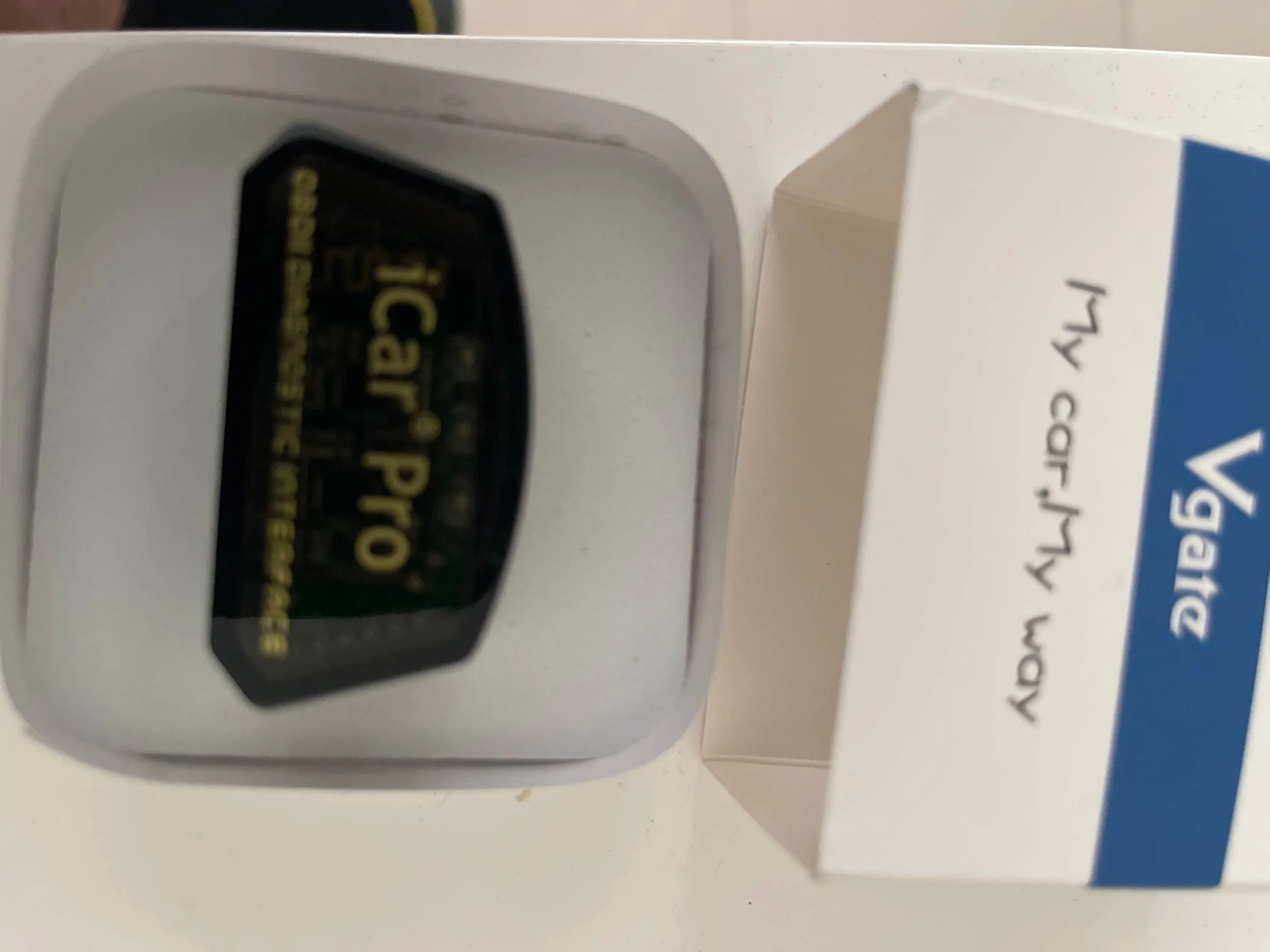

My 2020 Taycan Can only show 300 km at full, so i Will try to messure the SOH with a OBD.
Thar app are You using?
I bought the Vgate Icar Pro at Amazon.
I have iPhone and the OBD are recommended Carisda, OBD JScan or Car scanner.
any recommendation??
And where are the OBD in the car?

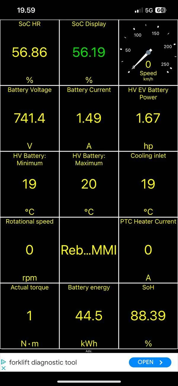

I finally had the obd connected and it shows 88,39% SoH. A 2020 4S with 60000km. Is that more or less normal?
I used car scanner, can I also get the single cell voltage?

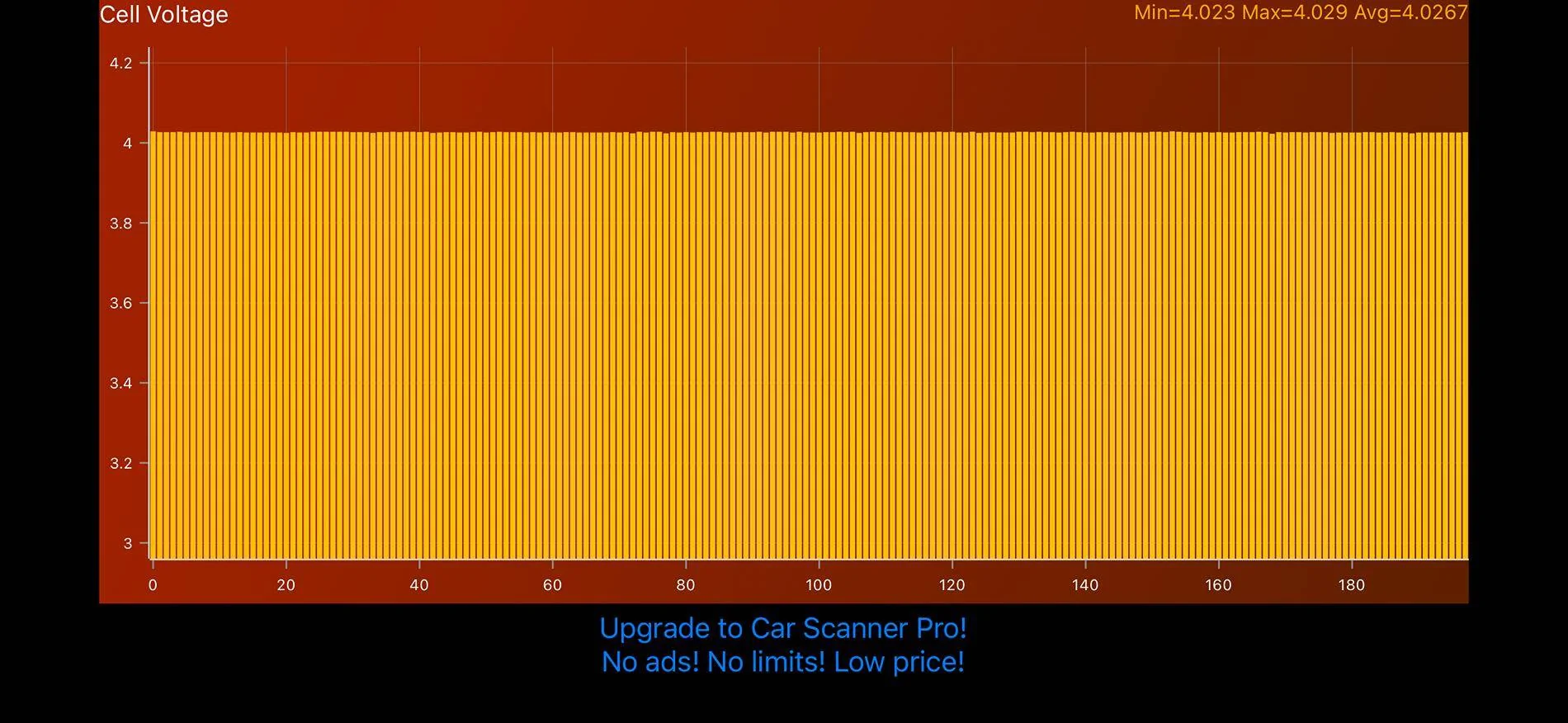

Yes, here’s mine …
