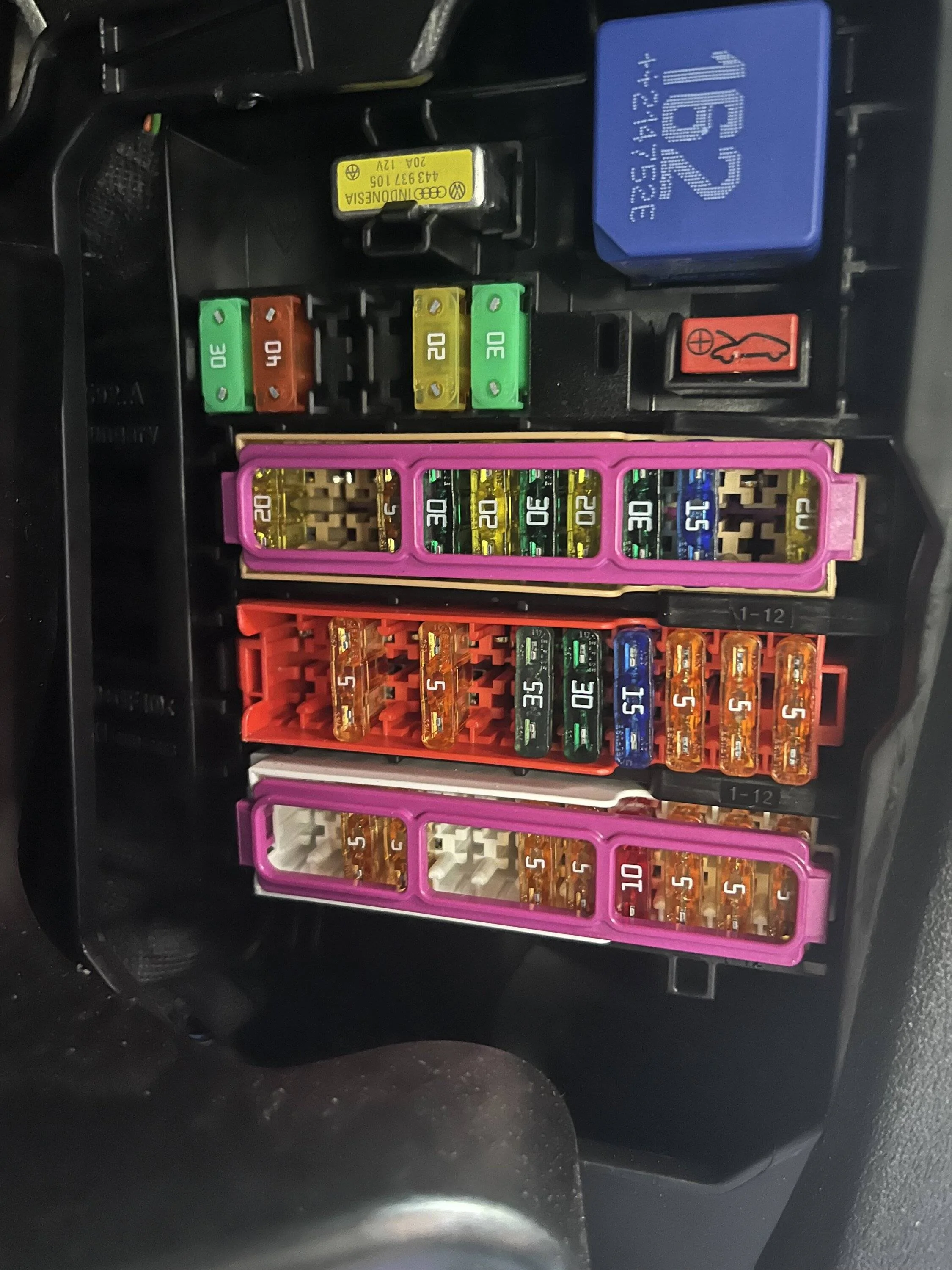

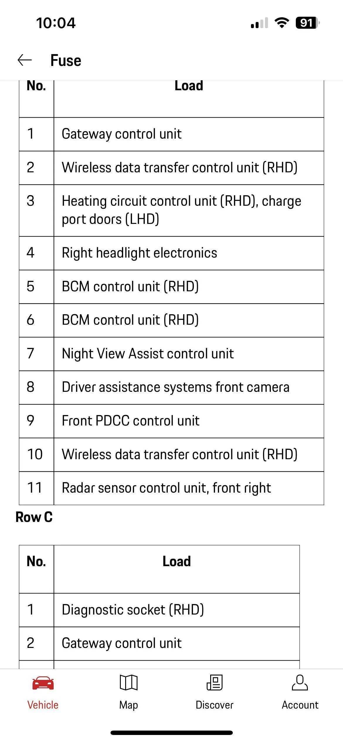

Yeah, I had the same problem for a few days after being away for a week. I ended up pulling the fuses that power the Wireless Data Control Unit (Row B 1 & 10) and after 5 min the LTE symbol was back. Also lost internet radio but had the SOS LED green.
App connecting fine since, so worth a try before booking into the dealer?
Ok, half-wit alert time!
I don't seem to have a fuse in B1, or do the numbers go from right to left (although i note it has 1-12 imprinted above)?
Also my manual says the data control unit are in B10 and B2, and that B1 is the Gateway control unit (whatever that is!)
In the end, I pulled the 3rd from right (10 I think) for 5 minutes. Just long enough to get a long screwdriver with some chewing gum stuck to it, to retrieve the fuse that dropped into a recess behind some metal framework thingy.
anyway, no change yesterday, though it has mystically started working overnight.
thanks all for help and suggestions.
Hi Bob,
Sorry for not helping out with the question. If you looked at the diagram on the reverse of the footwell panel it would show that fuse number 1 is on the right side, so it would have been the 2nd from the right end and the last one on the left.
However any use of chewing gum will normally provide miraculous results... glad it's working now.

Hi Bob,
No diagram on the reverse of my panel. Also missing the tool to get the fuses out, hence my sausage finger failure and chewing gum requirement!
