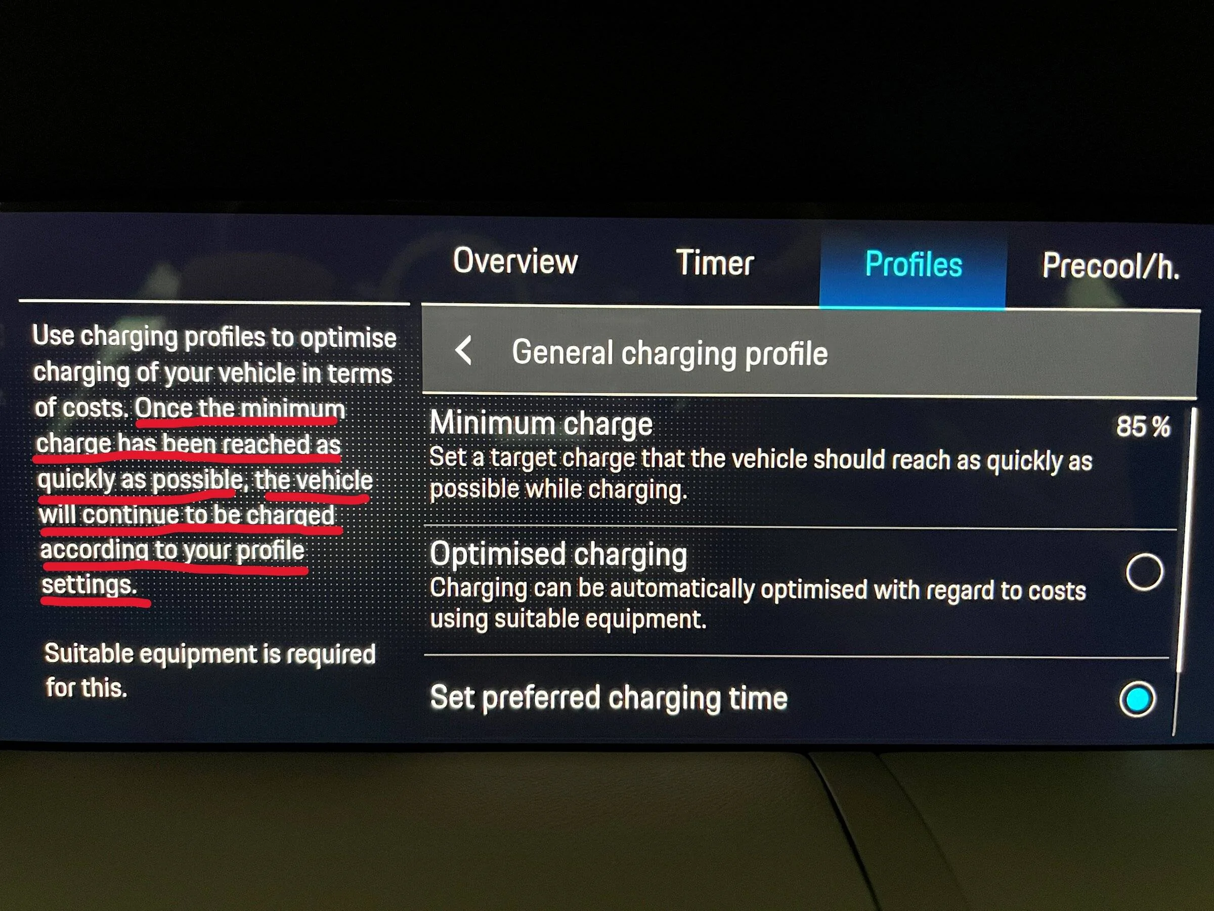

I just went to change the charging profile from "Optimised charging" to "Set preferred charging time" (12:00am - 12:00am). Then I realise an explanation at the side, it sound like it will resume change if I understand it correctly!

It doesn't matter - you don't need to be driving it daily nor by a pre-set time - the suggestion is simply to curtail your current charging problem. I use the suggested profile & timer combination but don't use the car daily - works perfectly.
Disconnecting from WiFi won't do anything - charging is controlled by the car and not your EVSE (PMCC).
There is mention of what happens if your cable is left connected and there is no pending future charging event (in the Porsche Good to Know App - search in there) where the car will start to charge until it reaches 100% - sounds like your issue.
Without a timer, the car will charge to a target of 100% during the preferred charge times. If you have a timer set, it will stop at the timer’s departure time.

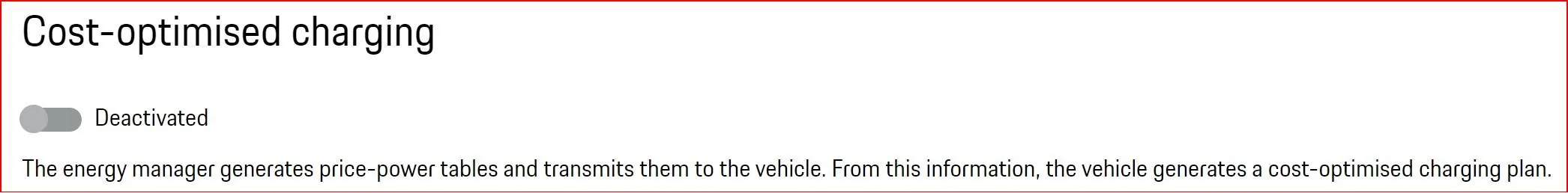

I think I have fix the problem.
In HEM, I disable "Cost-optimised charging". Previously was enable by installer.
Porsche Taycan Car Resume Charge Until 100% If Cable Plugged In Screenshot 2022-03-24 232602
In Car, I set 85% in general profile.
In Car, I select "Optimised Charging" in general profile.
Now, it stop at 85% even if I leave charging cable plugged.
I think in this setup, the car immediately charge to 85% as soon as I plug in. Once it reach 85%, the car don't have a price-power tables, which I guess the car see it as no preferred time at all and hence does not continue.
