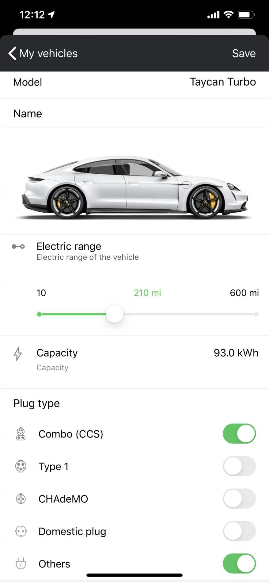

Finally picked up my Turbo yesterday and went to an EA charge site this morning. All went well but was wondering about the vehicle settings in the app. Noticed the battery capacity was set at 83 vs car spec of 93kWh so updated that. Was wondering what range to use with 21" tires as this impacts the charging route planner. Currently set at 210 but that may be a bit to generous, thoughts?
Also only have Combo plug type turned on, assume that covers the other types without specifically turning them on, coorect or not?
Thanks in advance.

The battery may be 93KWh, but only 83 KWHr are usable, as the rest are used as top and bottom buffer both for logenvity of the battery and to allow regen to work at full charge. This is pretty normal for all EVs, the Porsche is more conservative than Tesla or others because they seem to use a more strict engineering standard. This is a good thing.
As for Combo charger if you mean fast charger the Porsche is CCS not Chademo. Combo implies it has both cables but you don’t want to leave out CCS alone. But you do want to see what the KWHr charging rate is, not all Electrify America locations support the fastest charge rate. Taycan can do up to 230 KWHr, but a lot of chargers may be only 50 KWHe.

Ah, that makes sense on the setting for 83.Thank you, have attached screenshot of settings available, which should I select?
Porsche Taycan Charging America Settings BB46283D-BE70-4CC2-808B-EBDDBA45CCC2

Others is just a plug, you want combo CCS, type 1 but that is not fast charger, that will be up to 7 KWHr (same as home 240, good for long stay or a small topup). As for range you should probably use 220 or so to be safe.
