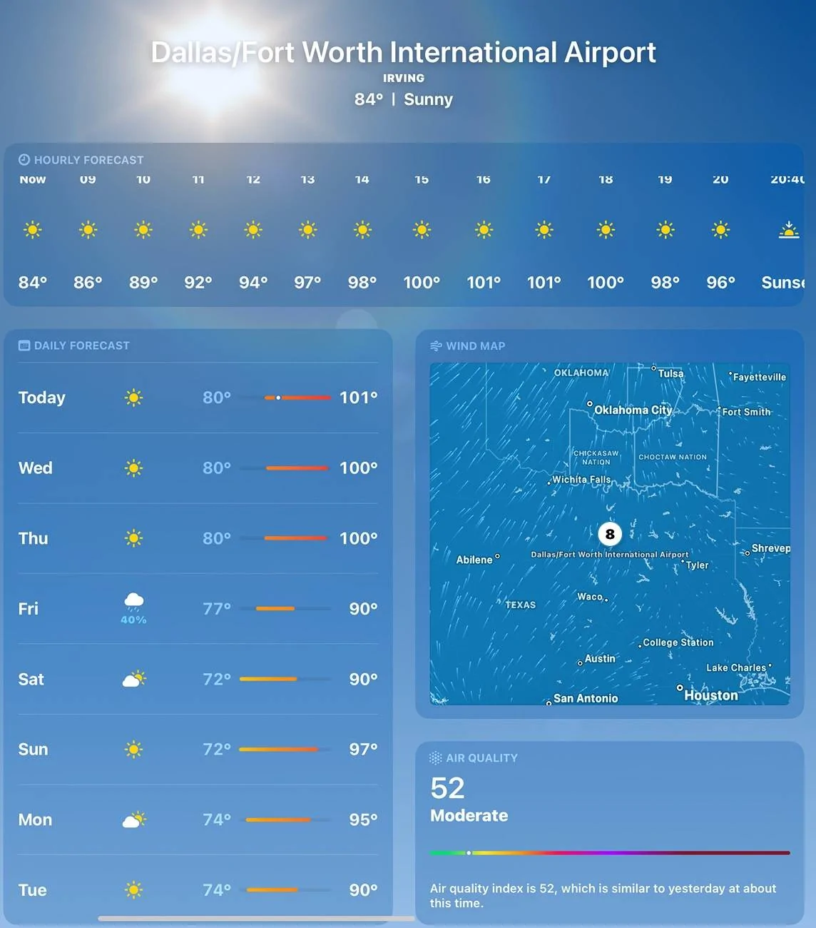

Ft. Worth/Dallas TX area right now is not condusive to 19.2 kW charge rates in direct sunlight between the hours of 10 am and 4 pm (max temperature during the day)
I'd suggest a combination of ambient weather conditions and expected thermal load from an 80 amp charging session is the "root cause" here - the only solution are:
  • lower the max output from this stations to achiever a lower but more consistent charge rate
  • cool the charging session (shade or fan) on the charging equipment and charging cord
  • wait for the weather to moderate during the day with lower nominal ambient conditions.
but yeah Dallas/Ft. Worth area appear to be hot for the next week…
I'm pretty sure in fall/winter/spring you'll have no issues charging at max rate due to lower ambient outside temperatures.
