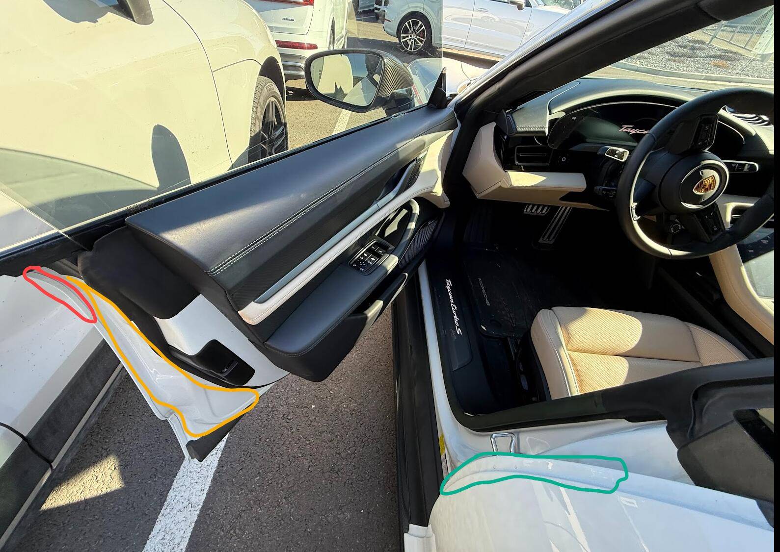

Hello all, I just bought a 2022 Turbo S in White. It's fully loaded and had all the options I wanted and white was my third color choice. I'm considering wrapping it with Chalk. I know...it's not a huge change but last 4 cars have been white so I wanted something different.
So here's my question, how does it look when you wrap chalk over white in terms of the insides? The area in red, do they wrap the edge following that seam? Then the area in yellow would remain unwrapped? What about the green area? How far do they take the wrap?
Lastly, any feedback about these options? Which vinyl is closest to Porsche Chalk? The Ivios PPF looks like a great option but I'm guessing it's the most expensive. My local PPF/Tint expert quoted $4500 for a color wrap. That sounds like a reasonable price, right?

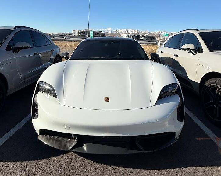

Hey Andy, I have the same situation — white Taycan with many options, being not my favorite color — and I was quoted approx $1850 in Europe for a full wrap with 7years lasting foil of any color and $1300 for 10years lasting PPF transparent cover of just the front (bumper, quarterpanels, hood).
Here's the company doing another Taycan, but no details on edges (which also bother me):

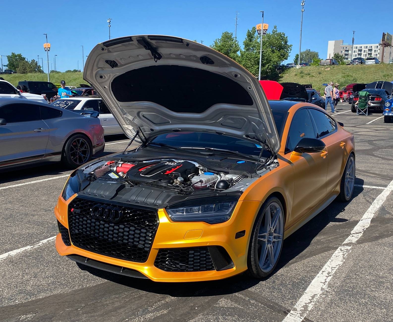

I had a color vinyl wrap done to my previous car. I paid $4500 for the wrap, ceramic coating, and PPF wrapping the front carbon bits. As a standard, they will wrap the edges just barely to create a clean line. You can see it where the wrap stops on the underside of my hood in these pics. It's the same for the door jambs:
Porsche Taycan Color Wrap - how does it look on the inside edges? IMG_2989.JPG
Porsche Taycan Color Wrap - how does it look on the inside edges? IMG_2972
However, some companies will also wrap your door jambs for an extra charge. The shop I use will wrap door jambs in a fun contrasting pattern as well. Check out this IG clip for an example:

The PPF/Wrap outfit I use told me that white is the hardest to wrap because the edges have to be very accurate to not show any tiny slivers of white paint. Black is the easiest because any thin slivers of paint fall into shadow.

Get colored PPF, not vinyl wrap. Vinyl has been causing issues with the paint.
For a proper wrap, you need to remove parts on the interior, like door panels, in order to fully cover any paint
My local guy said the exact same thing. Although if they miss covering it slightly, since it's chalk, it might not be super noticeable?
