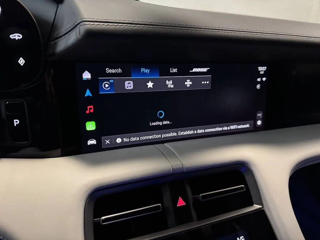

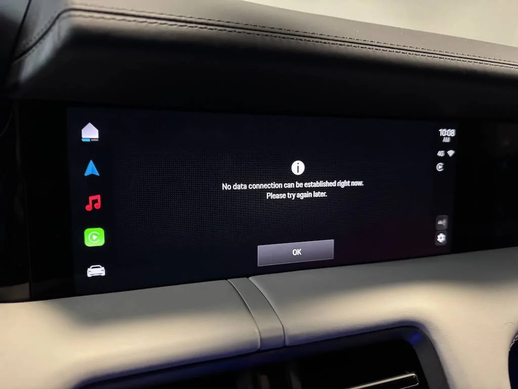

I have not noticed the two horizontal lines with a slash through it, and only error message from in-car is "No data connection can be established right now". Car drives fine and carplay works like I would expect.
The error message about no data connection can be established - at what point is that error message displayed/what do you have to do to generate that message?
Pressing media button
Porsche Taycan Comms module failure IMG_3395
Pressing weather button
Porsche Taycan Comms module failure IMG_3396

Huh? 2025 Taycans have the option to connect to a WiFi access point for internet access?!? For pre-2024 Tyacans this was an option exclusively available in Russia. Everywhere else Porsche blocked it (presumably in order to drive their own LTE subscription revenue).
What is the meaning of the message in this photo by @trycan from 2025 Taycan :
No data connection possible. Establish data connection with a WIFI network.​
New functionality here for 2025 models, or just misleading error message?

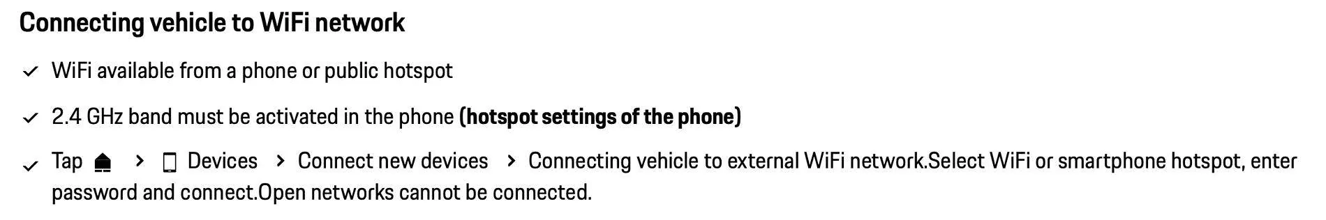

Yep. It's not clear exactly what they can use the external WiFi for, but at least they can connect:
Porsche Taycan Comms module failure Screenshot 2024-11-05 at 9.06.36 AM
The option disappeared after I logged out, so maybe it's not supported on the Guest account.
I'm hoping that it will allow basic communication with the app if I let the Porsche Connect subscription lapse (but I'm not holding my breath).

I wonder what this connection between the vehicle and a WiFi network will do?
Based on @trycan post with images, implies that such a connection would enable online networked media.
