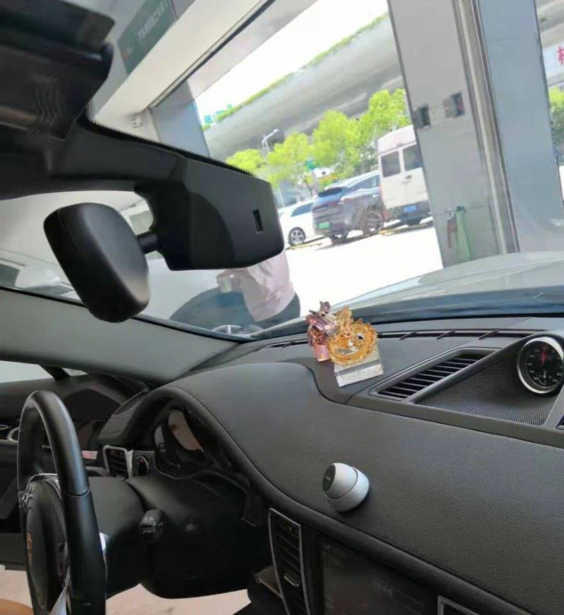

I have a Mercylion A40-1CH dashcam on my 11 Paramera. stupidly easy to fit - its connected to the battery which sits under the passenger side seat. This is hardwired to the closes fuse box, with Cam power routed up the left A pillar. Connection to the rear com is round the driver side roof line.
Porsche Taycan Dash cam suggestions (UK) 2011-Paramera-A40-dashcam
