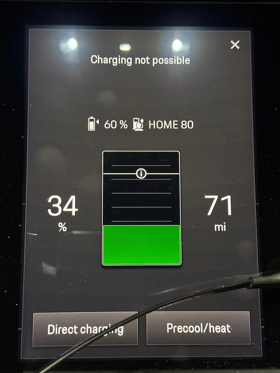

Today I returned to my garage with 41% SOC but 8 hours later my SOC dropped to 34%.
The only thing I noticed was the Direct Charging was in the on position. Is it possible this is the reason my HV battery drained 7% in 8 hours?
I’ve never had my SOC drop by more than 1% over 2-3 weeks let alone over 8 hours.
Any ideas?

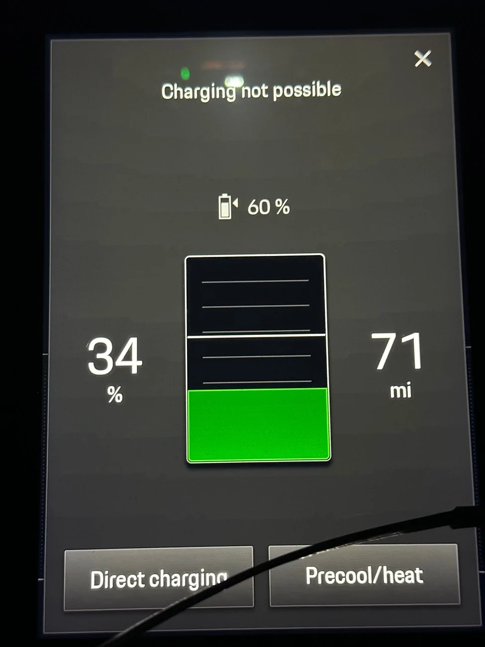

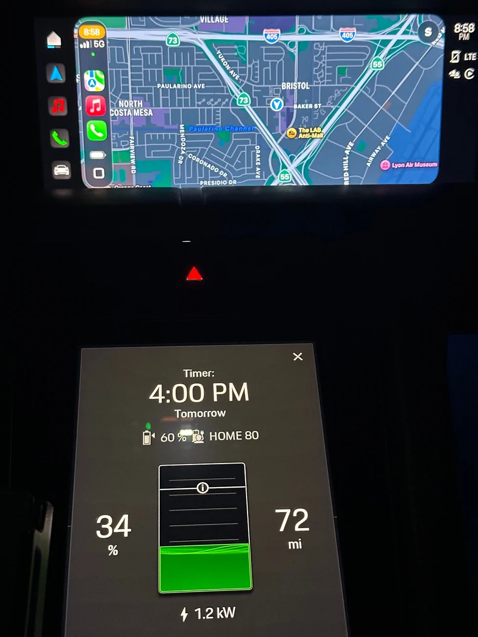

I just started charging again at 9pm but the main screen on the console shows 60% with an arrow next to it with charging set to 80% but the actual SOC is 34% & 71 miles range.
Before I plugged in my Porsche L1 charger (120V AC) is showed “Charging not possible” Once I plugged it in but the charger wasn’t powered on yet at 9pm it showed the charger was plugged in but not charging and once it began charging it still showed 60% with an arrow next to it and set to 80% charging profile with the SOC at 34% with 72 miles range.
Not sure what the 60% means?
Seems like some sort of software error…
Anyone have any ideas?

I was just told the OTA software update which was downloaded just before this happened likely set a minimum charge level of 60% whenever the charging cable is plugged in and there is no charging profile active. They are assuming this is to avoid letting the SOC drop below 50% and risk letting the 13.5V battery drain down & die when in storage for weeks or more.
