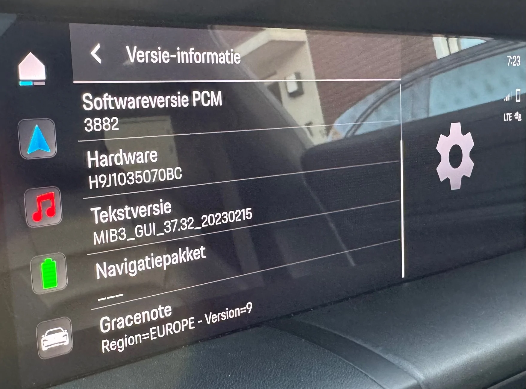

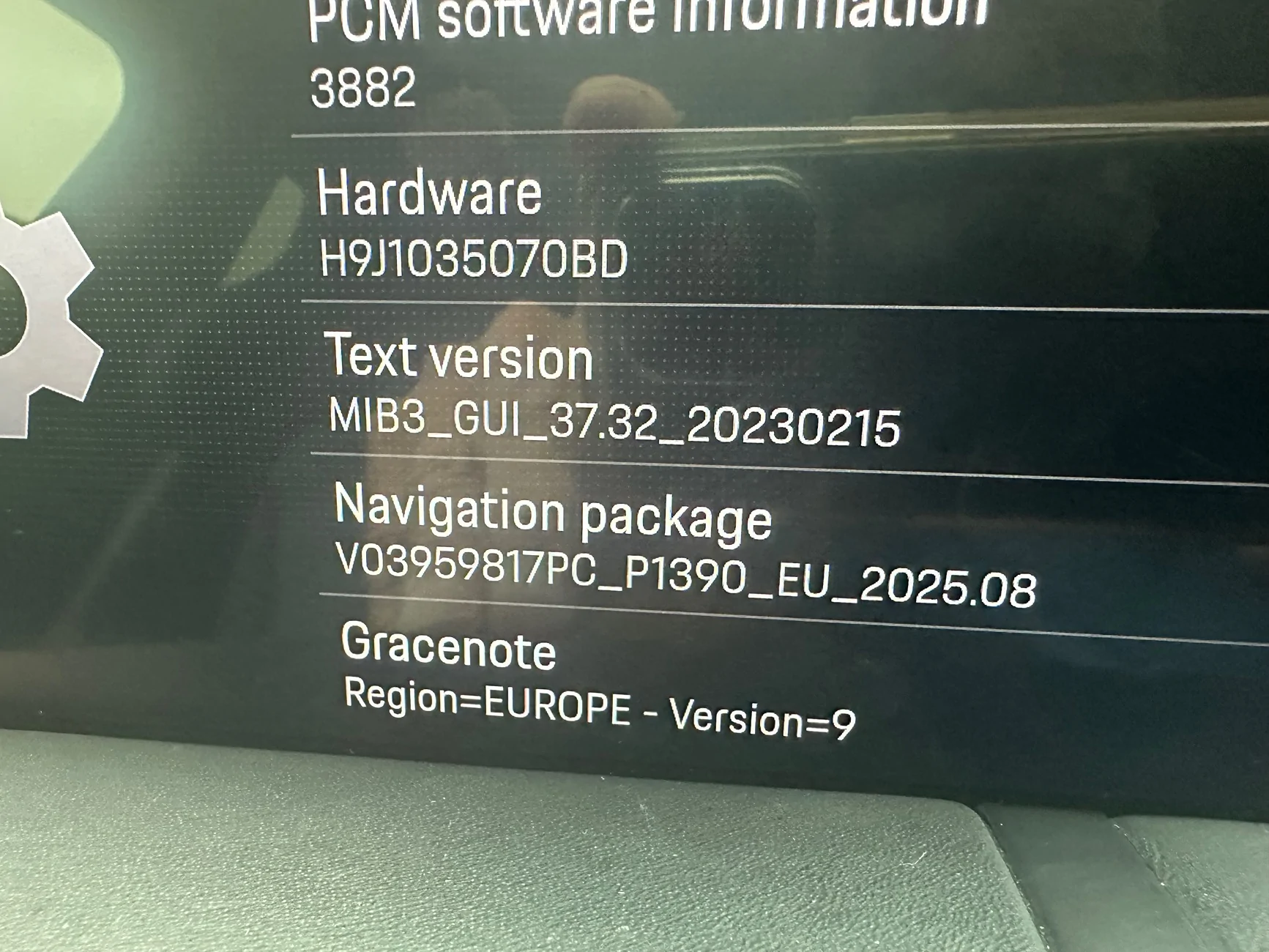

No news yet from the dealer, but I was digging in my current software version for navigation since I can’t remember the last map update. I noticed the navigation pack is empty on the software information page in PCM. Do others with the same issues as described in this thread have the same? If so, my guess is that our navigation pack is corrupt and should be fixed at the dealer?
Porsche Taycan EU/UK: Ongoing navigation issues [Solved with PCM v3892] IMG_0493
I have the version number V03959817PV_P1390_EU_2025.08 in that field and as of a few days ago my navigation acted the same way. I did actually get a few updates since this started but none of them seem to have fixed the issue.
Just checked and mine shows correctly as shown but still getting turns particularly at roundabouts hanging.
Porsche Taycan EU/UK: Ongoing navigation issues [Solved with PCM v3892] IMG_4032
