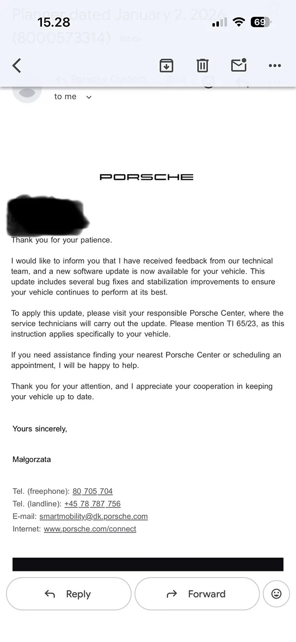

I called Porsche this morning and after some investigation on their side they did conclude that I needed a software update at the Porsche dealership (see photo). My local Porsche dealership did say that they have had luck with this update solving for the navigation issues.
Porsche Taycan EU/UK: Ongoing navigation issues [Solved with PCM v3892] IMG_2423
Hope this can help others who are in the same situation.

Can you report back when you have the update? I find it strange it is vehicle specific.

My appointment is on 12-JAN. Will be sure to report back afterwards. Lets see if this solves anything…
