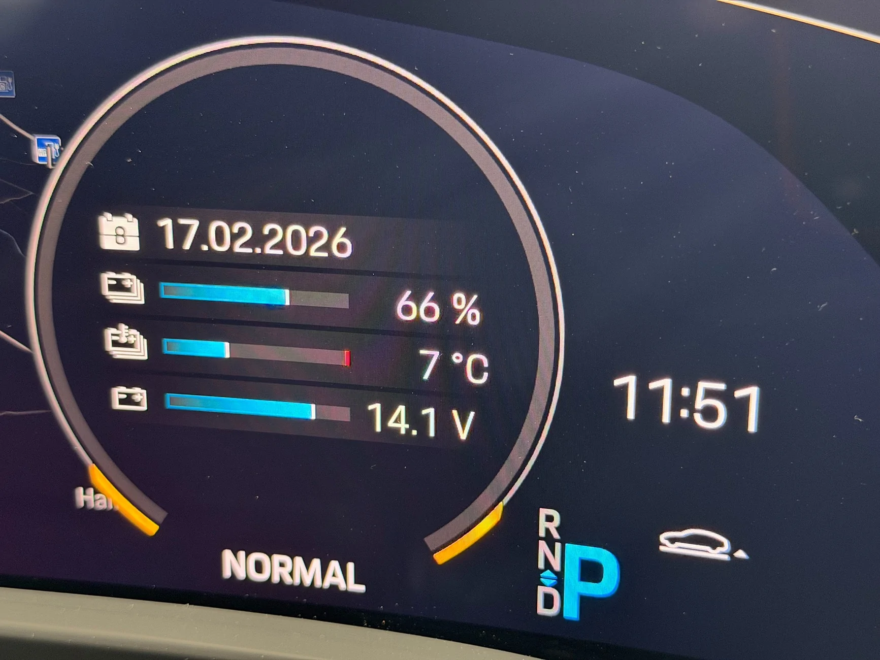

Don't use Porsche charging planner, then you have less failure with the PCM. Use Google Maps or whatever for routing. 30 minutes before you have to charge change to Sport mode or drive a little bit faster (possible in germany) and your battery will have the right temperature 27-35 degrees). I always know the battery temperature due to my tube content (photo). Or start the porsche navigation 30 minutes before you arrive at the charging point.

Let me know how driving in sports mode works at -10 and how long it takes to reach 35; and how much battery it uses to achieve that ;)
Sport plus mode is hardly useable for heating the battery for charging in cold temps. In most use cases, it’s useful in summer while already at the charger, to force the fans on to batter handle temp
