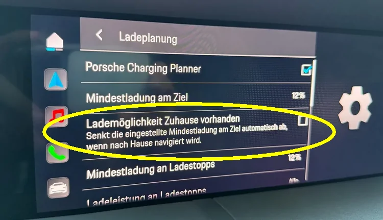

Since yesterday, I have had the WTG1 update installed on my car. However, compared to others, I notice that this option is missing:
In English, it likely reads: Home charging facility available.
Could colleagues who have already received the WTG1 update please check whether this item is present on your systems?
Thanks in advance,
Uli
I had WTG1 applied yesterday.
Home charging available is definitely still there.

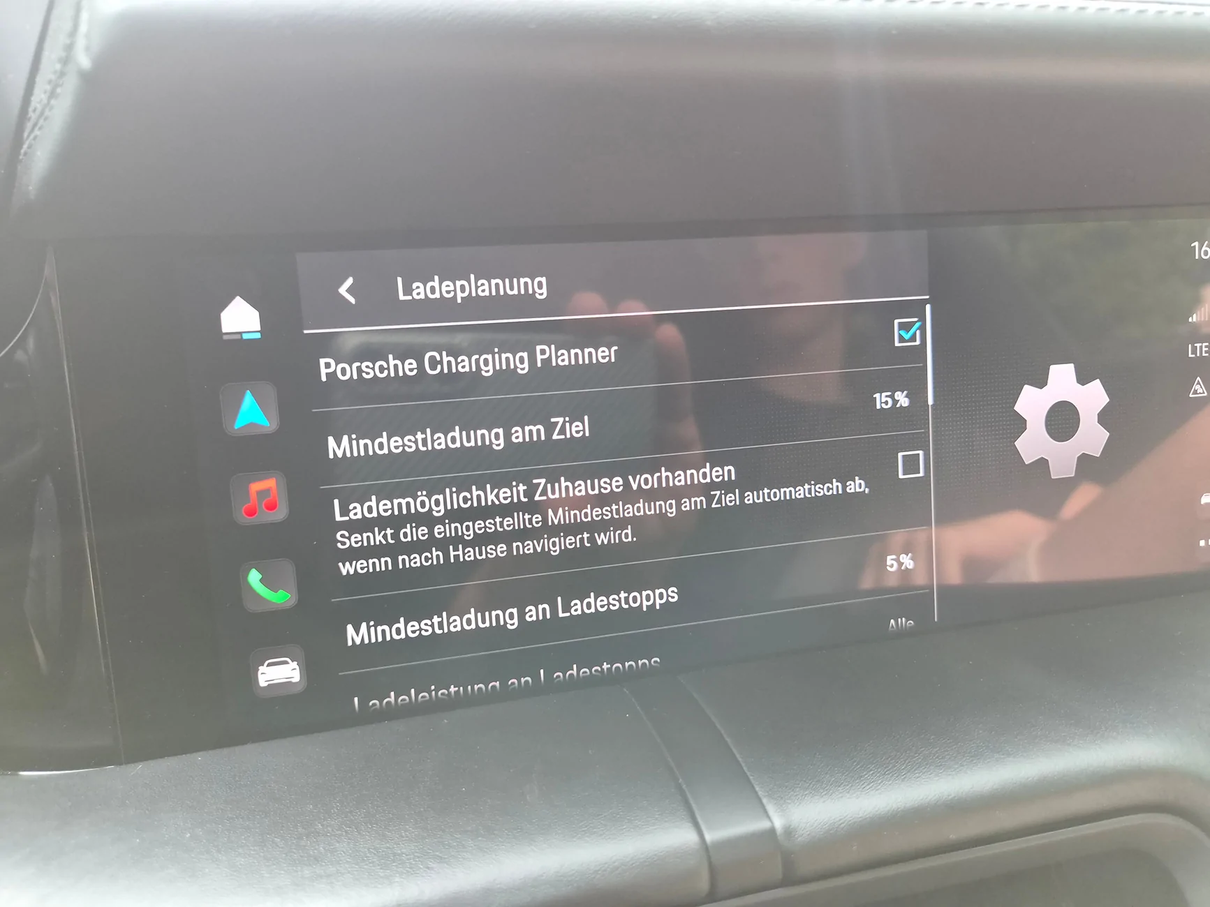

Yesterday, I experimented again with various minimum SoC settings. The menu option simply didn't appear—not even after a reboot.
Then, a few hours later, I drove out to do some shopping. On the way back, just for fun, I checked again. Suddenly, the entry was there:
Porsche Taycan EU/UK: Ongoing navigation issues 20260530_162854
Here is my theory: after the WTG1 update, no home address was specified. I had set this yesterday. Perhaps this is required to unlock that particular setting; otherwise, the Charging Planner wouldn't know for which destination it should lower the minimum charge level.
So—all's good now!
