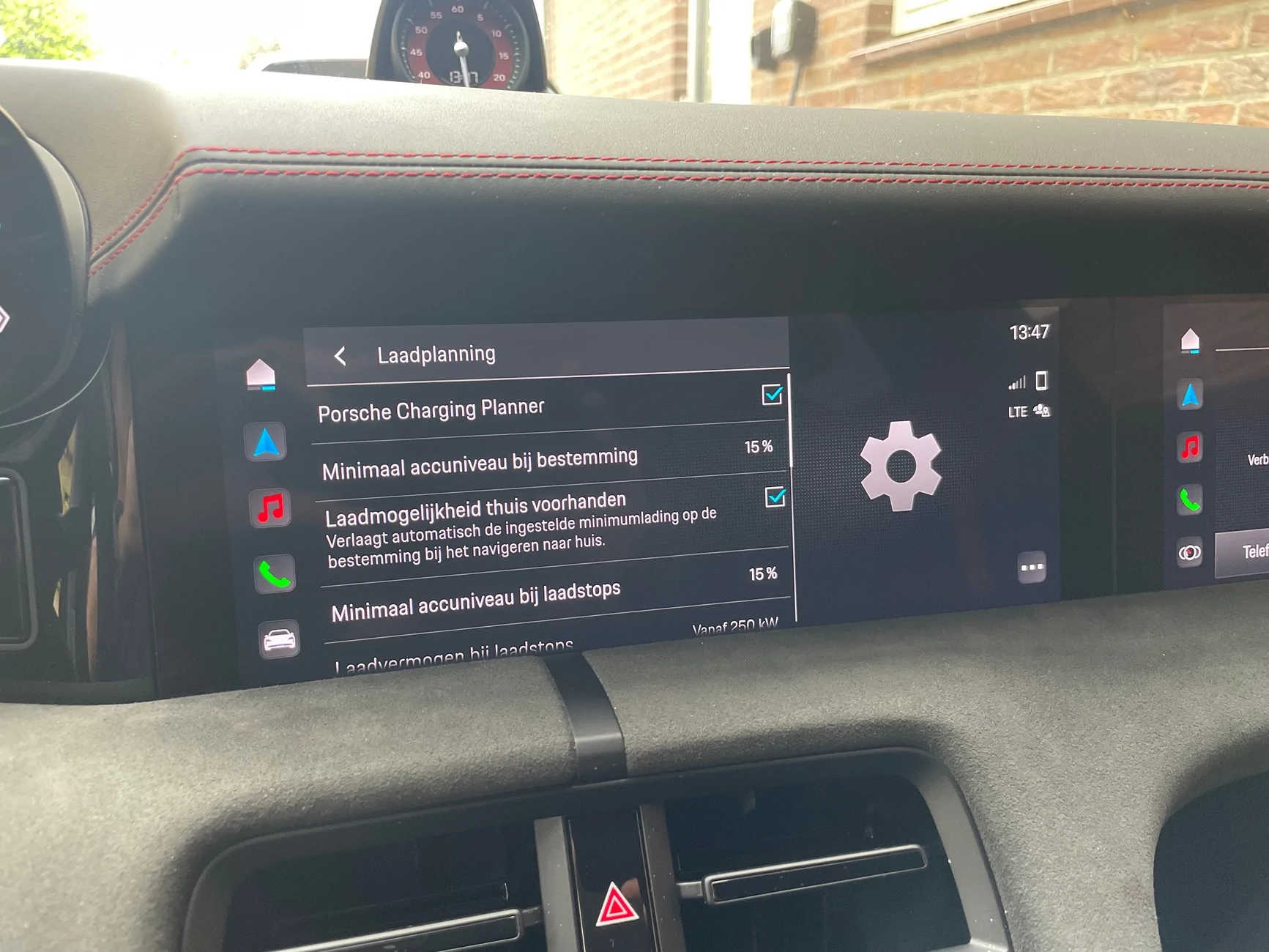

Since yesterday, I have had the WTG1 update installed on my car. However, compared to others, I notice that this option is missing:
Porsche Taycan EU/UK: Ongoing navigation issues [Solved with PCM v3892] Screenshot 2026-05-29 090547
In English, it likely reads: Home charging facility available.
Could colleagues who have already received the WTG1 update please check whether this item is present on your systems?
Thanks in advance,
Uli

It is easy to please Taycan owners these days after waiting for months! Seriously hope they can with a BIG f update any time soon.....
:CWL:
I was surprised to find it wasn’t already as Mercedes have had this in the app for 7 years!
