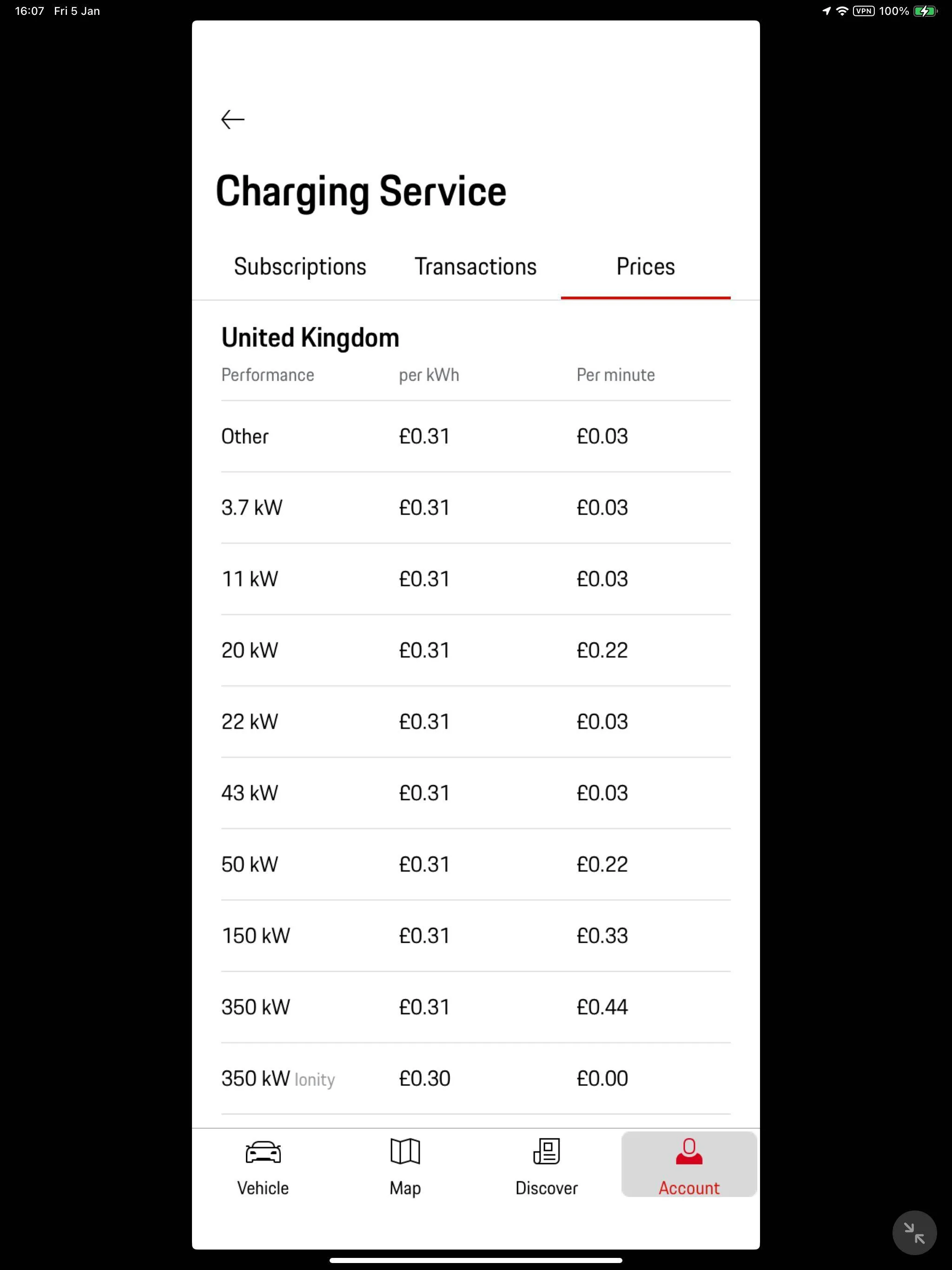

You can find the charging costs under account/ Charging Services in the MyPorsche app. And yes both Tesla and Ionity with Porsche Charging service charge only for kWh. Did your dealer not inform you about this
I only charged my car once at Porsche showroom, and it cost me £10.50 for 11Kwh for 16min. I sent couple of emails and answer was there is service charges. Attached is my itemised invoice. I can see on Ionity there is not service charge, so Thanks I will go and try that.
Porsche Taycan Fuel vs Electron Screenshot 2024-01-05 153017

If you are using Porsche Charging service, with your card or the app, it is transparent. I have no idea about charging rates outside of these, but any other roaming card can be very expensive.. `Apart from Ionity you will be charged for the kWh plus a time based fee. The station will most likely tell you both kWh and time when you stop charging.

Does Ionity only charge 30P and not any service charges? if they don't then its cheap for on the go charge.
My analysis are purely to understand and shed some light on this, I do have solar energy at work so in summer I probably charge for free.
This was last week 15 euro for 45 kWh in 12 minutes with Porsche charging service. Same day but at a slower not Ionity 150 kW charger only delivering 75 kw needing 41 minutes and had an additional price per minute cost more than double for 16 kWh more charge.

during a recent trip to London, I paid only 30p/kWh at Ionity fast charging with the Porsche Charging card, without any issue nor delay.
makes it a lot cheaper than with my `Porsche 911 on unleaded!
