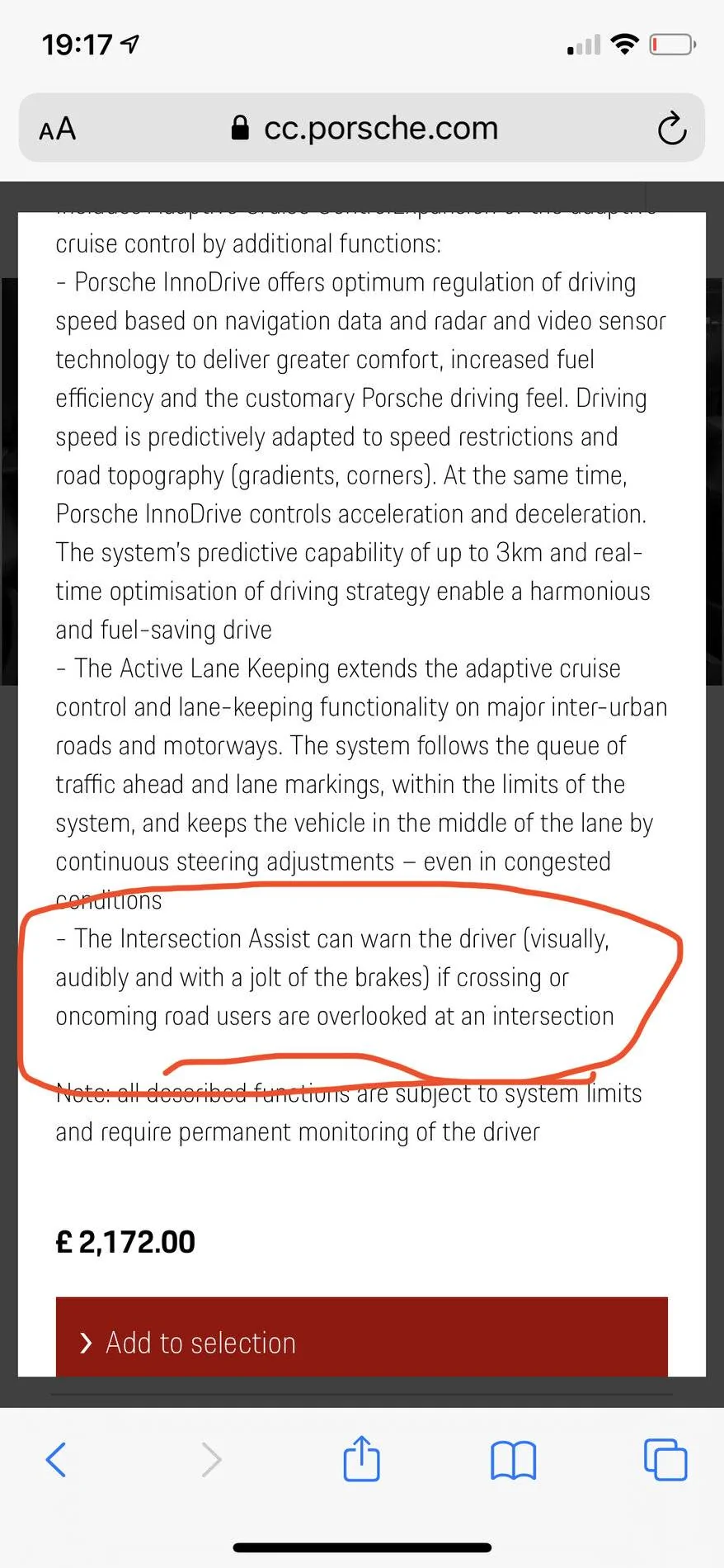

Ok ask them whether you get crossing assitance with the FOD Version.
you will not, you will only have this with the factory and there is no way to install it ( software and hardware) after the car was produced.
If they confirm, let them write it down. Will be a nice apology when you can‘t.

Sorry it is called intersection assist. You only get it from factory not by FOD because some sensors are missing.

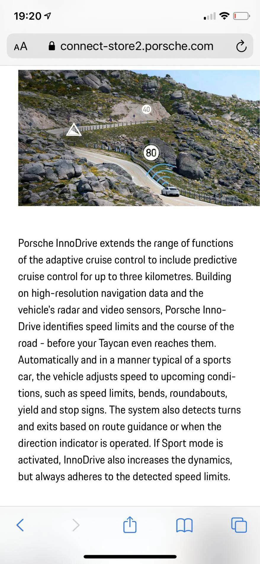

I ordered the Innodrive by FOD on my 2021 Taycan Turbo. After 2 weeks and lots of trials it still does not work. In de beginning got the message: “Updates Porsche InnoDrive FOD” and instructions how to activate (see pciture). Followed the instructions but did not work. Now after some time the message with Updates does not appear any more. My dealer is now working on it.
The strange thing is that in my Porsche it is indicated the service is not activated yet and the purchase is not yet deducted from my credit card.
