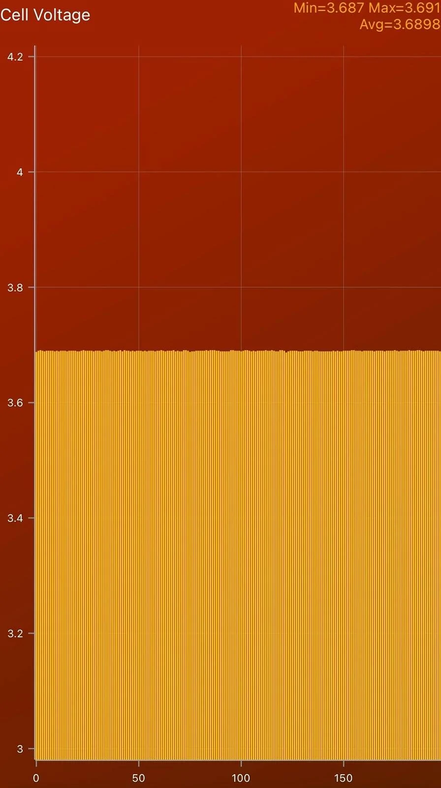

So I followed the procedure (drain to 15%, leave overnight, AC charge to 100%) then went for a spin to bring it back down nearer 85%.
Meanwhile I ordered a Viecar ELM327 v2.2 Bluetooth 4.0 OBD-II dongle and installed Car Scanner.
I'm not claiming correlation between following the process and my results as I didn't take data beforehand, but I do appear to have a nice consistent voltage across all cells (this at ~50% SoC).
SoH shows as 94.361% - vehicle has over 8,000 miles. Interestingly, it shows a lower number of launches than I expected. I think it must be "a handful" by now, but Car Scanner only logs only 2.

Given that there was a TSB indicating a much lower SoC to initiate the rebalance cycle to accurately measure SoH, is 15% SoC a true threshold or does rebalancing still happen at 20%, 25%?
Put more specifically, is the 'highest lower threshold' for SoC at which rebalancing occurs if left overnight known?
OR does rebalancing always occur, just to a lesser extent depending on the starting low point?
