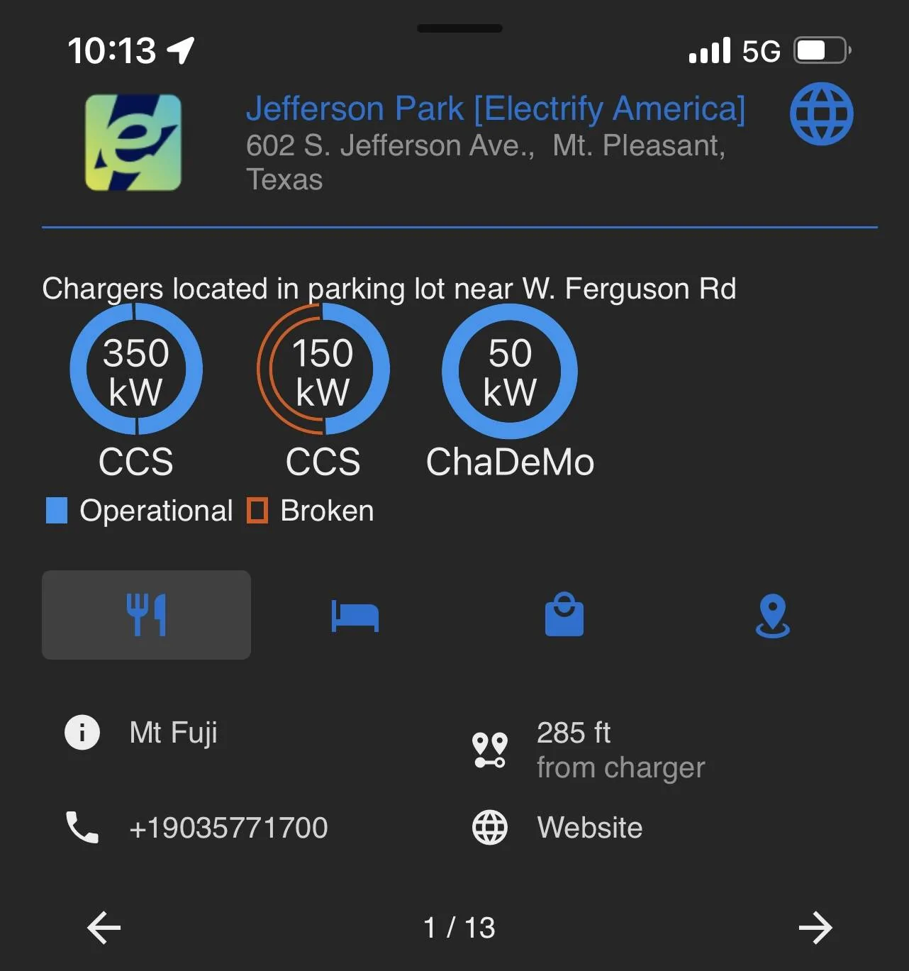

Sometimes a different cord/plug on the same stall fixes the speed. I had two stops with a bad cord pushing 5kw. Switching cords then gave me 265+kw. On the EA units there’s a telltale sound of a compressor that I’m guessing chills the coolant within the cord. The second time it happened, I didn’t hear that compressor kick on and knew right away speed would be limited.
747
4,475
3,651
RE: different cords on EA charging stations.
I spoke to EA rep about the status on a particular charging station that MyPorsche app was reporting. The status on MyPorsche was the station was "occupied for 4+ hours, etc." (I was at home wanting to learn how to interpret MyPorsche's EA status info.)
She looked up her status on the station and said, that station is available, but one plug/cord is not working.​
I asked, so if you use the other plug, the station will charge?
She said, yes.​
I asked, if I drive up to this station, will I see that the station console shows there is a problem with one plug?
She said, no, the station console will show it is available for charging..​
I asked, how would I know that one plug is not working?
She said, you will get an error message after you plug in. But if you are able to use the other plug, it will work.​
She said if you sign up and use the EA charging app, it will show you the status of the individual plugs on each station.
I looked up the station on the EA app, and it showed one plug was not available, the other one was available.
She said, yes.​
If you sign up for ABRP premium they source some of this info into the charger details. In the case of the throttled flow on the 350kw units I tried, those chargers showed operational in the app even though they were not functioning properly. It’s worth trying the opposite cord if your first try isn’t flowing quickly.
Here’s an example of a half broken charger in ABRP:
