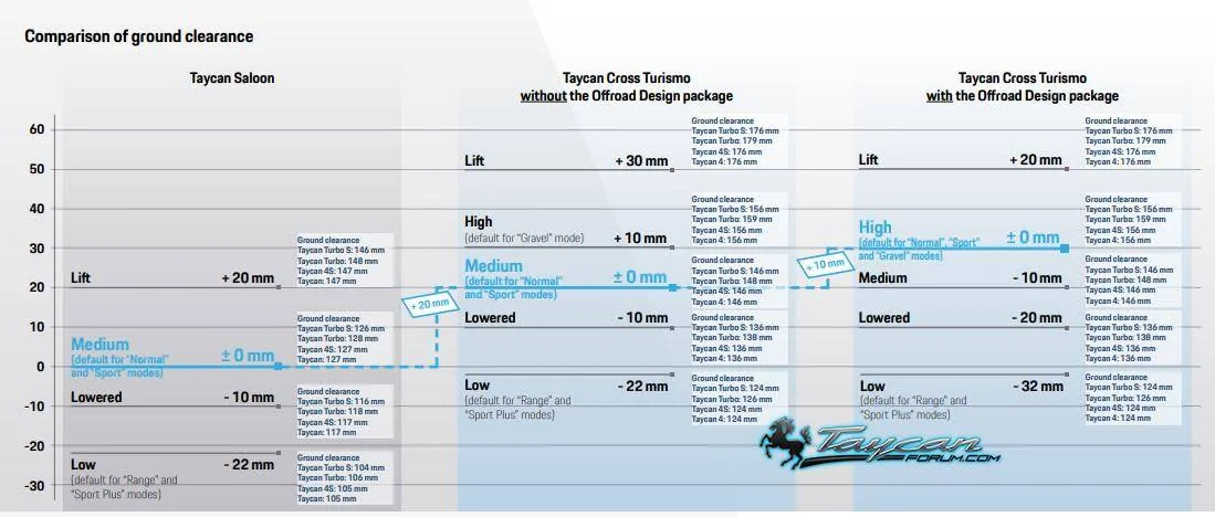

Looking at the attached (which I have pinches from another thread on here); Taycan has 4x height settings compared to 5x on CT.
Does anyone know for certain if the GTS ST has 4x or 5x height settings?
Thank you!

It will most likely be the same as the existing saloon non Cross Turismo models so don't expect another height adjustment.
