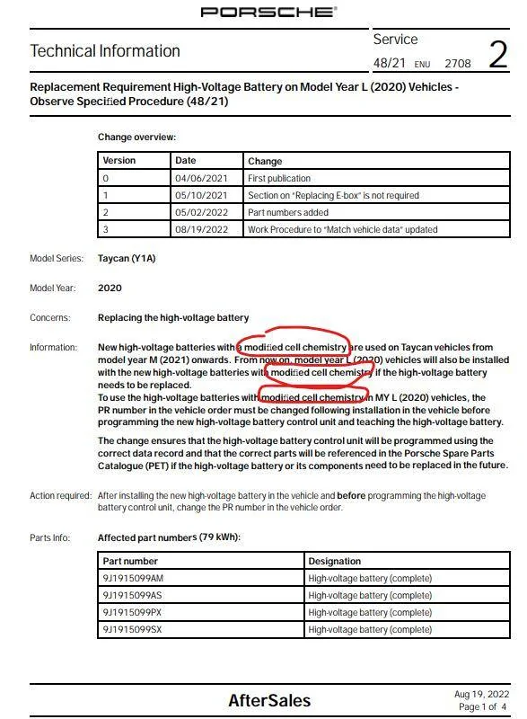

Some cell technology changes too from original 2020 models. Had this saved somewhere on my files though.
Porsche Taycan GTS, Turbo, Turbo S acceleration IMG_3147
This is irrelevant to range and to the fault in the batteries with the tab attachment, which is causing the issues. That only got fixed late 2023.

1. Was range improved? Yes, on all the cars incl. the 2020, as it was a software update
2. Was the battery fixed? No, only for late MY2024. The 2021 or 2022 is not any better, as the same defect is present. ARB6 recall even includes early MY2024 VINs. Change of chemistry just means cell balancing requirements changed, so they could not mix and match the different modules, and during battery replacement they needed to reprogram the BMS, which is completely normal, but did not result in any improvements.
