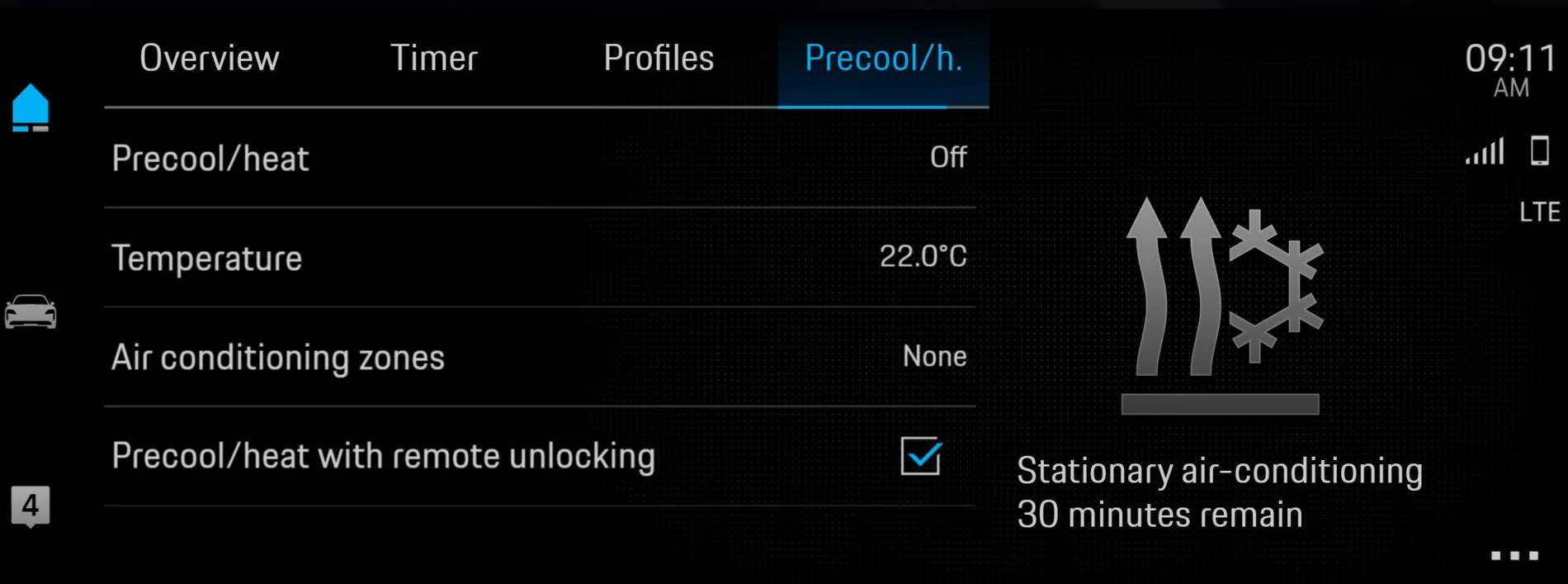

Still learning the features of my MY22 Taycan 4 CT after taking delivery on 13-Nov. I tried the heated steering feature (on standard wheel) this past weekend. I turned it off and the next few times I drove the car the heated steering wheel was on at start up. Is there a setting that controls this behavior? I would prefer to turn the heat on manually when I want this feature.

Check that you don't have the Pre-heat / Pre-cool enabled in the PCM which activates when you unlock and open the driver's door. This will turn on the heated seats, wheel and climate settings.
PCM - Charge - Precool/h.
