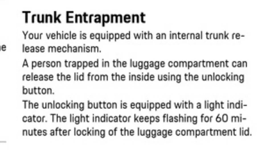

From the US manual, haven’t got my car yet so can’t confirm
Presumably that requires power to be available- I've not come across any taycan-specific instructions of how to release the latch mechanically in case of the electronic mechanism failing, hopefully there's a trim panel that can be removed to grant access to the cable or directly to the latch.

Edit: just seen you fixed it
This seems to be a U.S.-centric thing whereby cars have to have a way to open the boot from inside the car by law. I don't think such a regulation applies for European spec cars.
Yeah, we don't tend to stuck innocent people into trunks over here. At least not live ones... 😅
