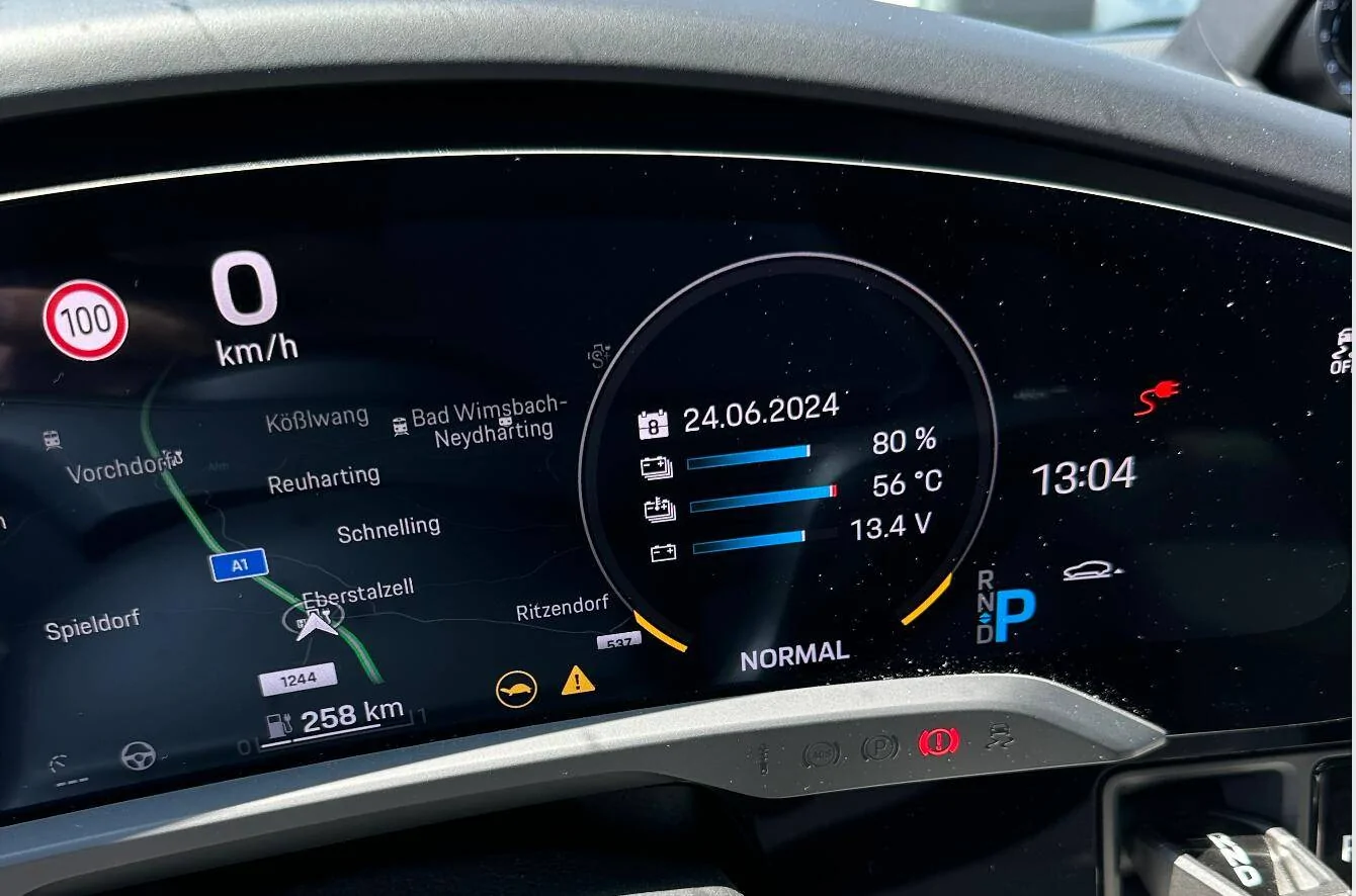

friends, here comes the situation:
Scenario: -5 Celsius outside, heading to Porsche Supercharger (up to 300kw I believe). Nav set, battery pre-heating. Arrived at 32 Celsius in the battery pack, 20% SoC. Started charging at 160kw/h, then dropped to 120kw/h upon reaching 80%. The battery temperature ended up as seen in the picture.
Question: is it normal? The fans were audible, snow/slush was covering the wheel arches (maybe some airflow restrictions?). Did not climb further, cooled to 31 Celsius quickly after disconnecting and driving a bit.
normal for dc charging

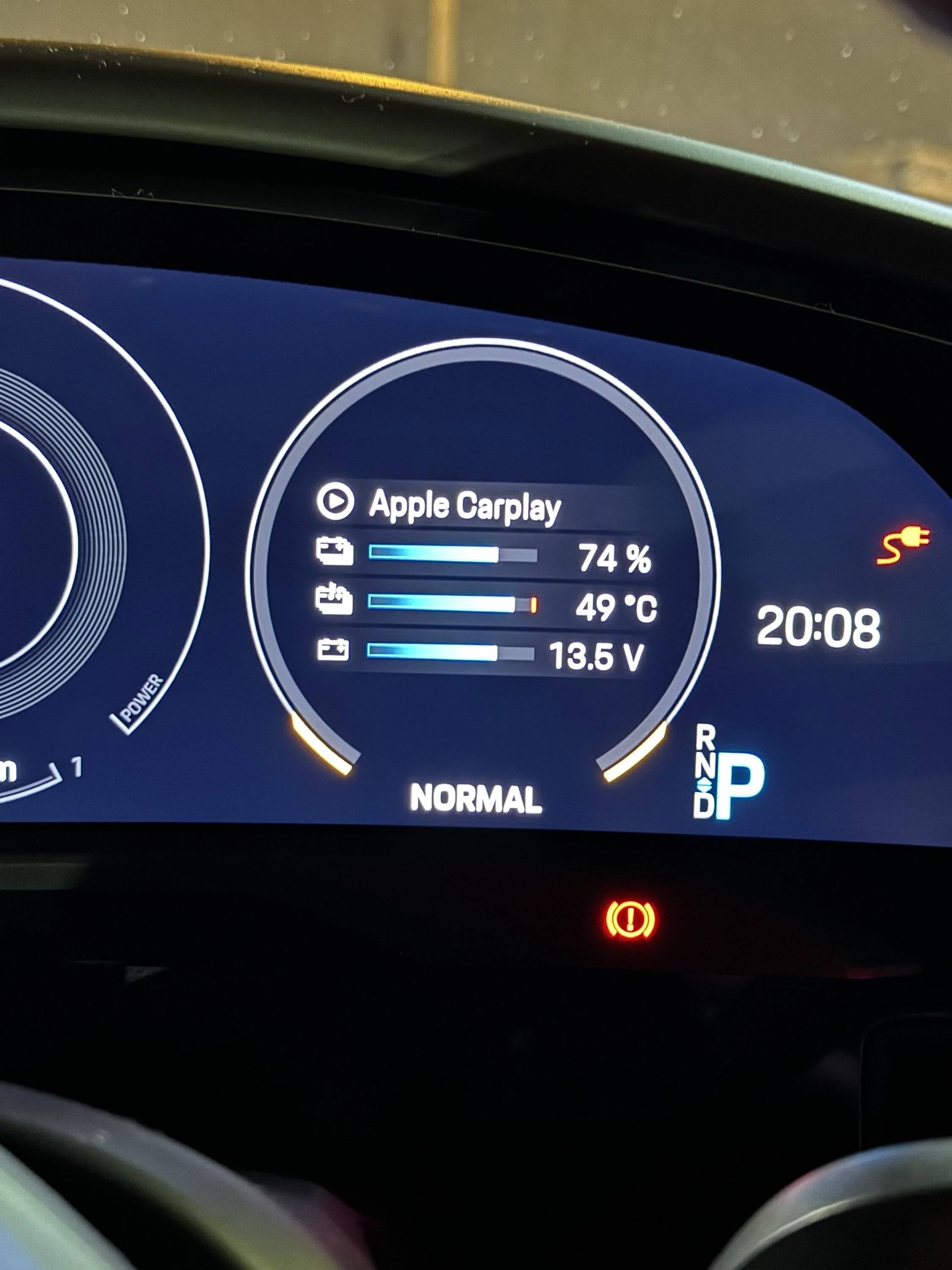

While charging at 300kw stations this turtle icon appeared two times and battery temp got really high.
Is it normal or my dealer didn't bleed out air properly when they replaced the cooling fans and heater?

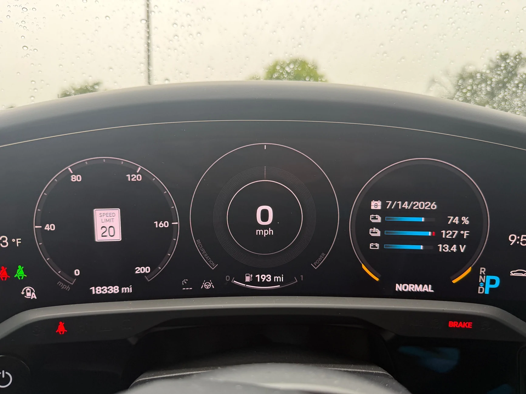

Just hit this max temperature on a rainy morning in Austin. This is the highest I’ve seen it.
