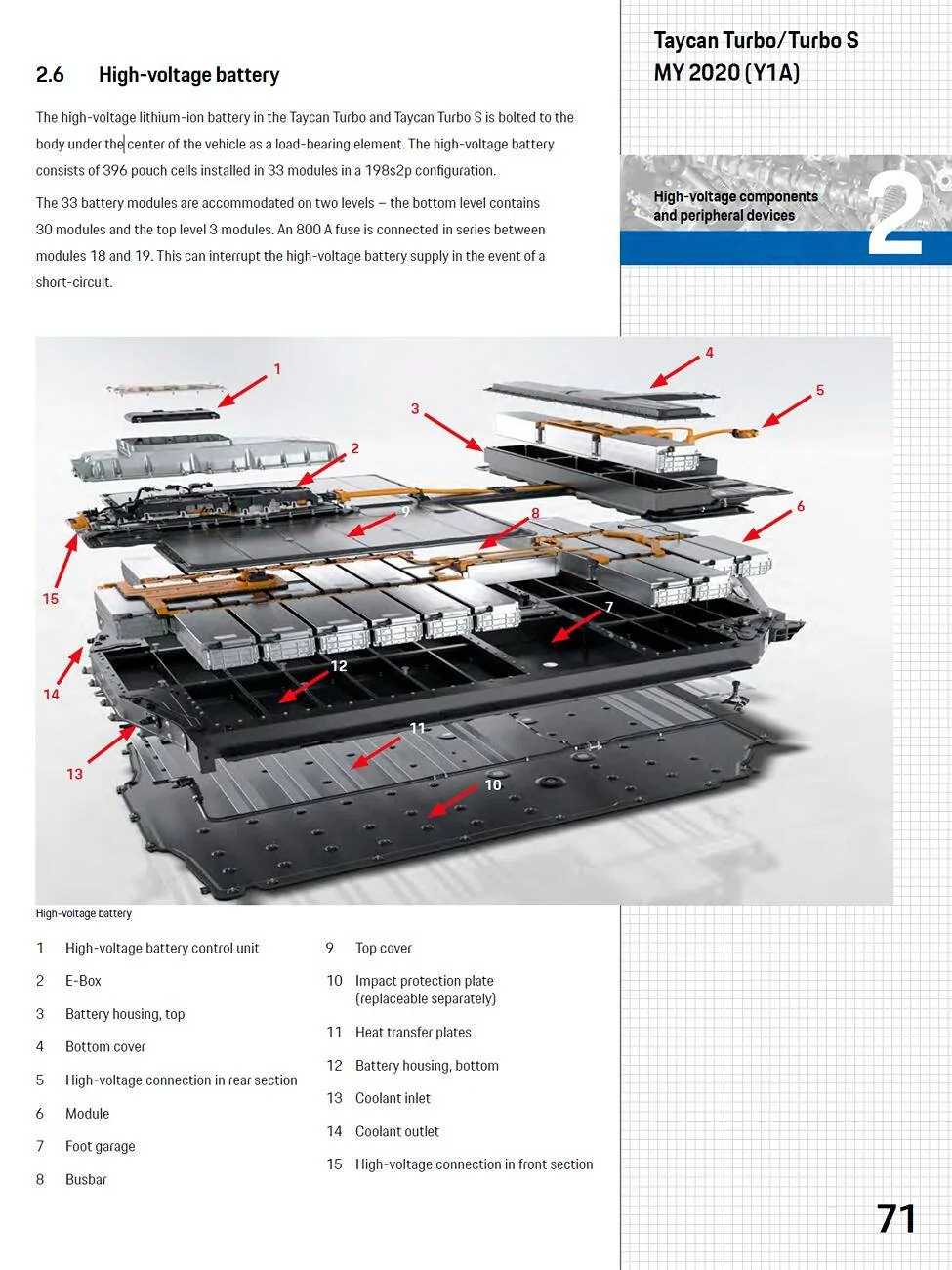

I’ve seen Porsche publications refer to Battery Modules and Cell Modules, meaning the same part.
I don't doubt that. That is precisely the kind of detail that suggests to me whether the content came from a technical source, or non-technical source. Porsche technical publications clearly distinguish between cells and modules. For example:

Context matters. He said the above right after talking about cell balancing and how they need to be within "about a tenth of a volt". He was in fact referring to cells there, then he said they replace the cells.
