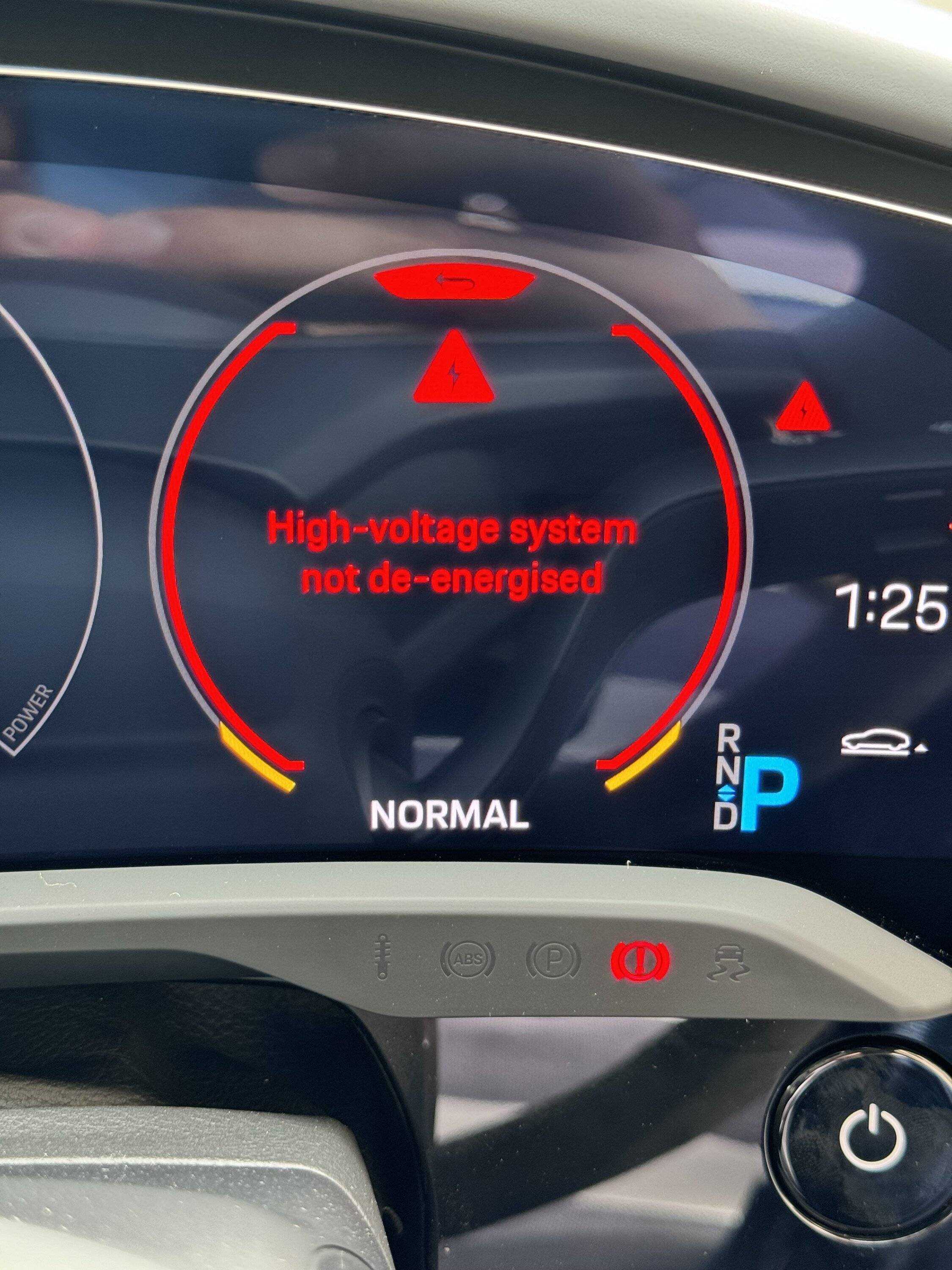

Anyone seen this message on startup and stop?
Brand new (today) MY24 GTS Sport Turismo. Pops with red message on dash at start up. Can simply be dismissed and everything appears to be ok. Possibly left in a workshop mode?

No they haven’t. Ah! Although I have had mine attached to get the SoH. I’ll check tomorrow now I’ve unplugged it.

You were right. That message only appears if you have an OBDII dongle attached.

i just came back from my car with the same error…because of obdlink mx+…

I think that is a normal message that you get when you connect with an OBD tool. Mine does not do this when plugged in, but once I connect with the app this message occurs. If you disconnect the app or unplug the OBD reader, it should disappear!
