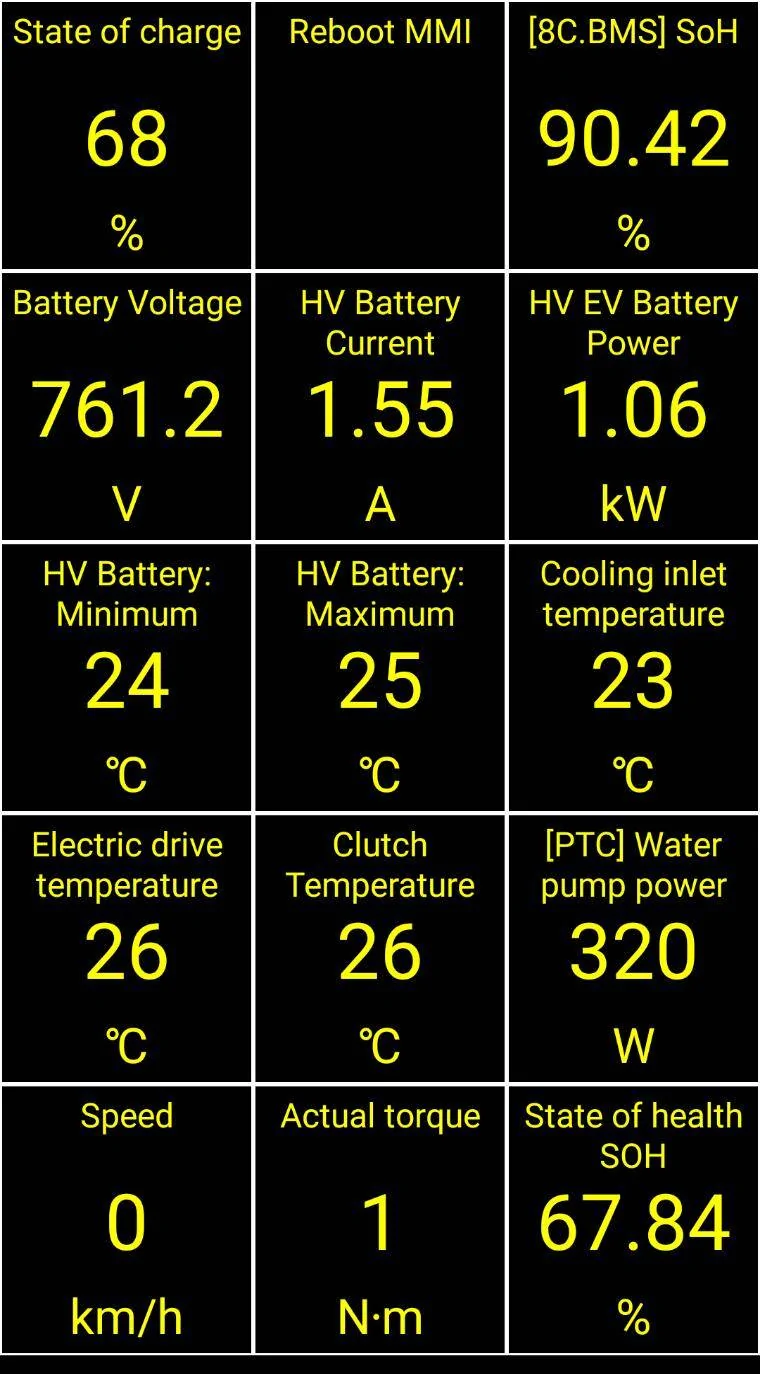

Second, in the dashboard it says "Reboot MMI":
Porsche Taycan Using Car Scanner App to log, understand and diagnose Taycan Screenshot_20220726-153754
But unfortunately that doesn't work.

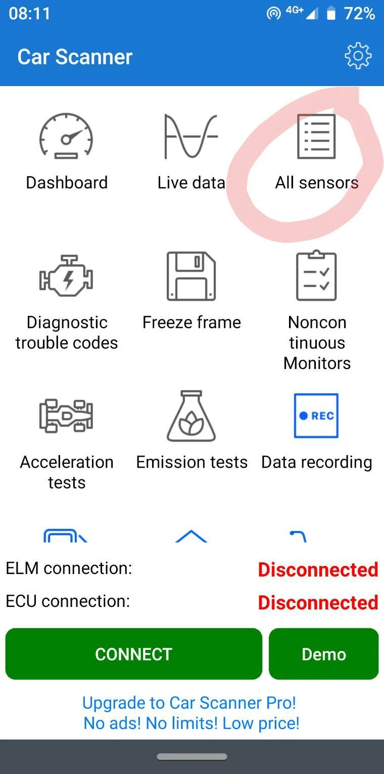

So, I went to "All sensors":
Porsche Taycan Using Car Scanner App to log, understand and diagnose Taycan Screenshot_20220729-081121
And found the [5F.MMI] Reboot Multimedia System.
Pressed it, [Action] Yes.
The PCM rebooted so that command works.
I went back to the dashboard and double tapped on the middle tile again, try to find the [5F.MMI] Reboot Multimedia System in the list to reassign it but it's not even on the list.
That's why it's not working from the dashboard.

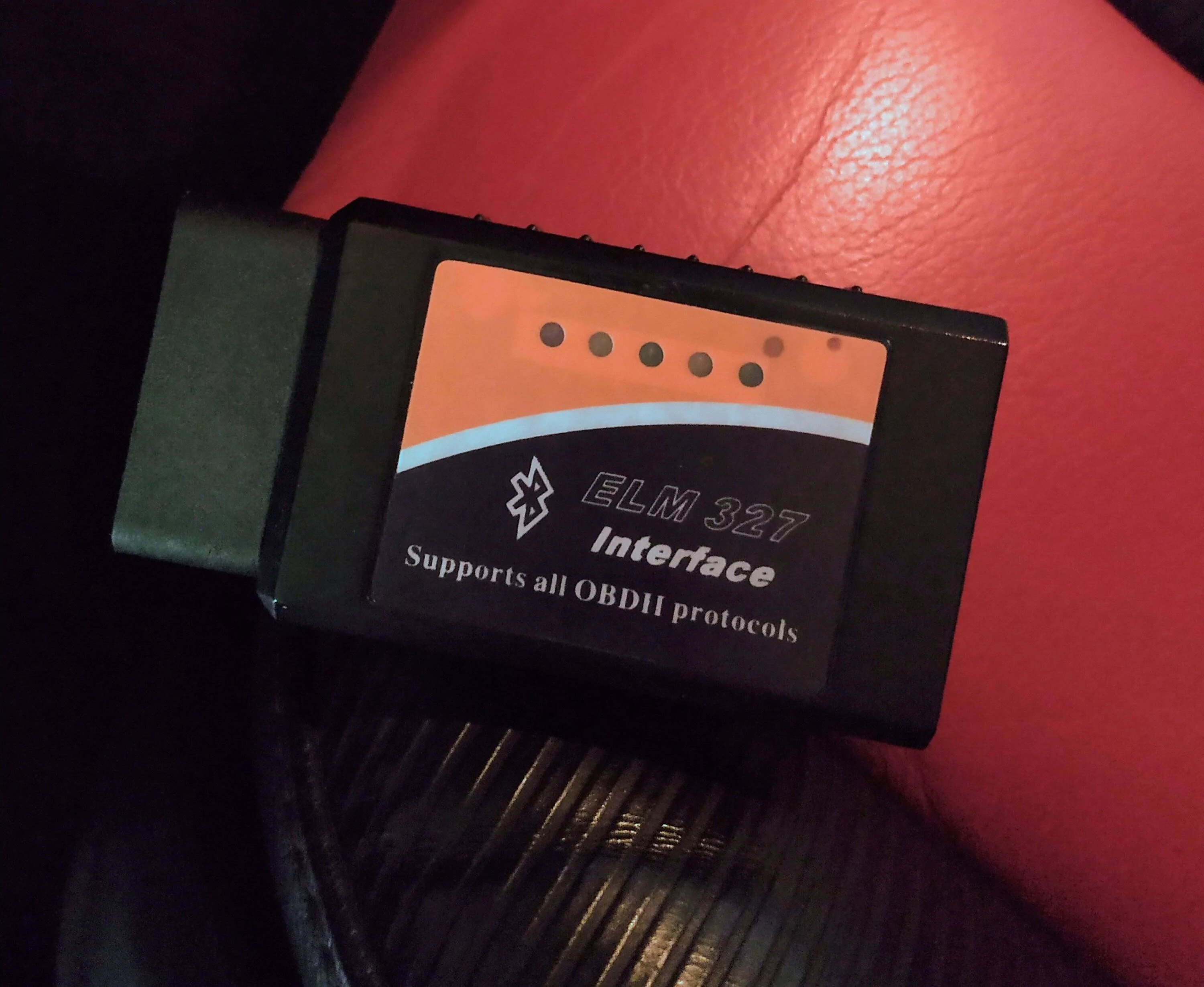

A good OBD dongel is essential.
Please read this: https://www.carscanner.info/choosing-obdii-adapter/
I'm using an old ELM327 adapter, maybe that's the reason the readings aren't accurate and the app is acting wierd.
I've ordered a Vgate iCar Pro to see if that makes a difference.
Will report back (both on 100% charging on the ELM327 and with the new Vgate adapter).

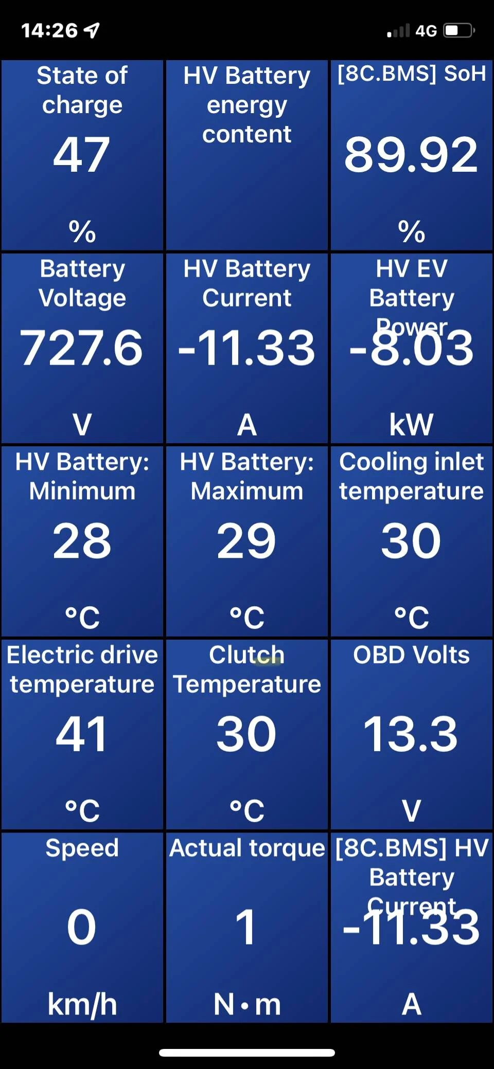

Did you get to test to charge yo 100%? I also have tried the app with a bluetooth OBDII reader. Just below 90% as well? Normally charge to 80 -85% on AC but on road trips I use HPC. Only charged to
100% a few times before long drives.
MY 2020 Turbo.

SoH Just below 90% as well? Normally charge to 80 -85% on AC but on road trips I use HPC. Only charged to
keep in mind, this SoH reading is exactly the same as shown in the PIWIS3 / PTG3 Tester at Porsche but with more decimals and Porsche calls it "fast reading".
Slow and more precise reading would mean to discharge the battery for a certain range of SoC.
I didn't check this procedure yet.
I already have seen 10-15 readings from 88% to 99.2% (new Taycans with 300km!! up to 39000km ) SoH.
Lower readings are usually MJ20 and also seem to correlate with charging by solar AC which can be many sessions because of the 6A cut-off.
The SoH value changes a bit in both directions. Most car's seem to be around 94% and are worse in winter.

I just tried the Vgate iCar Pro but SoH% results are the same.
So my old ELM327 does exactly the same as this new adapter.
Only advantage is that the Vgate is much smaller so I'll leave it in.

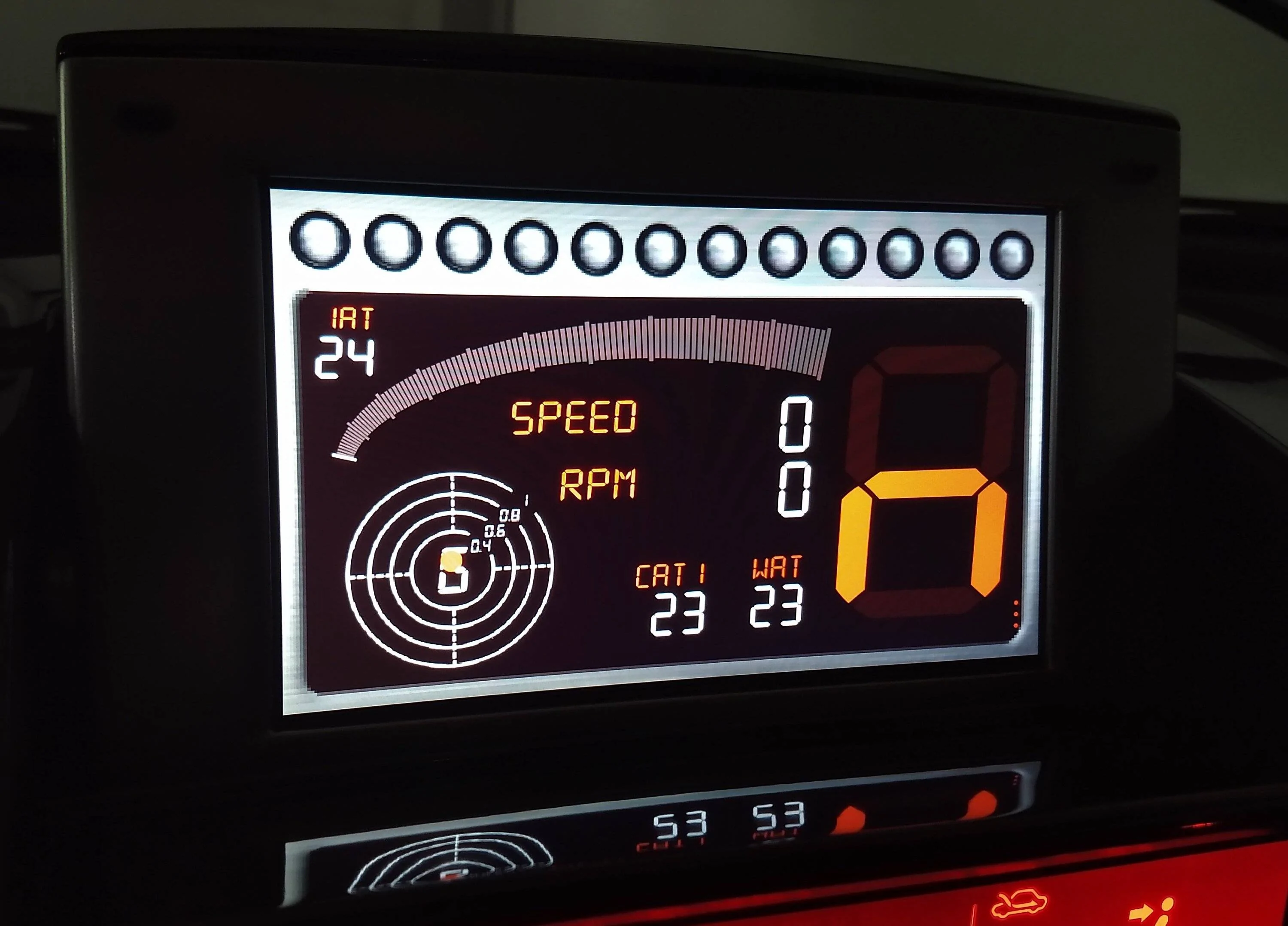

I use the ELM327 for my RX8 which has a built-in tablet with the Torque app and Racing Meter dashboard:
Porsche Taycan Using Car Scanner App to log, understand and diagnose Taycan IMG_20220805_131158461
Porsche Taycan Using Car Scanner App to log, understand and diagnose Taycan IMG_20220805_130959697
Shift lights work, also the s/w gear indicator (it's in neutral now, based on kph/rpm). 🥳

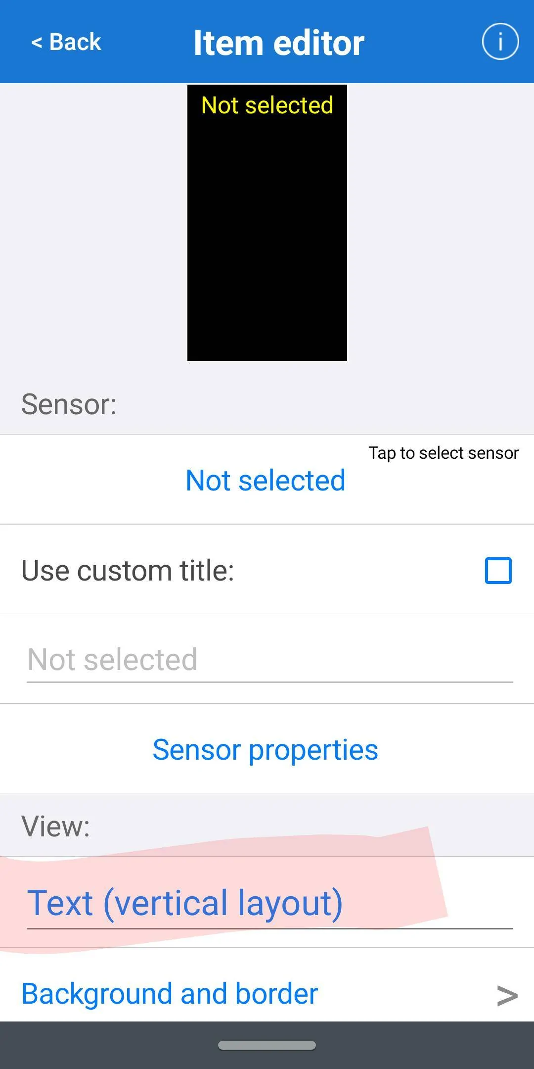

Porsche Taycan Using Car Scanner App to log, understand and diagnose Taycan screenshot_20220726-153754-

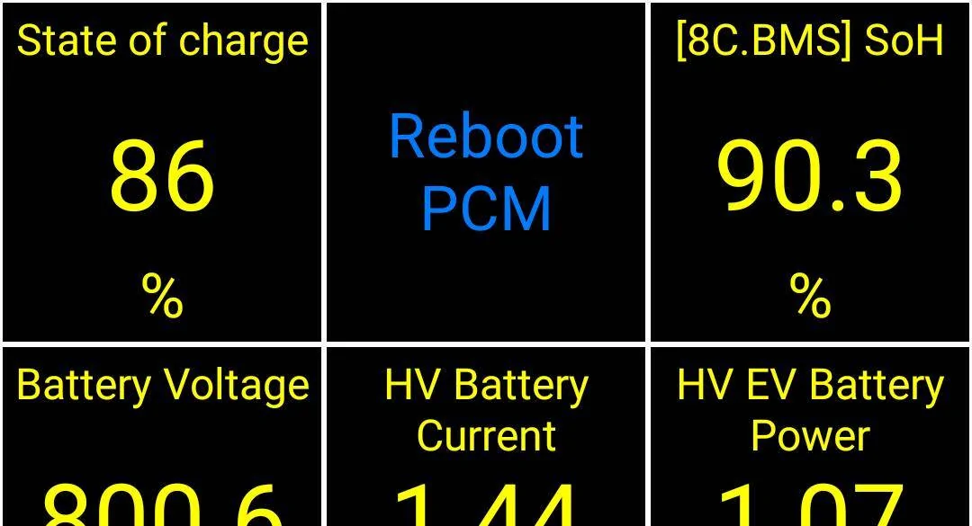

Ok, I fixed it.
First you have to change the "view" (properties) of the tile:
Porsche Taycan Using Car Scanner App to log, understand and diagnose Taycan Screenshot_20220805-120903~2
I changed "Text" into "Action PID" (no wonder I couldn't find it!...).
After that you can select [5F.MMI]Reboot Multimedia System from the list of sensors.
It now looks like this:
Porsche Taycan Using Car Scanner App to log, understand and diagnose Taycan Screenshot_20220806-190832~2
I also changed the text to the correct name.
Now it works from the dashboard page. 👍🏻
