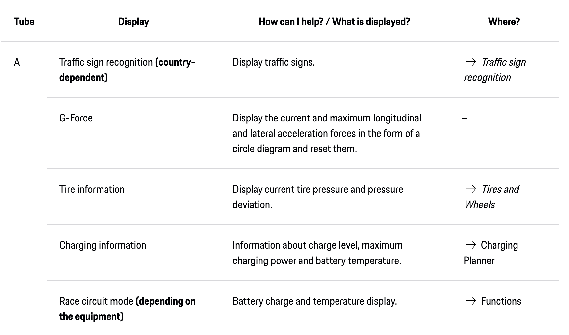

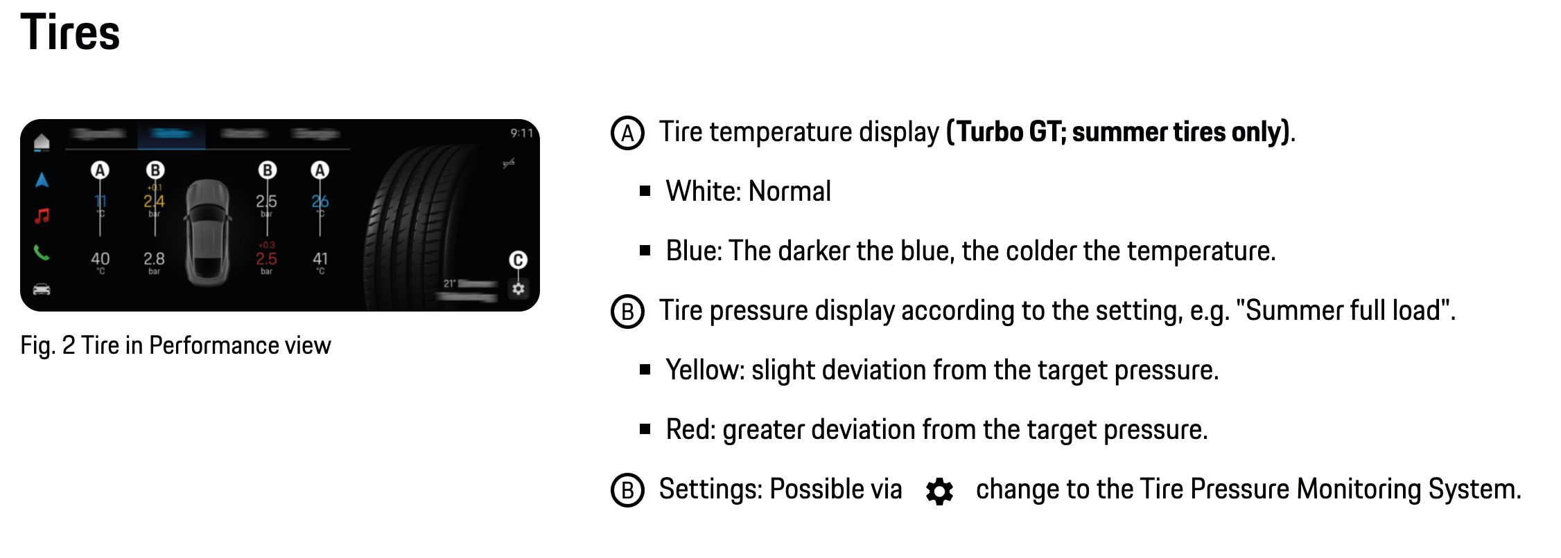

Does your tire pressure also show the tire temperature?

No, just PSI. Is temp monitoring a thing? I suppose it makes sense on track cars.
Yes it shows the Tire Temperature under each Tire pressure reading

Now I need to double check :\
Edit: the manual says pressure and pressure offset. I think the Performance App might have that info, but will need to check that as well.
