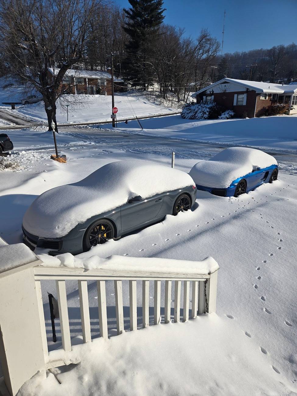

I find my 2020 4S to be a terrific winter car.
it has been 10-15 degrees F around here for the past week, and the car battery does just fine at those temps. The only problem I have had was when it was below zero and I tried to use Sport Plus.
That that case it prompted a "turtle" icon and reduced the driving speed. Returning to Normal solved the problem. The car's weight, 4 wheel drive, RWS, and snow tires make this car perfect for upstate NY....Just use lift when navigating deep snow.

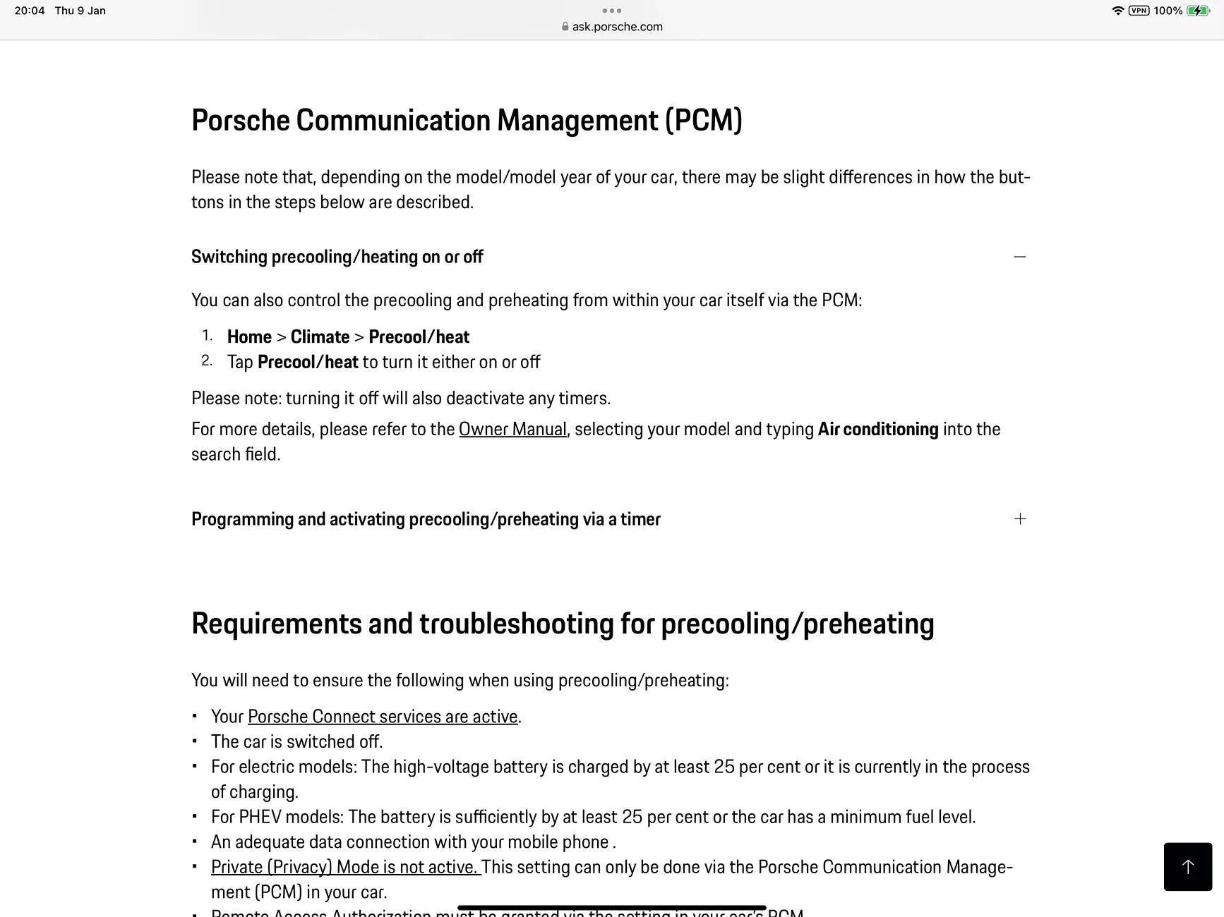

But I can not understand at all why you would have to sit in the car and wait for LTE?
Just press the preheat button in the PCM and go back into your warm house!.

I can understand that it is a pain with shifts like that in temperature, especially in the UK with normal wet and damp weather. It can really freeze up then.
Must admit I didn’t realise that, thank you! That’ll help tomorrow morning because it still won’t connect to LTE

There is an even simpler way if you sit in the car. The lower screen in centre console has a button with Preheat or similar on. Just press that.
Even better, as I understand you have done, is to set a time when the car should be ready in the car.
