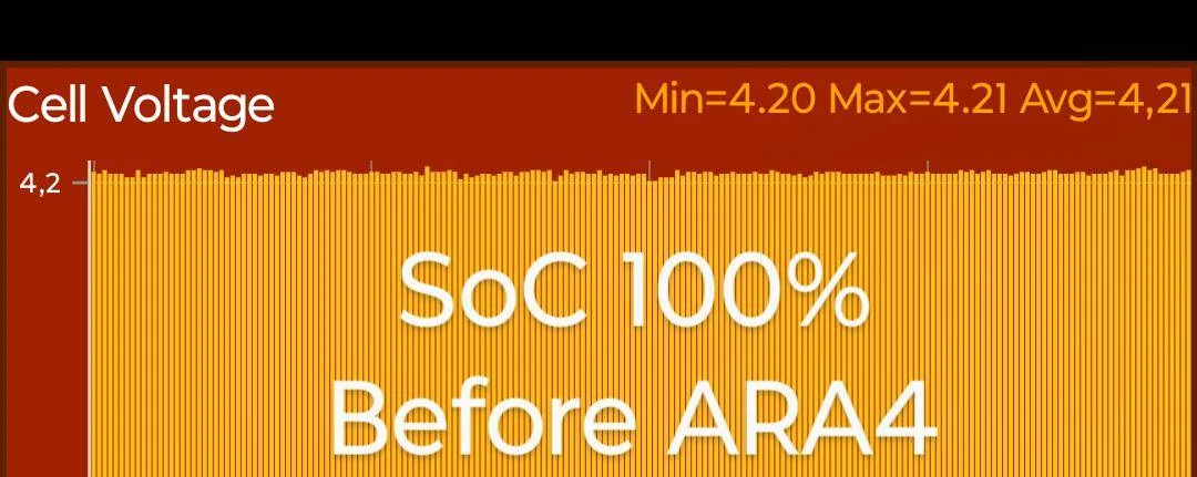

Yes, equal around 4,20 V is always good.
This is mine:
Monday the car goes in for the battery recall ARA4 and brake hoses.
Battery recall?? Did U receive the letter? I haven't seen any (also the Netherlands).
Yours is even above 4.2 cell voltage!

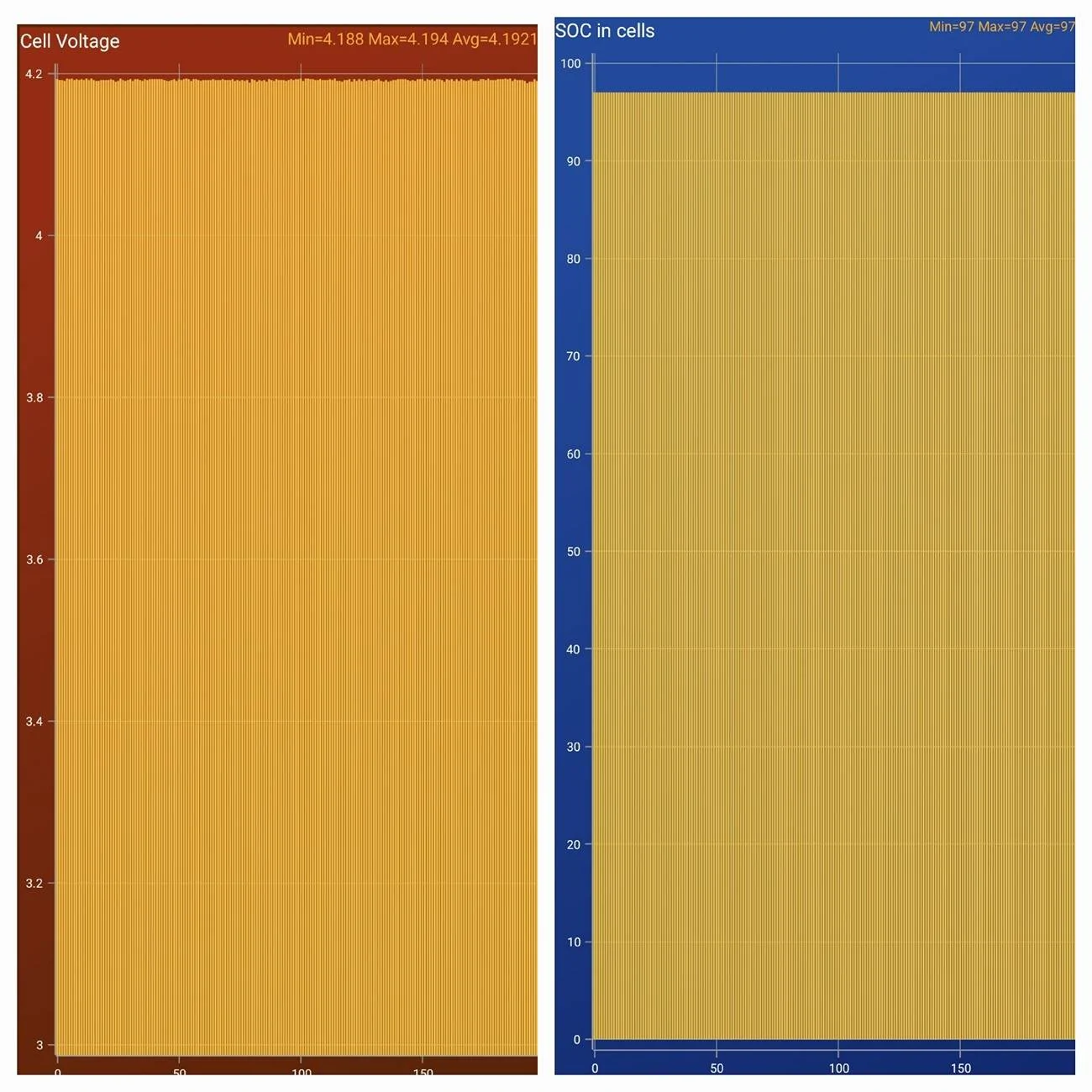

This is interresting. From which SoC was it charged up to 100% SoC?
I might try this as well.
Rik gained SoH from just charging to 100% and letting it sit.
I tried that Out as well with intersting Results:
After letting it sit:
Porsche Taycan How-to Recalibrate your SoH. 1000047039
Porsche Taycan How-to Recalibrate your SoH. 1000047041
Almost charged up, before letting it sit:
Porsche Taycan How-to Recalibrate your SoH. 1000046966
Porsche Taycan How-to Recalibrate your SoH. 1000046964
SoH didn't change, but Battery Energy and SoC did quite a bit. As you can see in the cell voltages the cells are basically at the same level before and after, so there was no power consumption in the 7h I let it sit.

F1Ruaraidh
Ruaraidh
Oct 9, 2024
374
239
It's all about allowing the cells to rebalance and that happens at high SoC not low.

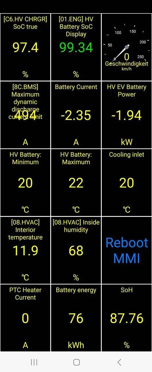

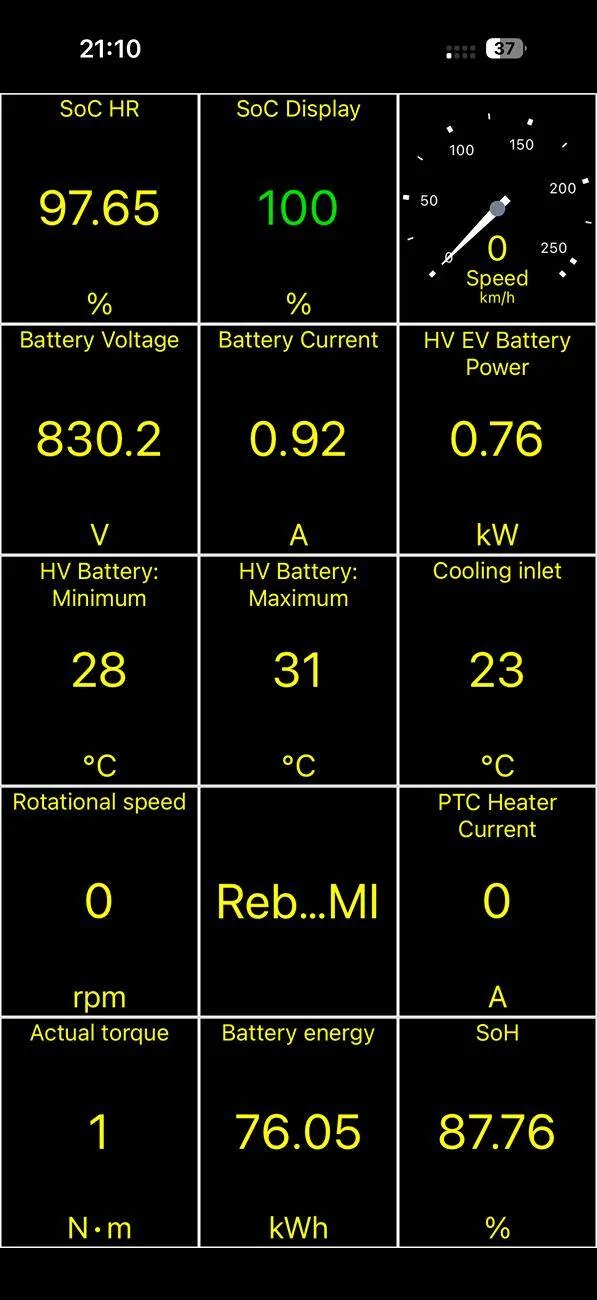

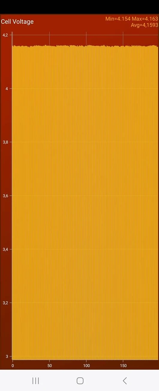

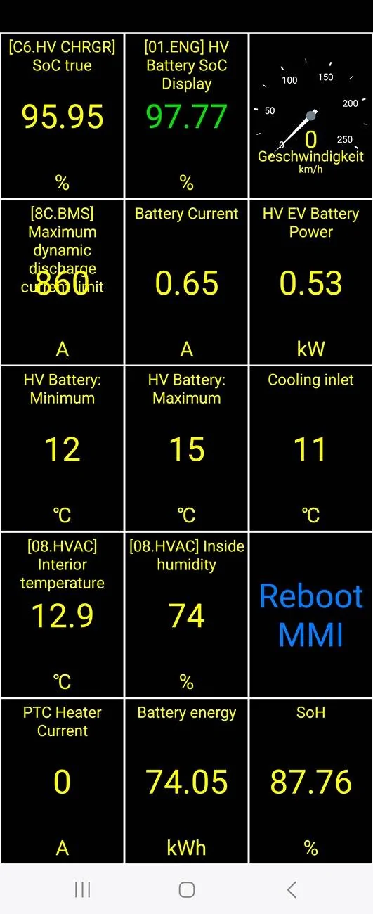

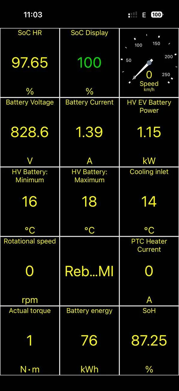

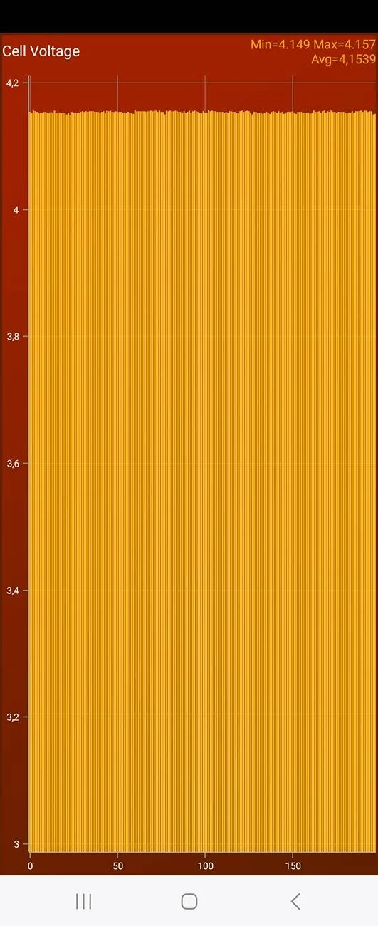

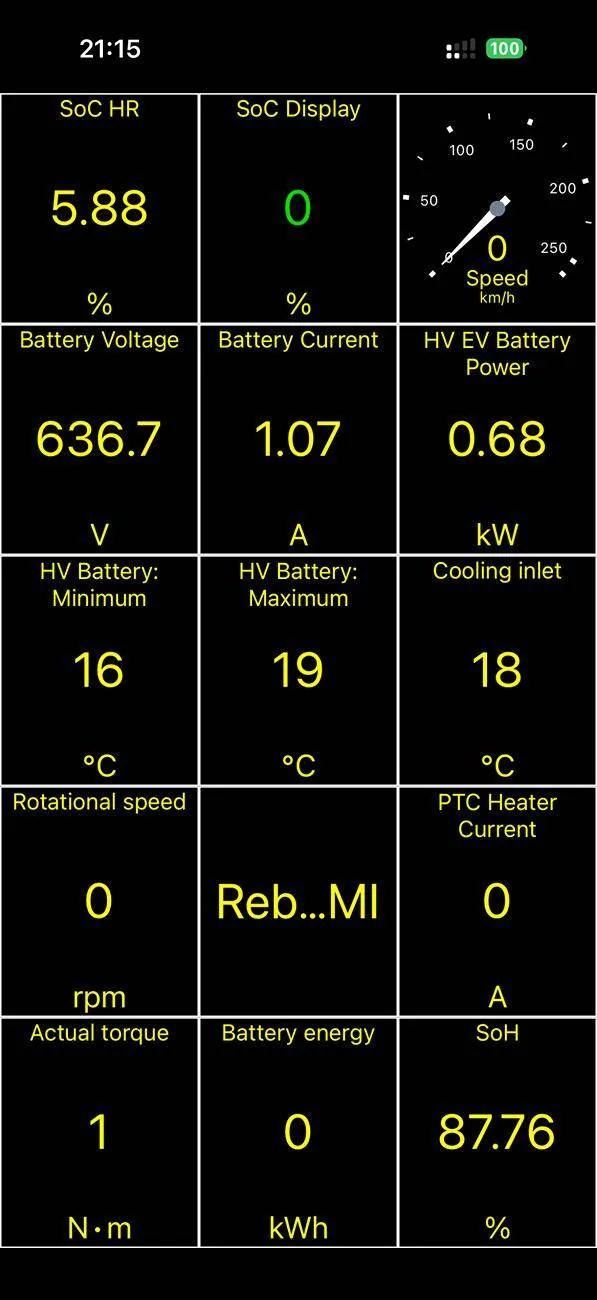

Hi,
I did the full recalibration driving slow for at least 2h and 200km to 0% and 0 kWh in battery energy, let it sit for the night, charged it up to 100% and again sit for the night.
The SOH actually went down a bit but the SOC is more accurate now in this cold weather.
I have some questions about the data that we see in car scanner.
Here is my data at 0%
Porsche Taycan How-to Recalibrate your SoH. 1737533800659-9j
And at 100%
Porsche Taycan How-to Recalibrate your SoH. 1737533944442-fk
and after the night
Porsche Taycan How-to Recalibrate your SoH. 1737533982004-vu
What is the meaning of those values?
Battery energy 76kWh Why not 83.7 kWh?
SOC HR 97.65. And why is it sometimes above the display SOC sometimes under it?
