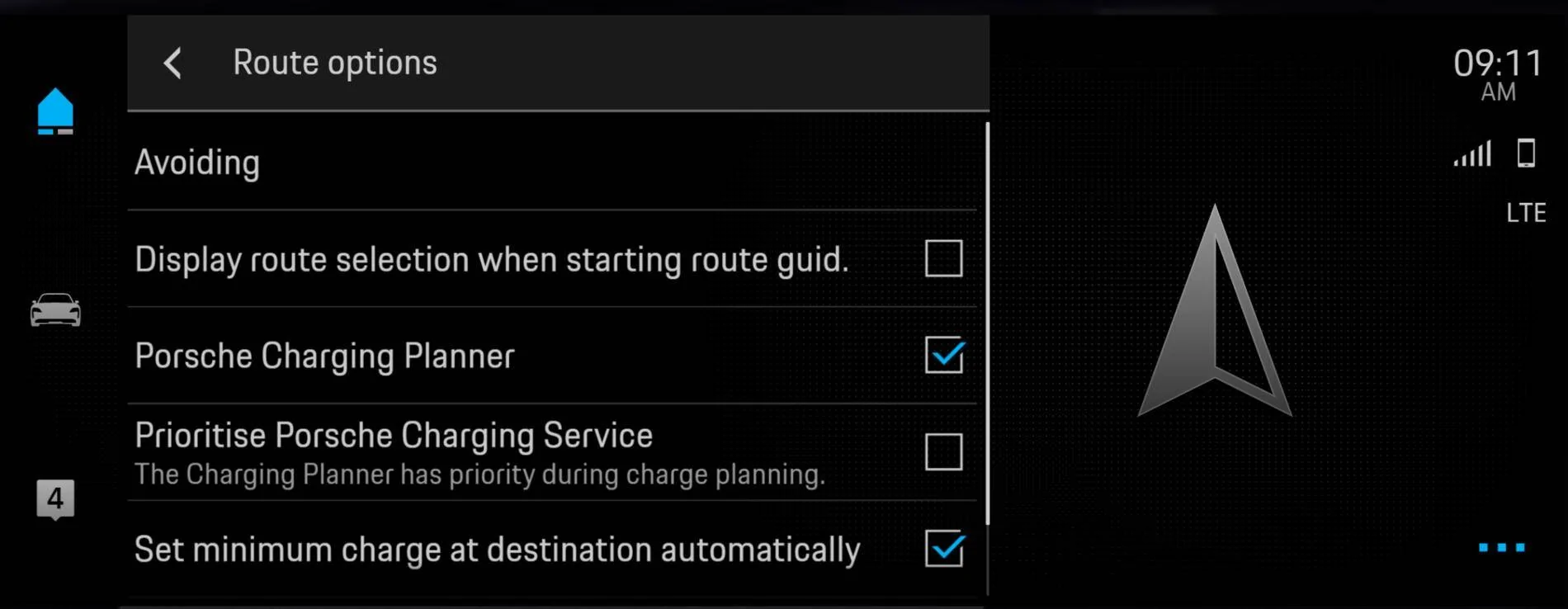

This forum is very helpful…and i appreciate everyone’s answers. I do need some help again and this time its with the Porsche Charging Planner. I understand the function of this feature but for some reason my Porsche Connect App has a message that says “Porsche Charging Planner Active” and this overrides my home charging profile of 85%. My car is now charging to 95% and i don’t know how to stop this. I’ve unchecked the option on my NAv in the car But my APP still had it displayed.
Any suggestions would be very helpful because i don’t want to charge car to 95% at home.

For whatever it’s worth…I was able to de-activate the Porsche Charging Planner from the PCM…I had to reboot the computer so to speak…the process is…touch the top right hand corner of the PCM screen…where the time is displayed with two fingers. This will immediately shut off the screens and begin a reboot. Problem solved.

Within the NAV menu go to options ( ... ) and enable / disable Porsche Charging Planner. There are other related options (under Charging) but this is the main one.
Porsche Taycan How to turn off Porsche Charging Planner on my Porsche Connect App 1630413627852
Note that this is not related to any charging profile and is only active during route guidance / navigation.
To address your charging issue you must set a timer in conjunction with your profile to ensure charging ends at the time you specify otherwise you will exceed the charge level you want (profile only talks to a 'target charge').

In the Porsche Connect app, tap the “Explore” item in the lower left, and then from within the map view, tap the button with the “Funnel” icon. Then in the resulting “Map Settings” screen, scroll all to way to the bottom and there should be a “Route Options” section with a “Porsche Charging Planner” on/off switch….
