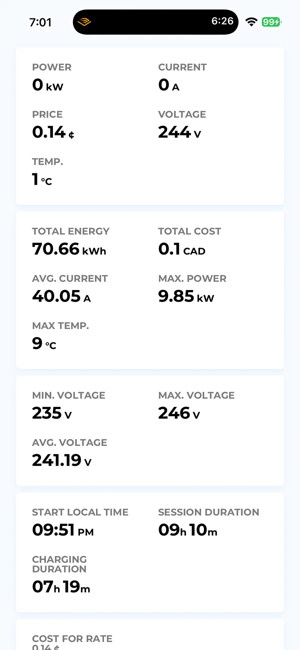

So my car asked me to do an OTA update. Being a good software security lemming I accepted the update.
Now I charging at 8.6 kWh vs the 10.5 I used to get!!!
This not only pisses me off, but I just spent extra money to install 60A lines and 48V chargers (x2). I feel like Porsche should give me money back if it’s a result of the update. It’s possible that it’s something else since I’ve also noticed my range has dropped by 20+ kms same if not warmer temps.

Yes, I have an 11kw charger on my build sheet. The max power my charger put out is 9.85 kw so the car only took/got 8.something. 🤬😡

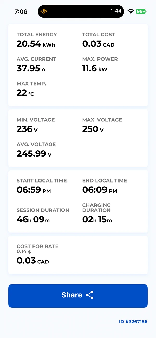

This was last Saturday, same charger

Porsche is deploying software that changes the maximum current/amps their OBC allows in North America from an EVSE…
the screens shown in posts #5 & #6 are reports from @RED! EVSE - these screen shots show the charging session from the EVSE point of view - and clearly demonstrated that the EV in question used to request/allow a full 48 amps (11 kW) and post software update now only requests/allows 9.6 kW (40 amps)…the EVSE doesn't lie, it's too dumb and passive in this scenario as it's just a simple raw AC power "pump" - nothing more - nothing less - and simply provides the power/current as requested by the Vehicle/OBC…
with the latest software Porsche has nerf'd the Taycan's OBC in North American to a maximum charge rate of 240V/40 amps (50 amp breaker) which is nominally 9.6 kW of raw AC power…this will translate to an in vehicle display of ~8.x kW displayed by the vehicle/app during charging
