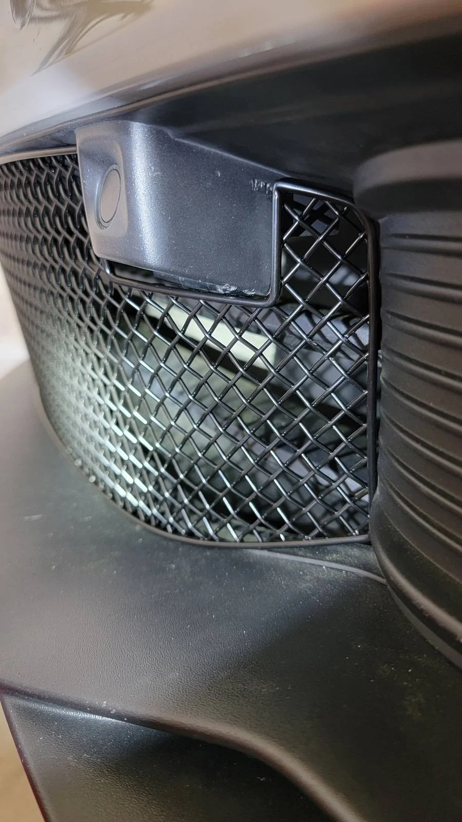

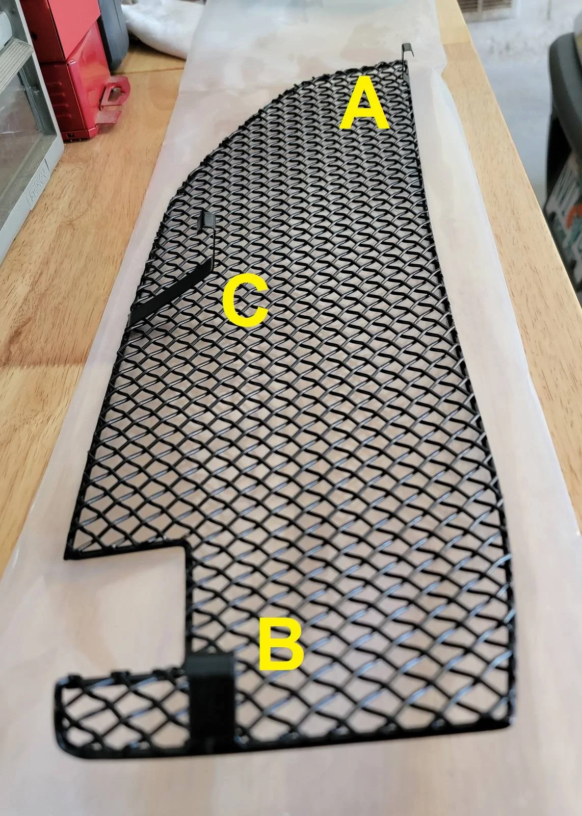

Maybe it's an issue of manufacturing tolerances, but mine definitely fell under the PITA installation, even after watching the video and reading this thread multiple times prior to starting. I lined up the outside edge first but then, contrary to some others, I also locked the outside tab (A) before going to the inside one (B) near the radar. That allowed me to push B in as needed (it took a whole lot of force) without the other end popping out. I did leave the top (C) tab for last.

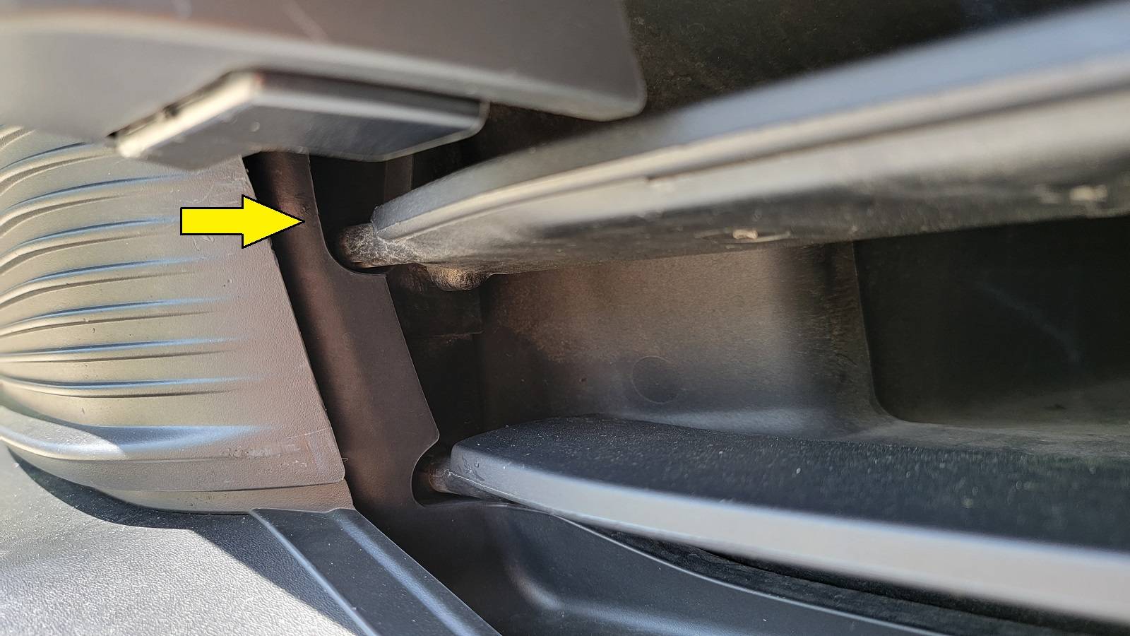

As @Hirschaj mentioned, you have to get tab B connected properly for the fit to look right. See the arrow below for the spot where tab B needs to connect.

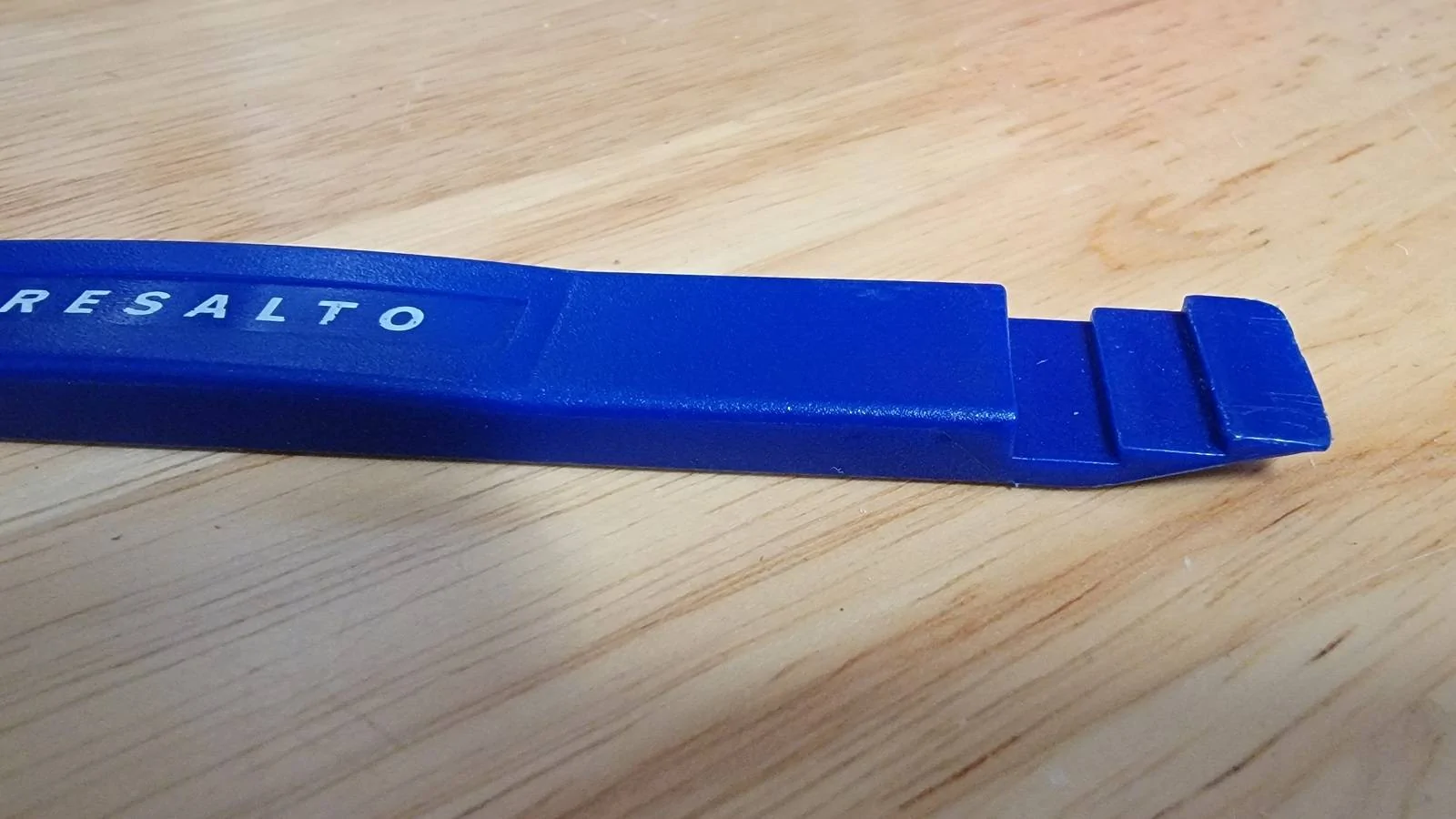

I also ended up using one of my plastic trim tools to hook and pull the grill back out where needed to give the best fit.

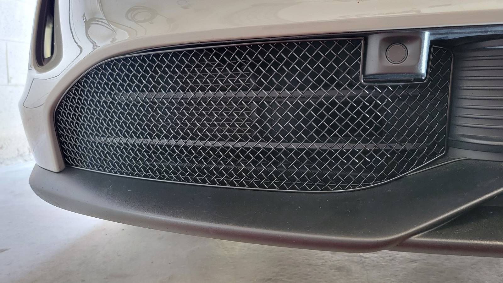

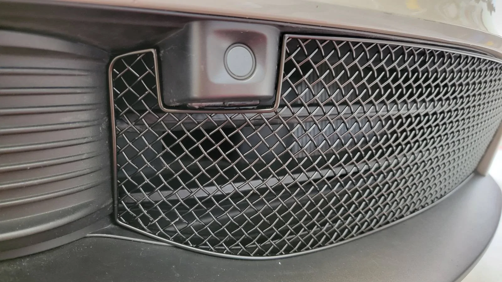

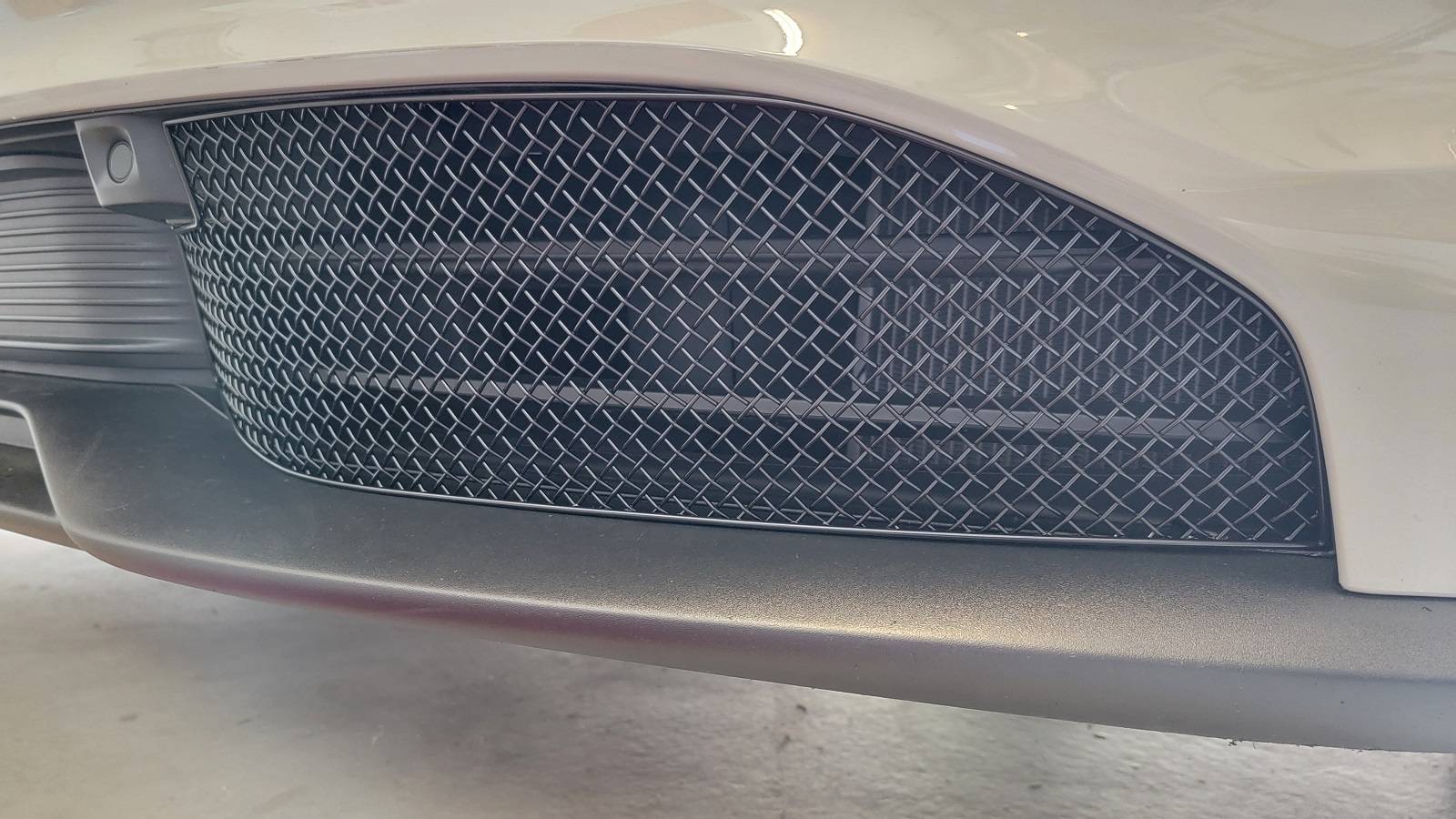

In the end, the fit seems good and I'm satisfied that these will protect me nicely. Here are my results.
I also went on a ten mile drive and didn't see any increases in battery temperature. We'll see what Florida's summer brings but I'd rather take my chances with these grills installed than face a large repair bill from a rock strike.
You lined it up beautifully. Nice work (besides the few scratches that nobody will ever see). 👍

@ShiftyWolf. Your battery temp will be fine. Put mine on last June and battery temps very seldom went above 90/95F during the Florida summer, and that included a couple of road trips. Ran hotter than that when DC charging and would steadily drop back after leaving the charger. Air flow does not seem to be restricted in any significant way.

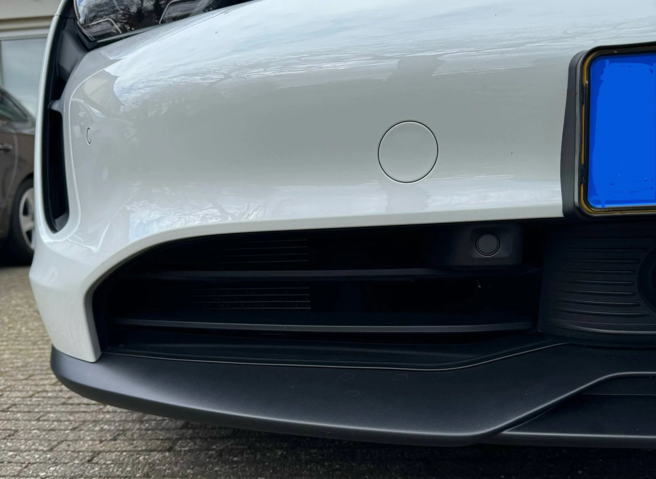

I'm interested too , but looking at the pictures, I think my 2022 GTS falls into the Turbo/Turbo S bucket since I have the optional exterior carbon package which gives the sport package front bumper (not sure if that's the official name). But it has the upturned wings near the center pod of the intake. So I'm guessing these screens won't work on my car until they produce the ones for the Turbo? Or have I found myself in a separate category altogether?

From Boxster/Cayman/911 forums and anecdotal reports, fitting these could invalidate a warranty. One side of the argument is that the grille protects the rads, the other is that they impede air flow. The daft part is Porsche themselves fit similar to some 911 models. May be worth getting dealer confirmation.
