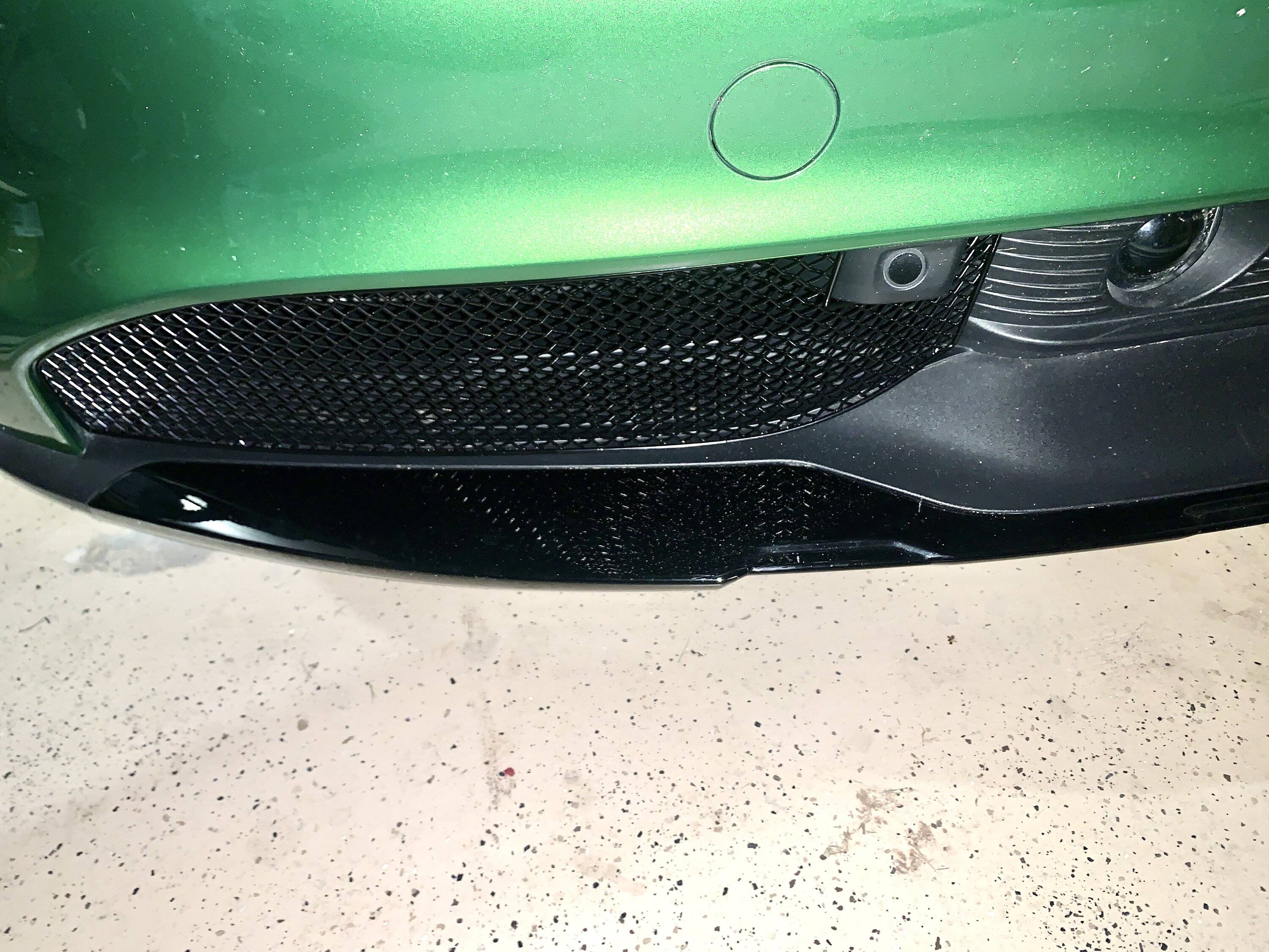

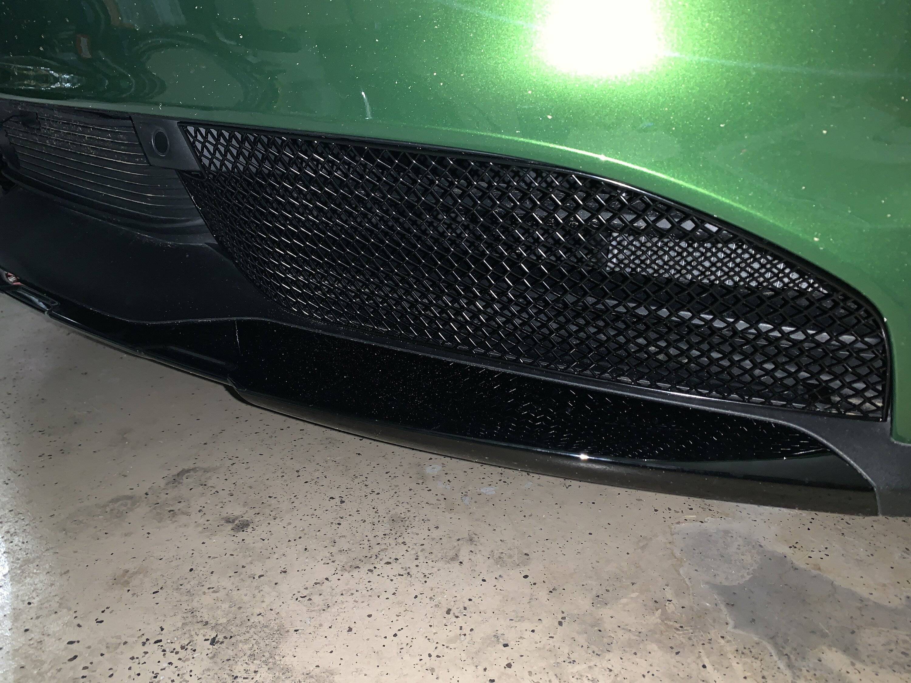

Ok, so I finally installed these on the Taycan. Instructions say to protect paint with blue tape, but that’s not necessary if you are careful. I would position the narrow end towards the outside of the grill first and then connect the hook that’s on the center edge of the grill towards the middle of the car. Then connect the hook on the top in the middle. Finally, connect the last hook on the bottom towards the outer side of the grill. They are well-made and this took probably less than 10 minutes. Hardest part was that I forgot to override the motion detector on the garage light and went into total darkness while on my back in front of the car :)
Next I will install them on my club coupe since the current ones are looking rather ragged. It is a bummer as the instructions say I need to drill two 3.5 mm holes in the bumper. :(

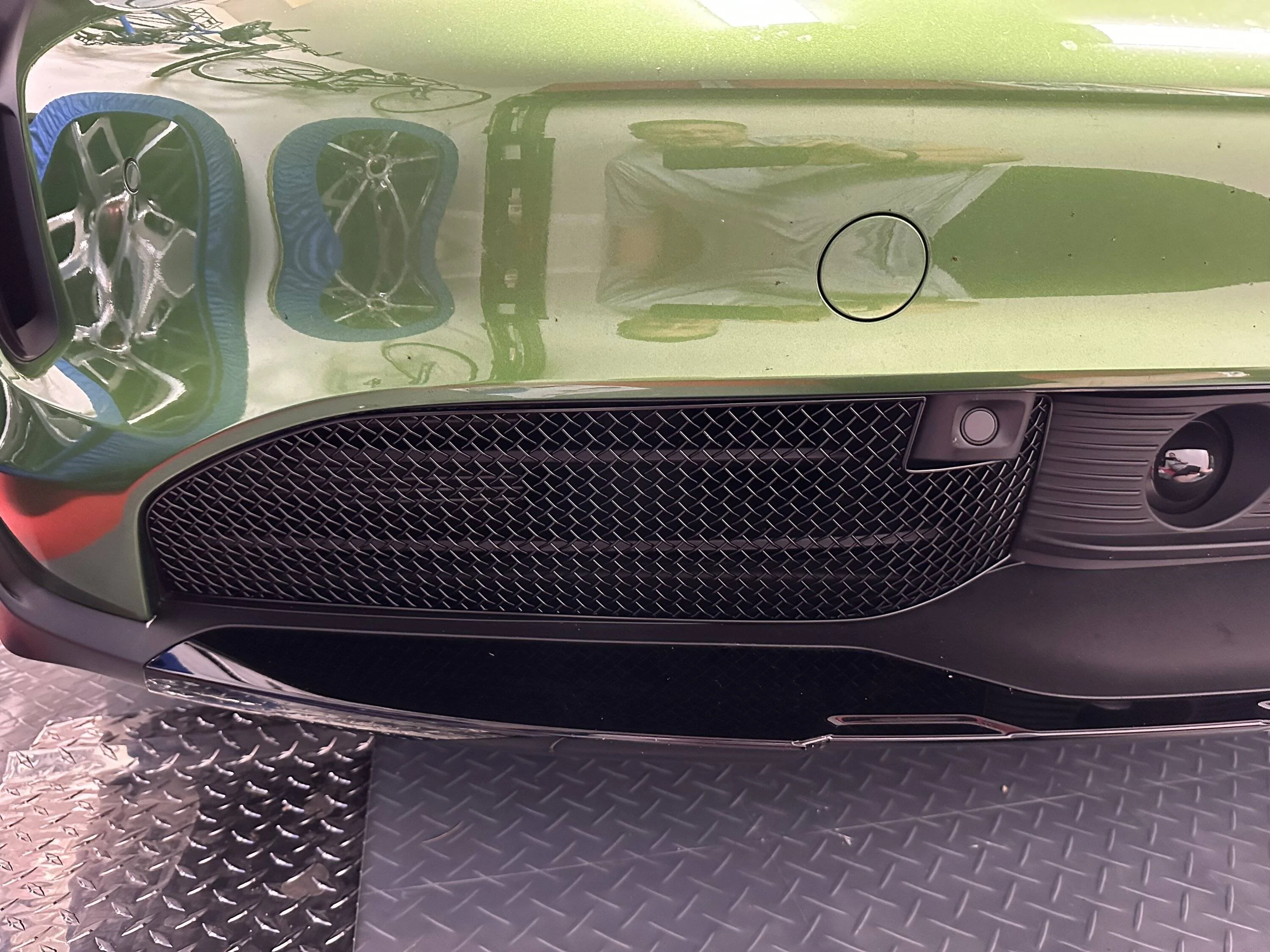

Thank you to everyone who shared their pictures in this thread. I thought these were a giant PITA to install properly (the first one was anyway). The second one took about 1-2 minutes to get installed once I understood how to do it.
Note: Based on the pictures, many of you might want to revisit your installs to get them lined up properly.
Here are the pictures of mine. I believe they are lined up exactly as they should be. Please forgive the absolutely filthy car. It was just sitting outside at the airport for a week and I have not had the chance to wash it yet :-(
Method, as suggested by @TDinDC (thank you!), "position the narrow end towards the outside of the grill first and then connect the hook that’s on the center edge of the grill towards the middle of the car. Then connect the hook on the top in the middle. Finally, connect the last hook on the bottom towards the outer side of the grill."
You have to push on the end that is towards the middle of the car pretty hard to get it to engage and align properly. Once you get it connected you know for sure because there is no gap. I also used my small flathead screwdriver to align the bottom outside edge of the grill properly. In my case I pulled the grill slightly back towards me so it would align perfectly (this also confirmed that the lower hook was catching where it was supposed to).

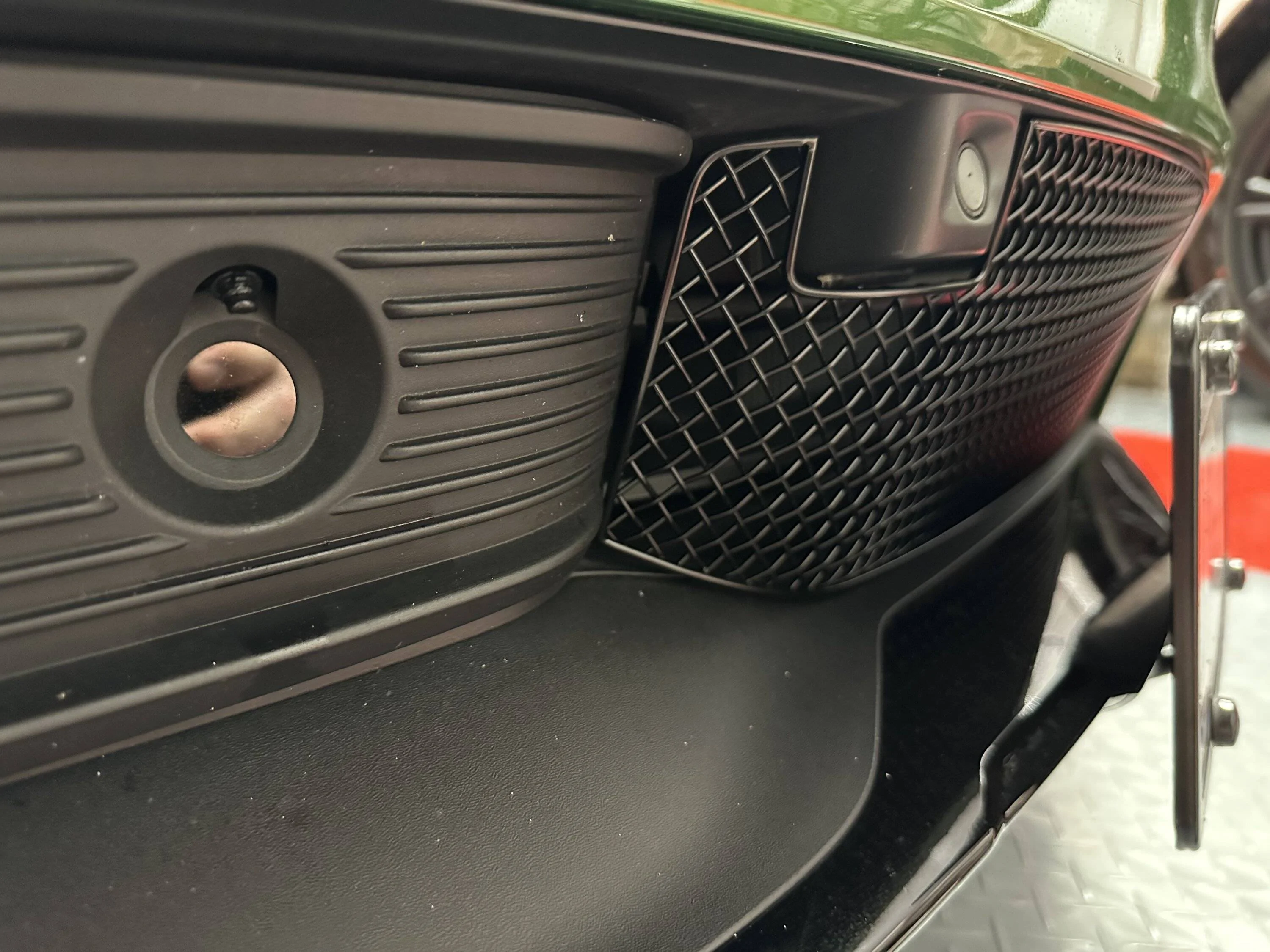

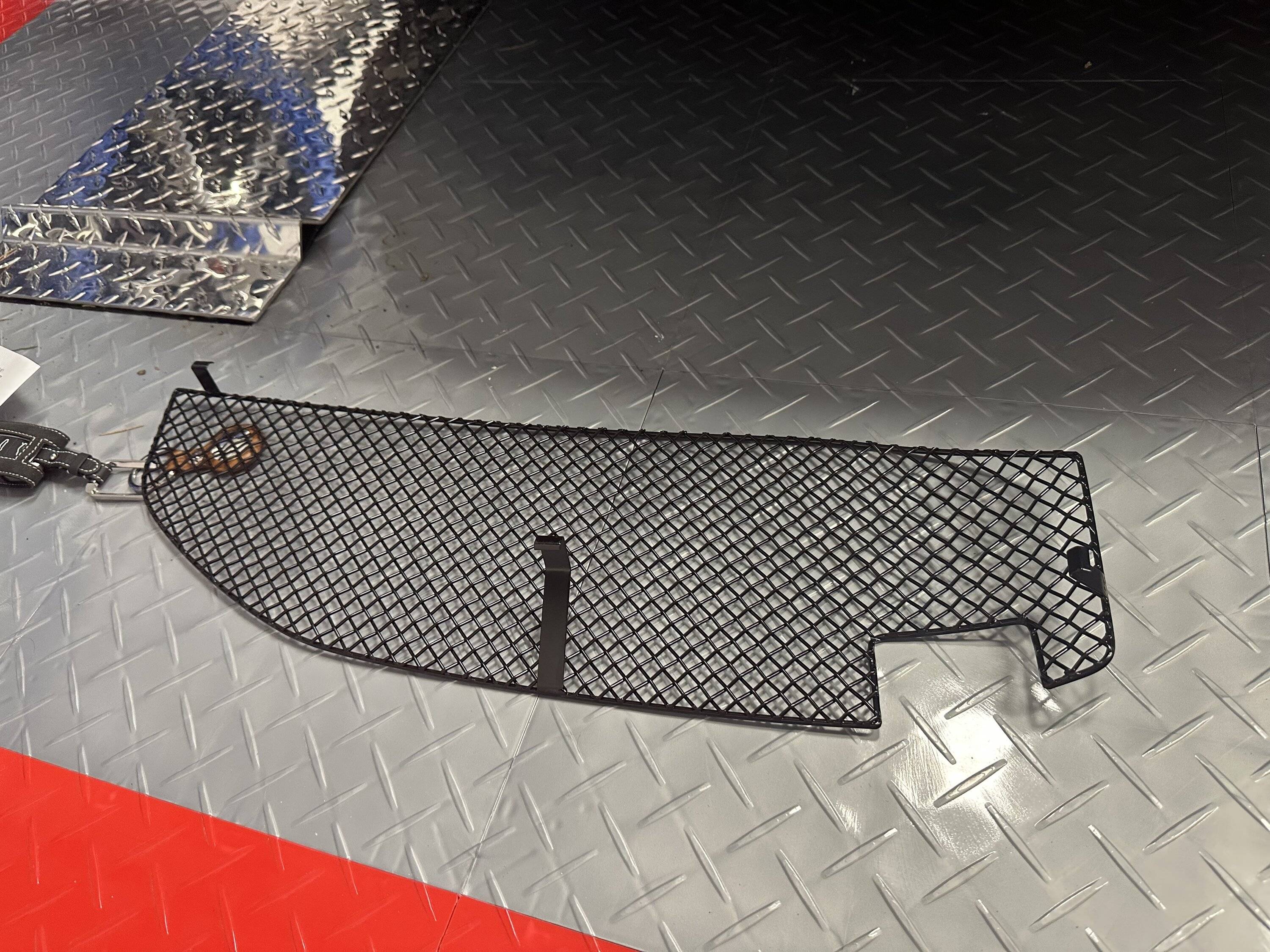

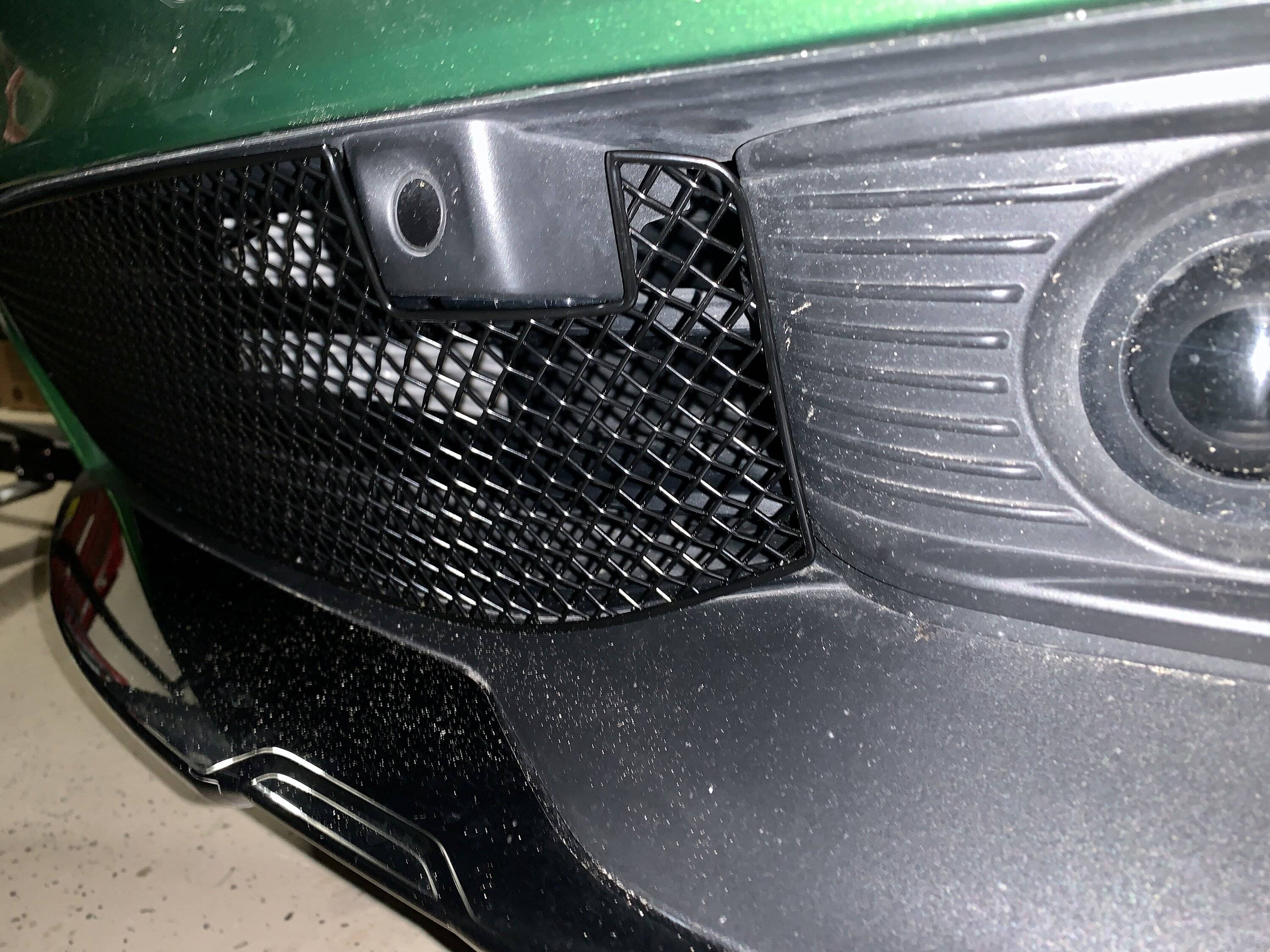

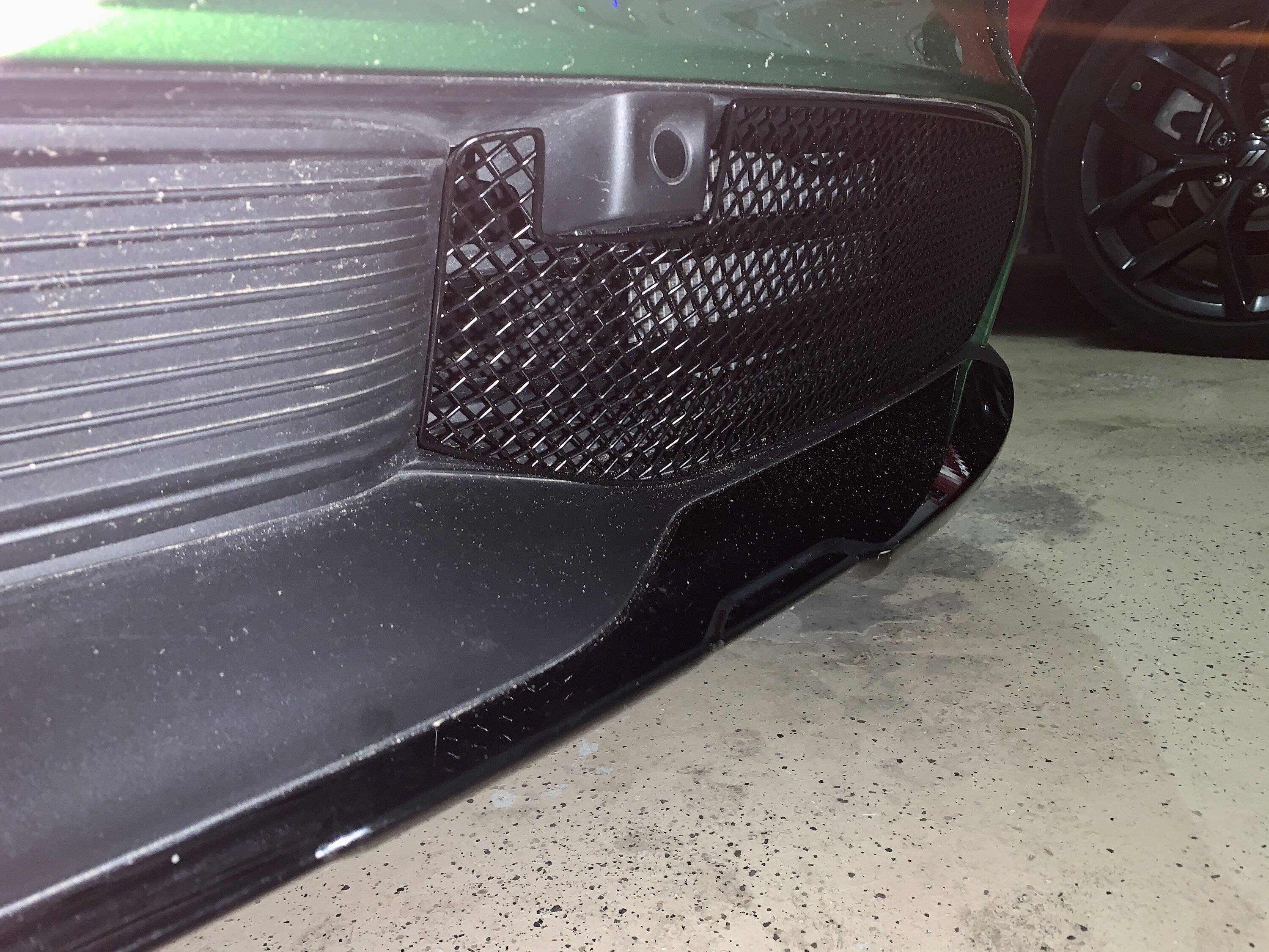

Maybe it's an issue of manufacturing tolerances, but mine definitely fell under the PITA installation, even after watching the video and reading this thread multiple times prior to starting. I lined up the outside edge first but then, contrary to some others, I also locked the outside tab (A) before going to the inside one (B) near the radar. That allowed me to push B in as needed (it took a whole lot of force) without the other end popping out. I did leave the top (C) tab for last.
Porsche Taycan I tried the Zunsport grills and I like them 20240310_104710
As @Hirschaj mentioned, you have to get tab B connected properly for the fit to look right. See the arrow below for the spot where tab B needs to connect.
Porsche Taycan I tried the Zunsport grills and I like them 20240310_132350
I also ended up using one of my plastic trim tools to hook and pull the grill back out where needed to give the best fit.

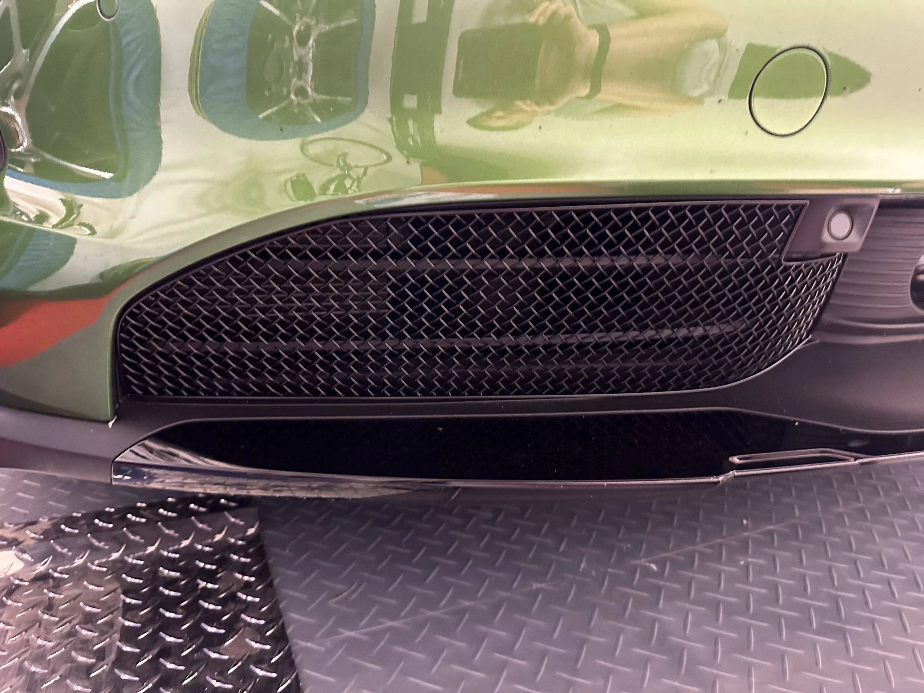

In the end, the fit seems good and I'm satisfied that these will protect me nicely. Here are my results.
Porsche Taycan I tried the Zunsport grills and I like them 20240310_133828
Porsche Taycan I tried the Zunsport grills and I like them 20240310_133901
Porsche Taycan I tried the Zunsport grills and I like them 20240310_135122
I also went on a ten mile drive and didn't see any increases in battery temperature. We'll see what Florida's summer brings but I'd rather take my chances with these grills installed than face a large repair bill from a rock strike.
