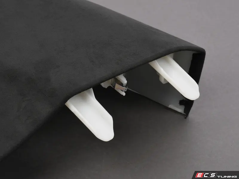

Bit of an update - my ECS Tuning order for the Race-Tex lower B-pillar trims is still being processed (special order like they told me) but they've updated the product page for one of the parts (one side) to have multiple photos of the actual part (included here as well) and you can very clearly see that it is, in fact, the Race-Tex finish. Yay!
Porsche Taycan Interior B-pillar trim 2107992_x800
Porsche Taycan Interior B-pillar trim 2107993_x800
Porsche Taycan Interior B-pillar trim 2107994_x800
Porsche Taycan Interior B-pillar trim 2107995_x800

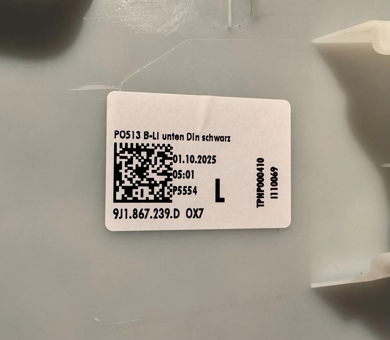

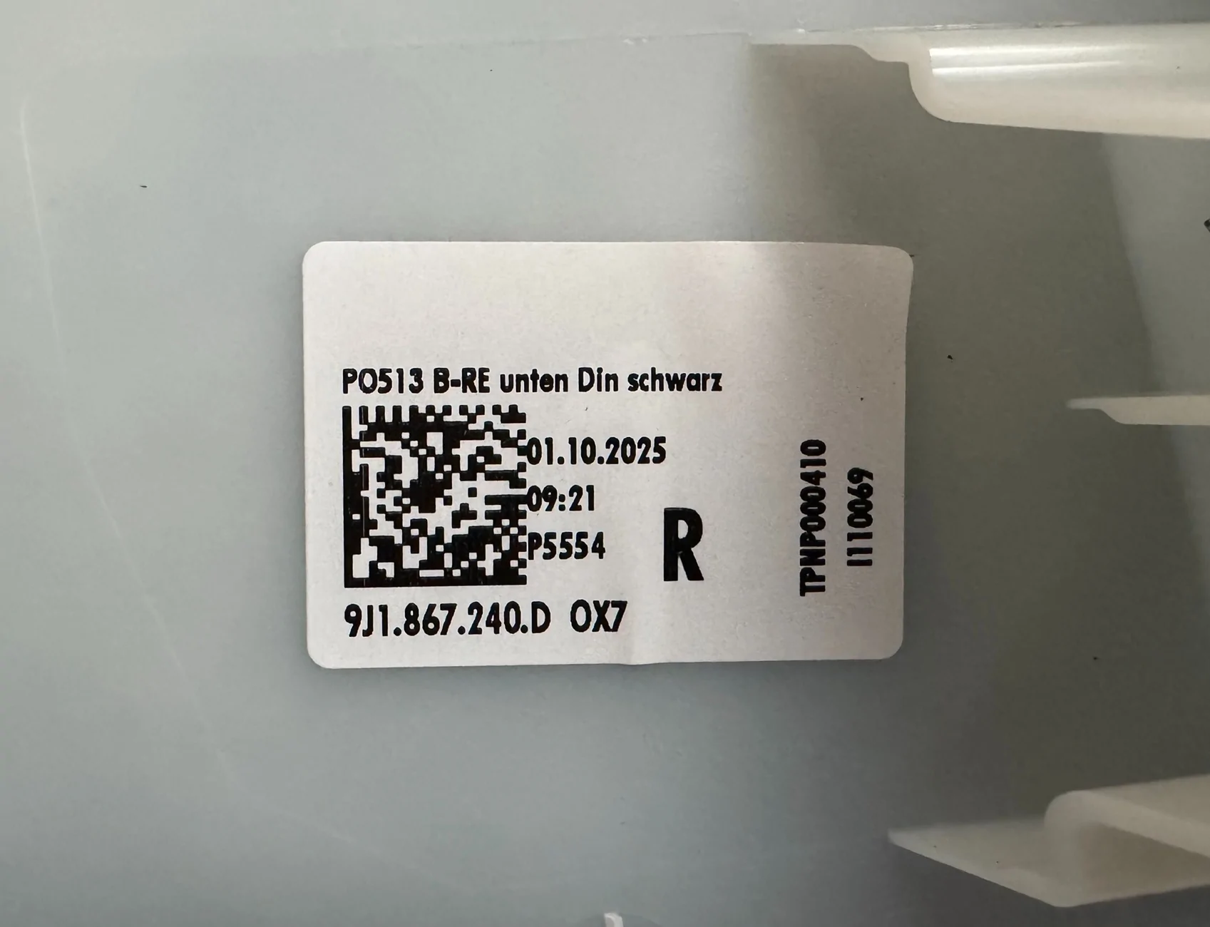

Update! ECS Tuning has shipped the other side trim piece, so both are on their way! 🎉 Their product pages for the lower B-pillar trim panels in black Race-Tex now both have images:
https://www.ecstuning.com/b-genuine-porsche-parts/b-pillar-trim-black/9j1867239dox7/
https://www.ecstuning.com/b-genuine-porsche-parts/b-pillar-trim-black/9j1867240dox7/
...and from those images we can now see which part numbers are which:
9J1-867-239 is the left side (when in car facing forward, driver side in North America)
9J1-867-240 is the right side (when in car facing forward, passenger side in North America)
Once again, with D-OX7 being the latest revision ("D") and black Race-Tex finish ("OX7") suffixes, so:
9J1-867-239-D-OX7 - left side lower B-pillar trim in black Race-Tex
9J1-867-240-D-OX7 - right side lower B-pillar trim in black Race-Tex
I will of course take photos and describe the installation when I receive and install mine, but for anyone wanting to do this specific upgrade, you might want to go ahead and order the parts now while they're apparently available, as the photos on those product pages make it pretty definitive that those are the parts you need...

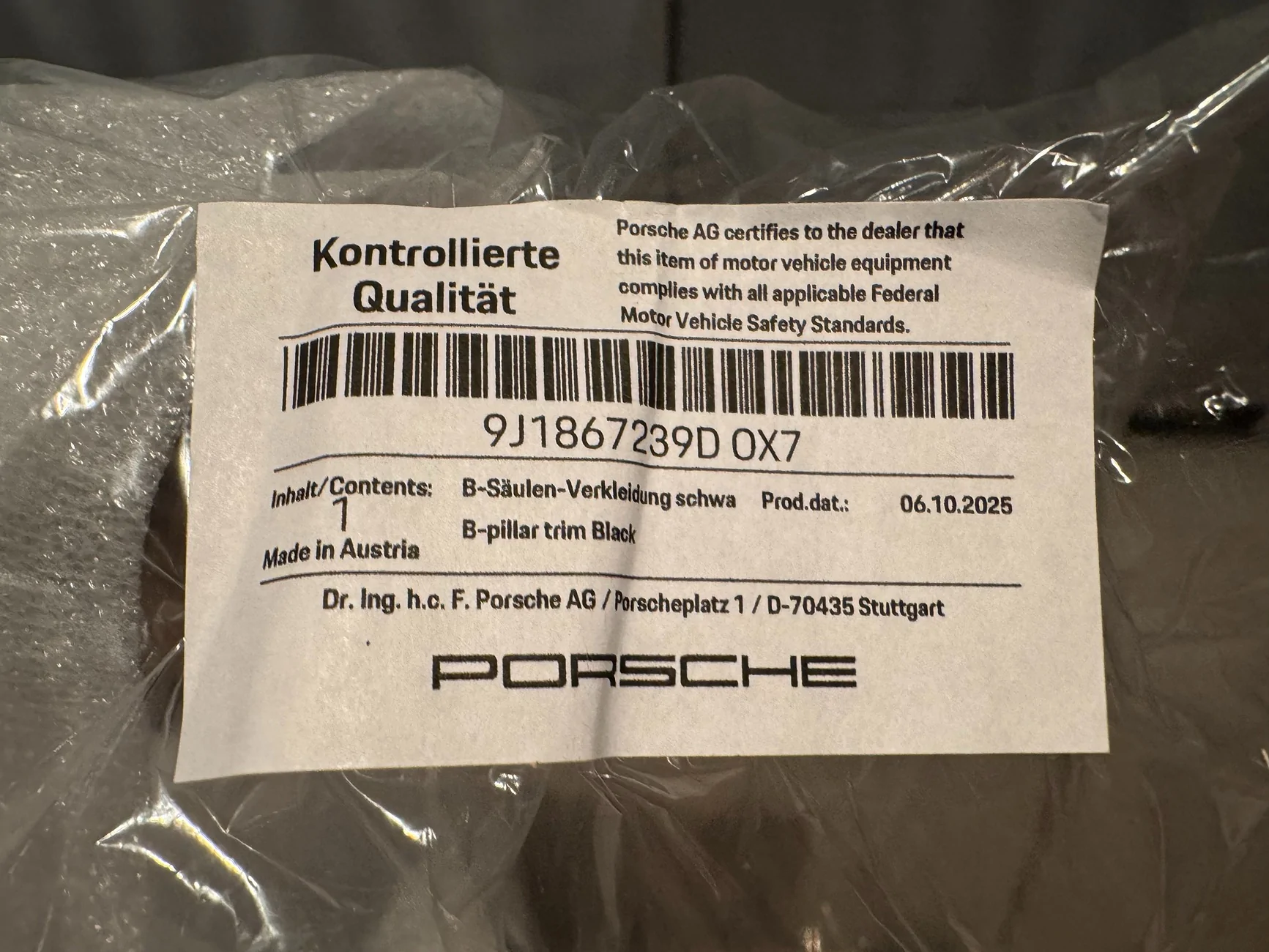

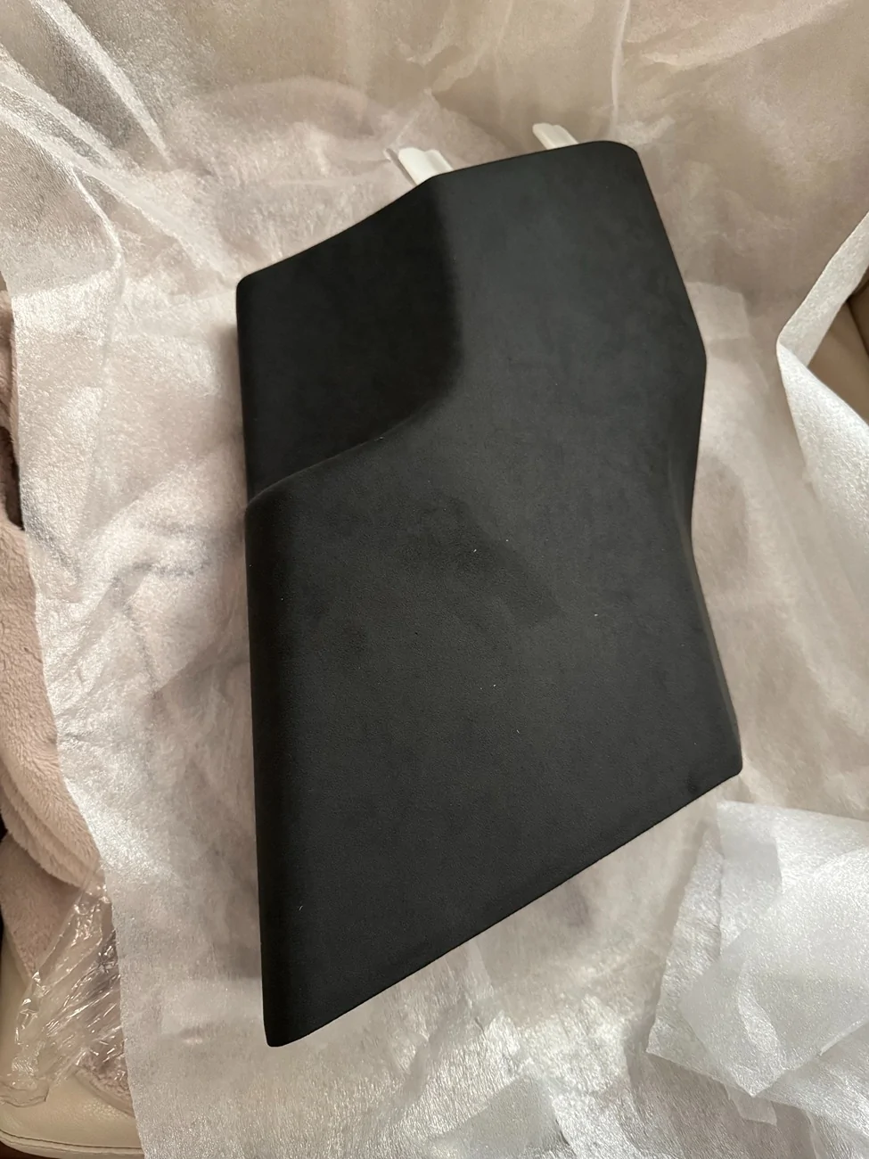

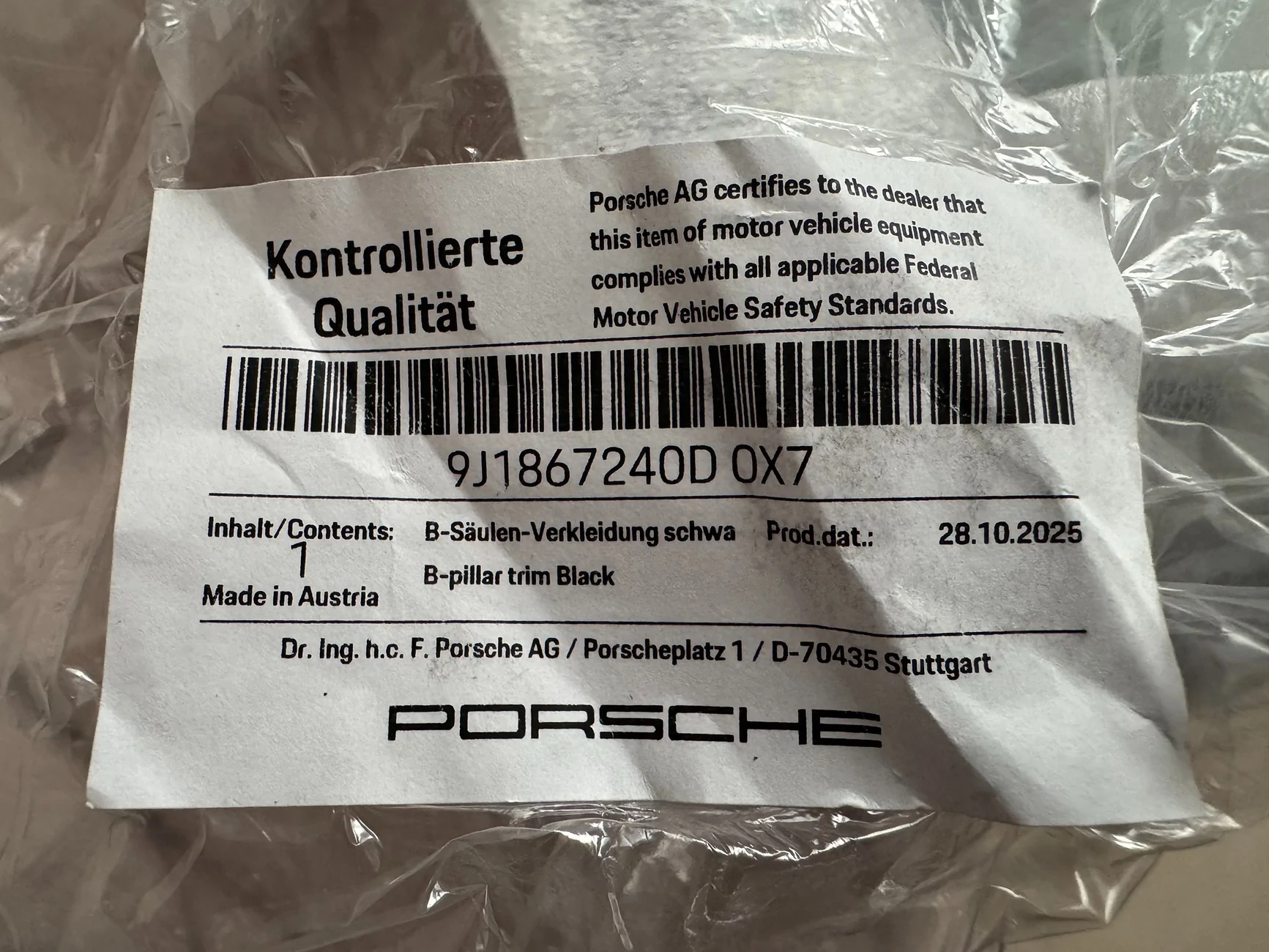

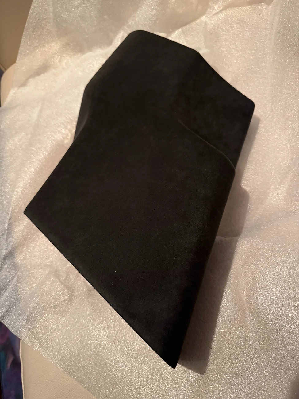

The eagle has landed! Well, the left side (driver's side here in the US) anyway. Black Race-Tex loveliness. The right/passenger side is supposed to arrive tomorrow. I won't be able to install until Friday or the weekend. Will keep y'all updated!
Brian
Porsche Taycan Interior B-pillar trim 01_trim_panel
Porsche Taycan Interior B-pillar trim 02_part_label
Porsche Taycan Interior B-pillar trim 03_package_label

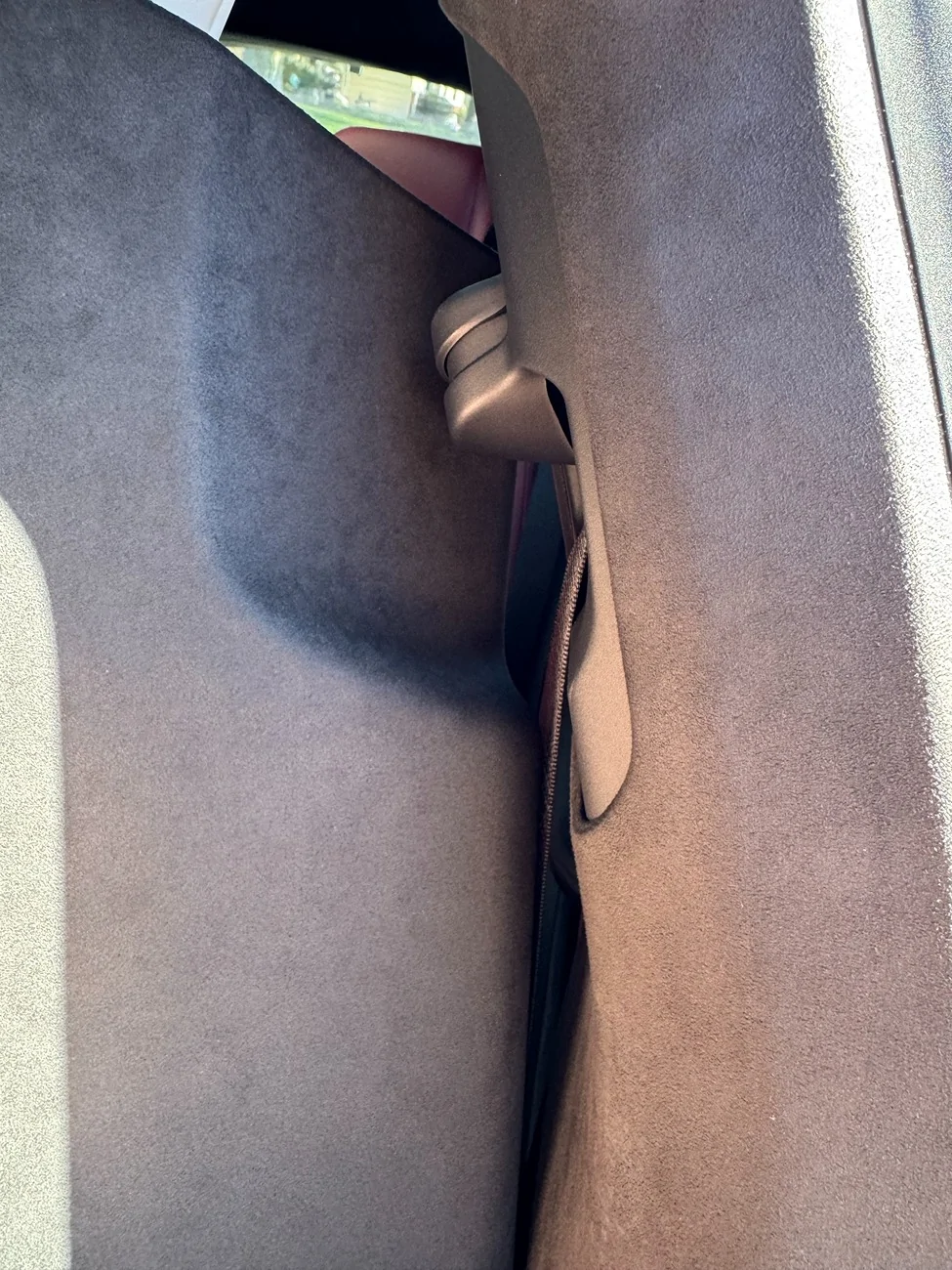

Noice, color match good?
bwherry
Brian
Feb 19, 2022
178
143
Los Angeles, CA
'23 Taycan GTS ST, '22 BMW iX xDrive50

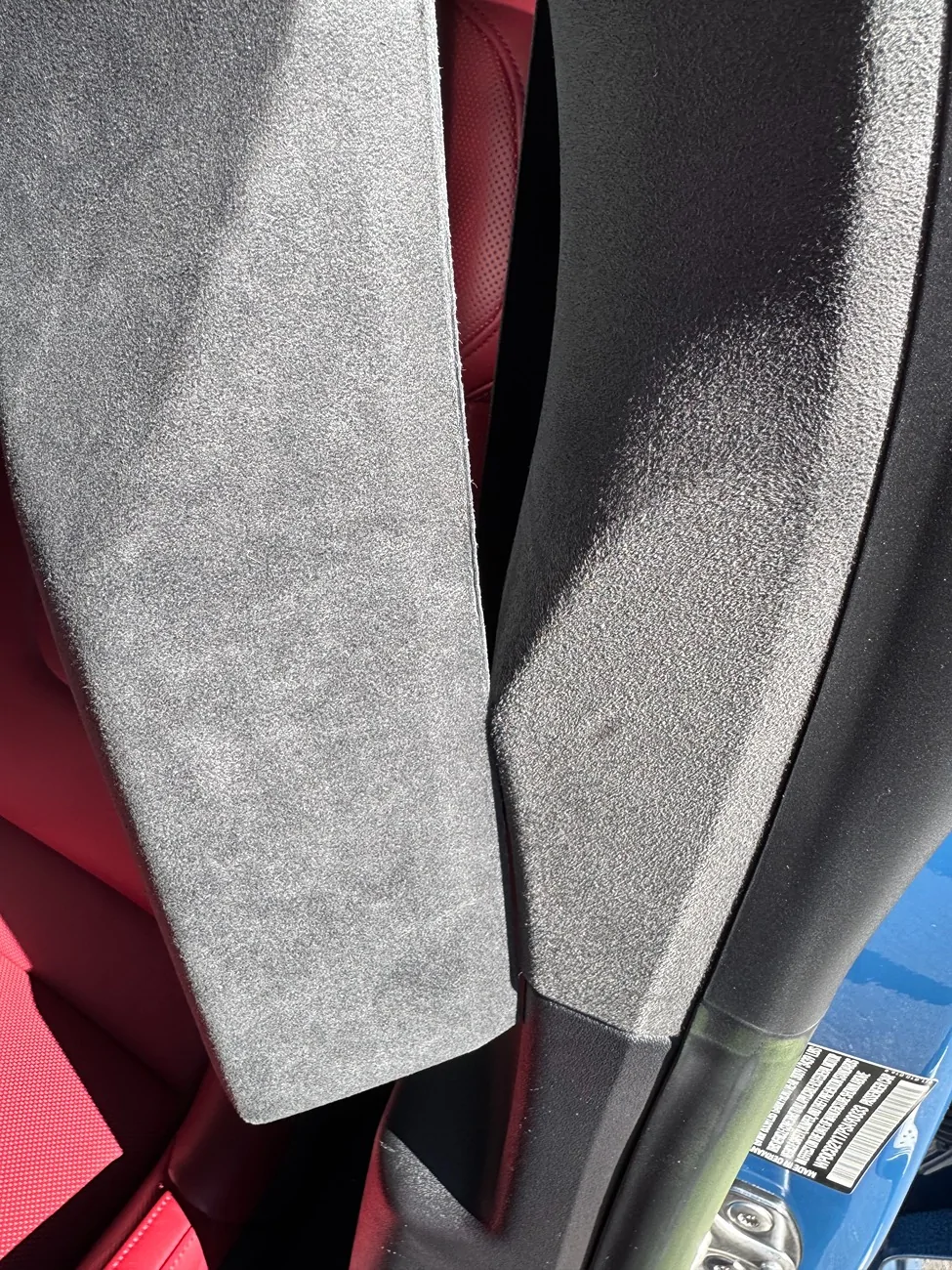

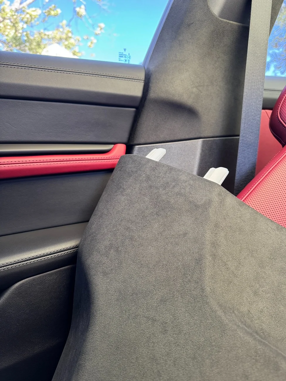

Yup, match is perfect. Not the best lighting conditions (bright/sunny out), but below are a few snaps of the Race-Tex trim panel next to the existing Race-Tex in my car's interior. It's exactly the same. (black Race-Tex but looks grey in the bright sunlight)
Porsche Taycan Interior B-pillar trim IMG_4320
Porsche Taycan Interior B-pillar trim IMG_4321
Porsche Taycan Interior B-pillar trim IMG_4322
