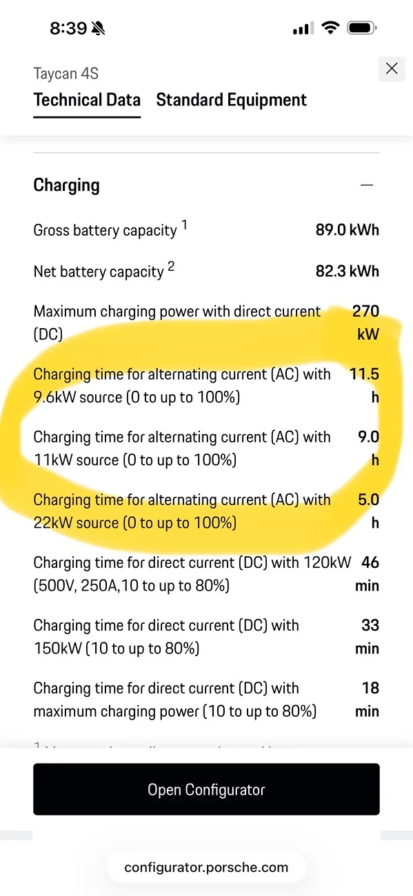

here is an extract from the 2026 Taycan configurator. was the same for the 2025. so charging with over 9.6 kw rate.
this is meaningly as they list 11 kW numbers because in other regions they do support 11 kW charging - the manuals are "universally" true and therefore the same world wide - that does not mean any particular product in a given regions will match the user manual based on regional limits…
another way in which Porsche confuses the market place on this topic…

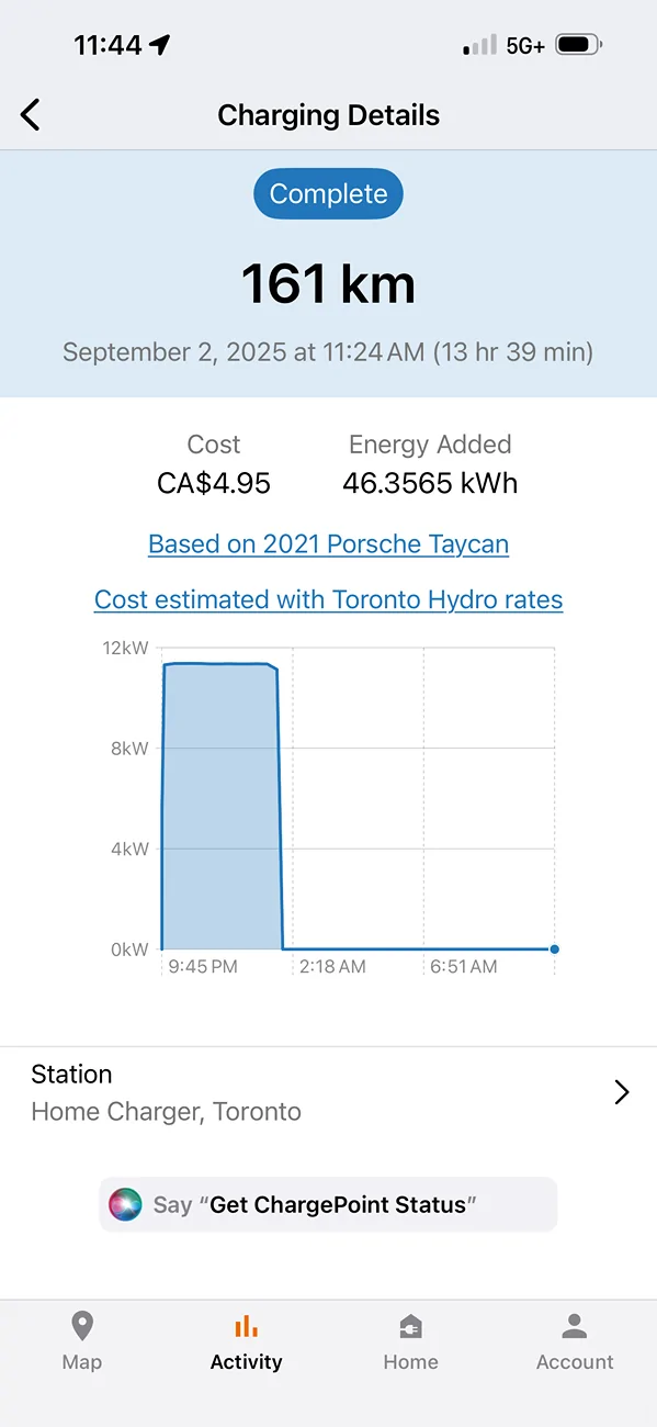

I have a chargepoint hard wired 50 amp charger on a 70 amp circuit. you will see from the app summary the charger was delivering about 11 amps. that translated in the car to about 10.4 kw. ‘20 Taycan.
my’25 Taycan never get beyond 9.3 kw at the car.
chargepoint flex is a 50 amp EVSE as you note, and requires a 62.5 amp circuit breaker - LOL - they don't make 62.5 amp circuit breakers, so 70 amp is the next size up - pre-2025 Taycan can accept upto 11 kw (until Porsche service gets their hands on them and silently downgrades them) - and there is now mulitple data Points that Porsche limiting newer Taycan to 9.6 kW…
I love the ChargePoint flex EVSE it's one of the best EVSE's on the North American market - but it's 50 amp EVSE status is an odd ball in the EVSE landscape - there are no EV's that I'm aware of with a 50 amp OBC - EV tend to have 7.68 kW, 9.6 kW, 11 kW, or 19.2 kW OBC's - no one ships a 12 kW OBC (50 amps @ 240V) - so the Taycan (or any 11 kW EV) can't quite max out the ChargePoint flex's maximum capacity - still a great EVSE recommend it highly if you want to migrate away from Porsche's terrible North American EVSE's…
Porsche has been silent on this topic, but it appears they no longer support 11 kW charging for any of their North American EV's
they do however support 11 kW charging for the MY'2024 and later Cayenne Hybrid…ROFL
nothing here is inconsistent with my post #11 on this thread…it in fact confirms everything.
given a 50 amp EVSE's (70 amp 240v circuit) the 2020 Taycan is pulling 48 amps…
and on the same 50 amp EVSE Porsche has derated the MY'2025 Taycan onboard 11 kW OBC to only allow 9.6 kW (40 amps)…
@Briguy you have a small typo - you said 11 amps in your statemetn where I think you meant 48 amps for 11 kW

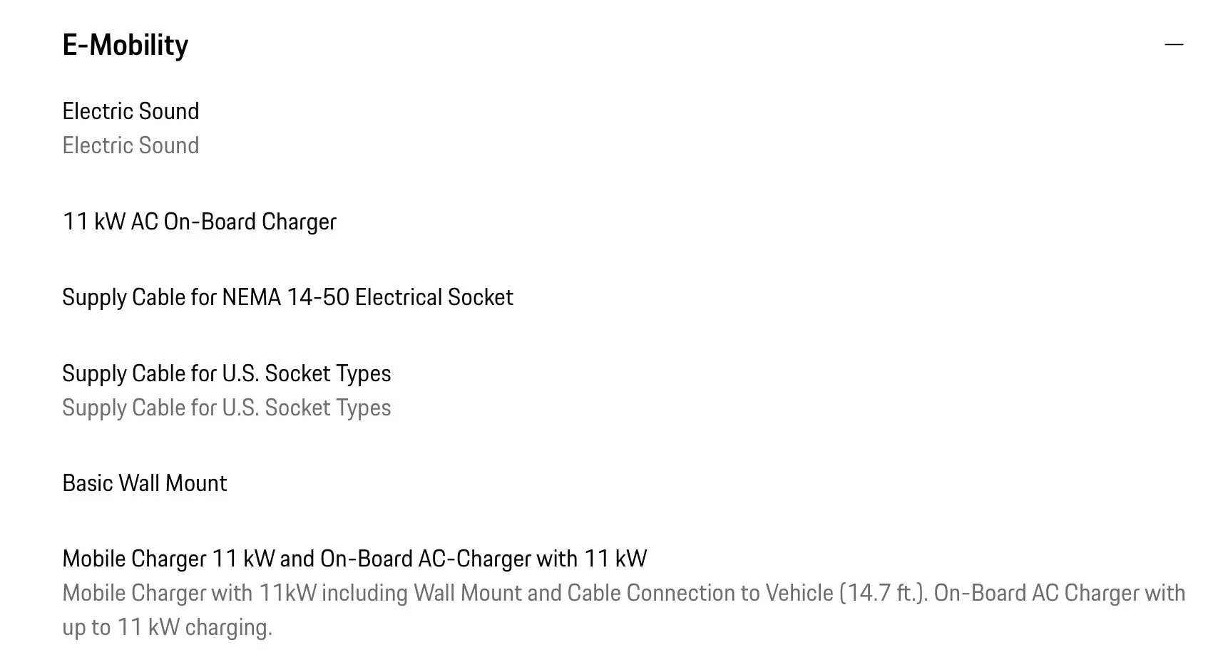

here is the current "Standard equipment" page from the North AmericanEV Cayenne eHybrid as of date/time of this posting…
Porsche Taycan Level 2 charging rate with a 50 amp capacity IMG_2751
Porsche lists:
  • 11 kW AC on-Board Charger
  • Supply cable for a NEMA 14-50 Electical socket (a standard 50 amp 240V circuit)

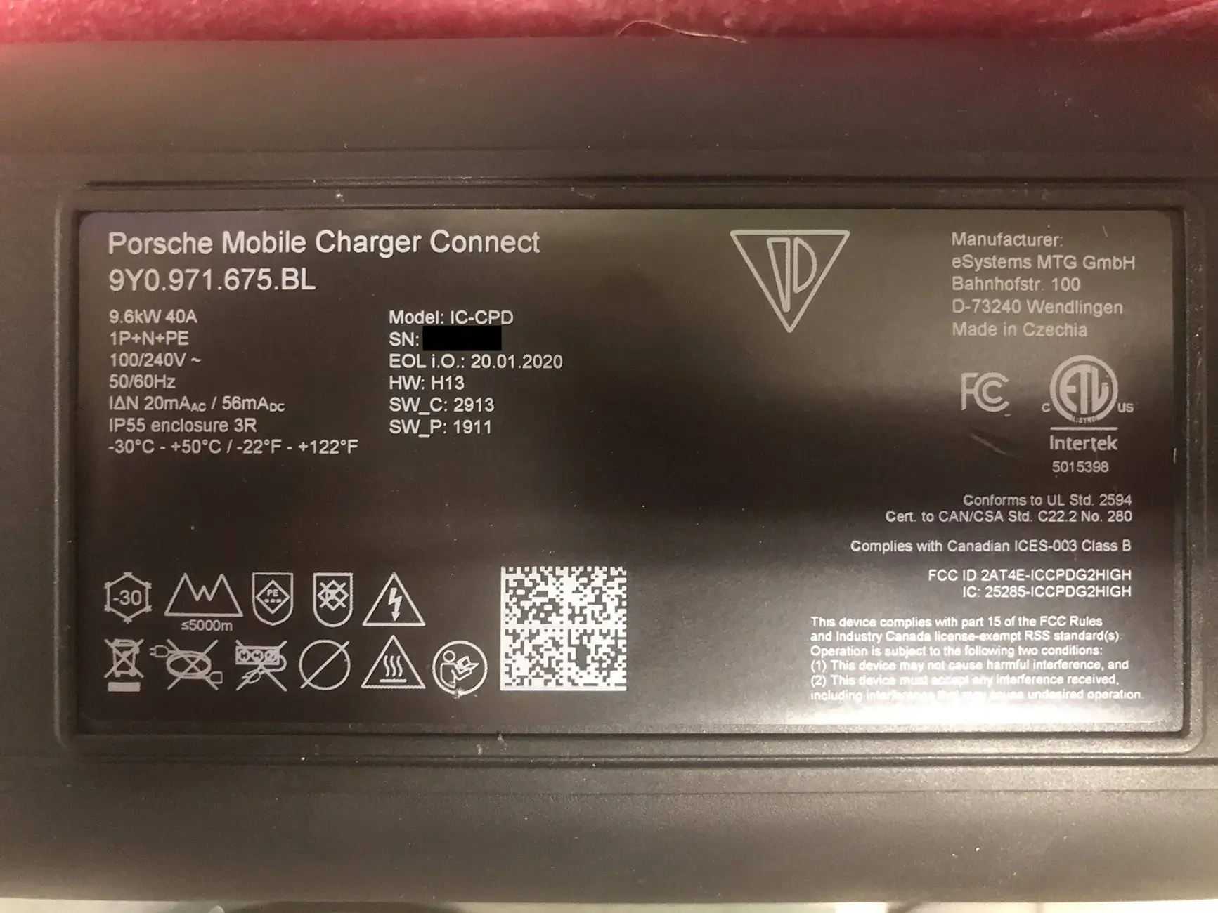

  • Mobile Charger with 11 kW charging - impossible for North America and conflicts with the specifications printed on the back of the unit (see picture above)
and the Cayenne eHybrid is confirmed to charge at 11 kW (so far will Porsche neuter them also?)
how Porsche expects their EVSE to charge at 11 kW with a 14-50 power supply cable is anyone's guess - not to mention the sticker on the back of the Mobile Charger clearly indicates it's a 40 amp 9.6 kW EVSE…
but this is an example of Porsche's "confusion" with regards to their EV charging limits…
but apparently if you want an "ev" from Porsche in North America that can charge at 11 kW - get a Cayenne - it can charge faster than the Taycan or the Macan EV…which makes perfect sense with it's 21 kWh battery…
