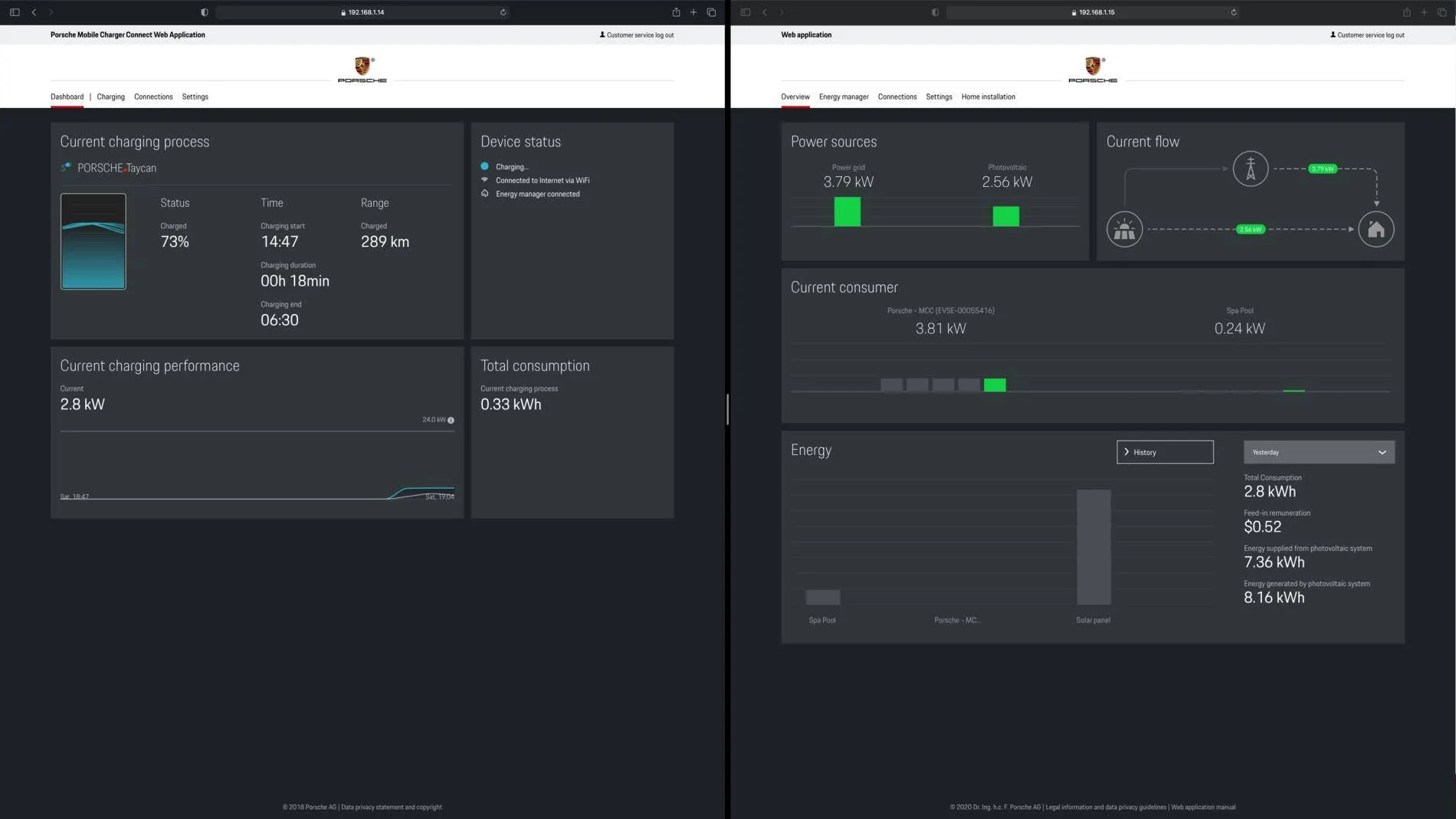

All,
Discovered after much Trial and Error and countless calls with Porsche Australia and JetCharge that the Mobile Charger Connect (MCC) does not like Class A IP Addresses.
My home network was set up as such with IP addresses in the 10.0.x.x Range. When we first set up the MCC whilst we could get it to get an IP address off the home network router, we could not log into the Web App nor could we get it to Sync with the Home Energy Manager (HEM). We tried different Routers, Access Points even considered it might be a harmonic noise issue from the PV Array Inverter mounted nearby.
In the end, it was as simple as changing the home network from using Class A IP addresses to Class C IP addresses (192.168.x.x).
If you ever get stuck trying to get the MCC to talk to your network, make sure your IP Address Range is in the 192.168.x.x range. Did not try Class B addresses (172.x.x.x) as I was over it by the time I finally made it all talk nice.
Hope that helps.
