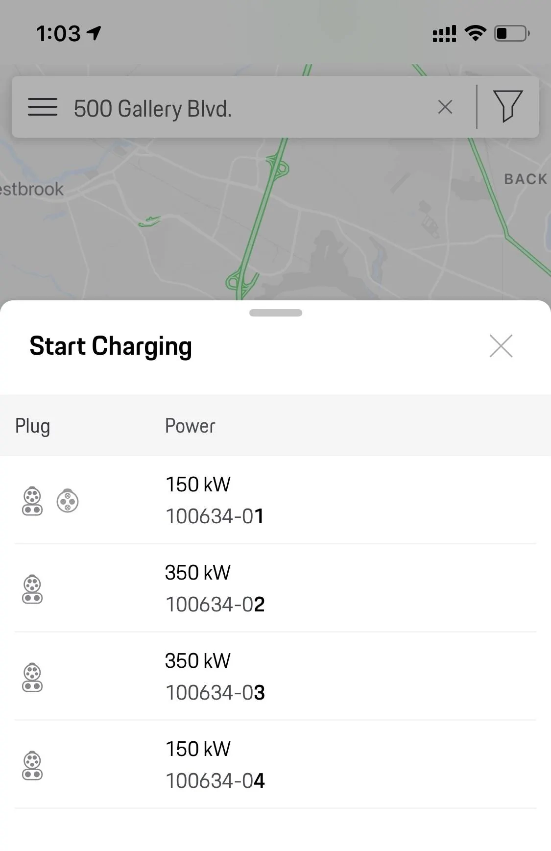

I just checked... (iOS) I can see both 350kW stations in Scarborough.
I think Porsche actually DOWNGRADED the IOS app. In the thread where this is specifically discussed, it appears Porsche replaced the current IOS version with the older/prior one. (This was identified near the end of the discussion). I'm not sure what the IOS rules are though for those who might have gotten updated before they pulled the new version... Who knows what other bug fixes and enhancements they effectively kicked to the curb when they discarded the newer version.
Android Users? Nothing. They didn't even downgrade us!
Anyone want to bet the Software Developer simply copied the code for the "150KW" button, changed the LABEL on the button to "350KW" but forgot to re-link it to the code which lists 350KW terminals? Seems it was simply easier to pull the new version rather than just fix it...

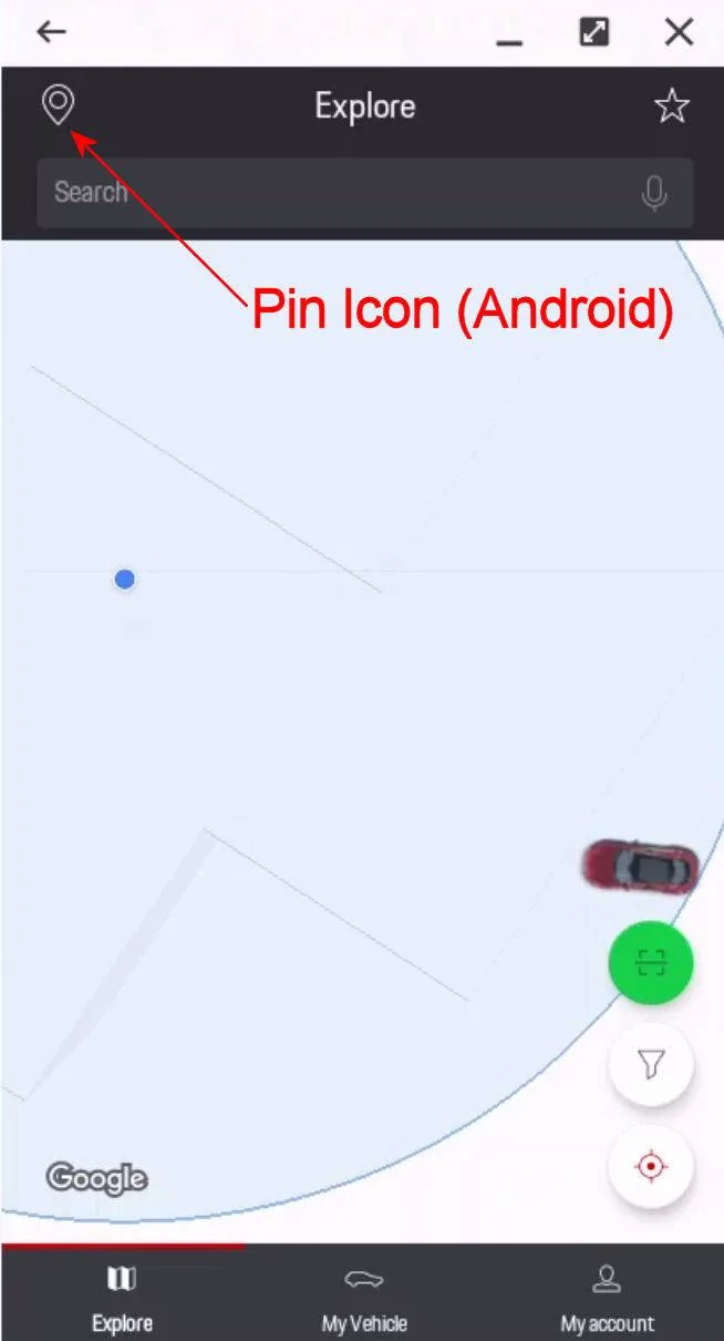

Here is what the "pin" icon looks like on Android:
Porsche Taycan Need help locating DC fast charger PinIcon

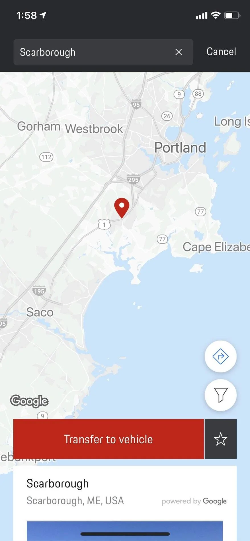

Those are IOS things unrelated to the app. I think the app is just buggy. I was able to get it to show one station, but it seems unwilling to just show all the stations along a route, or in a particular area. I have other resources to find stations, but obviously the app should work too!
