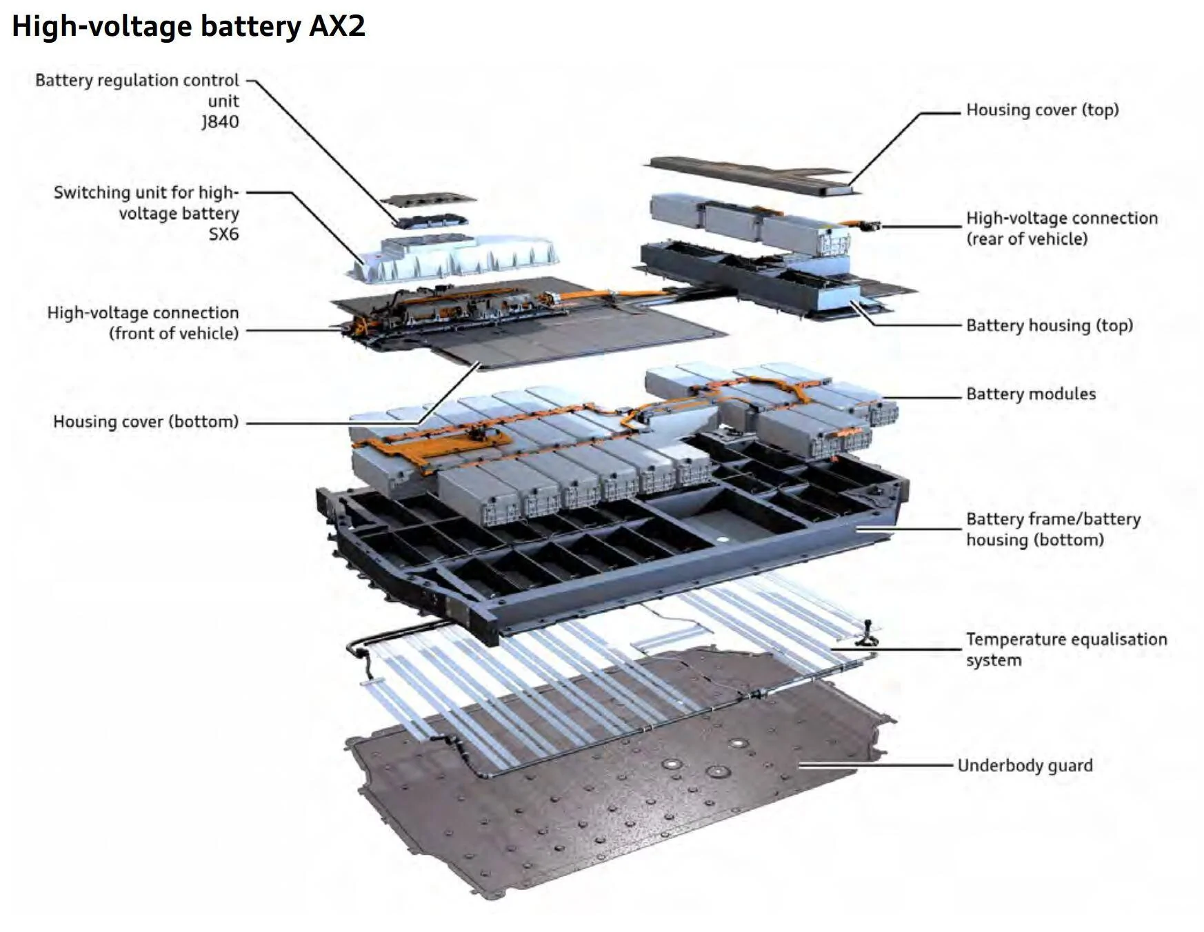

There was a time earlier this year where certain Taycans were produced that had potential sealing issues in the battery allowing moisture in.
Porsche Taycan New (Sept 2023) global stop sale on all Taycans? Recall APB2 updated Sept 11, 2023 1693693263937
Recently, Porsche released a Service Bulletin so dealers can test this, the tools were shipped to dealers at the end of June. This is part of WNW3 repairs that come after the WNT8 testing.
MC-10238775-0001.pdf (nhtsa.gov)
MC-10238814-0001.pdf (nhtsa.gov)
It looks like WNW3 may have become APB2 as of a day or two ago.
It seems to me that what is happening is that the "battery housing" from the image above is supposed to be sealed air tight. The "specialized tools" for testing look like a plug and port that connect to the front and rear high voltage connections allowing the shop to pressurize the battery housing and see if it leaks over time.
If it doesn't leak, everything should be good to go. If it does, the repair is to remove and replace the entire battery assembly. That would be a multi-week to multi-month process that we're going to pretend won't be happening.

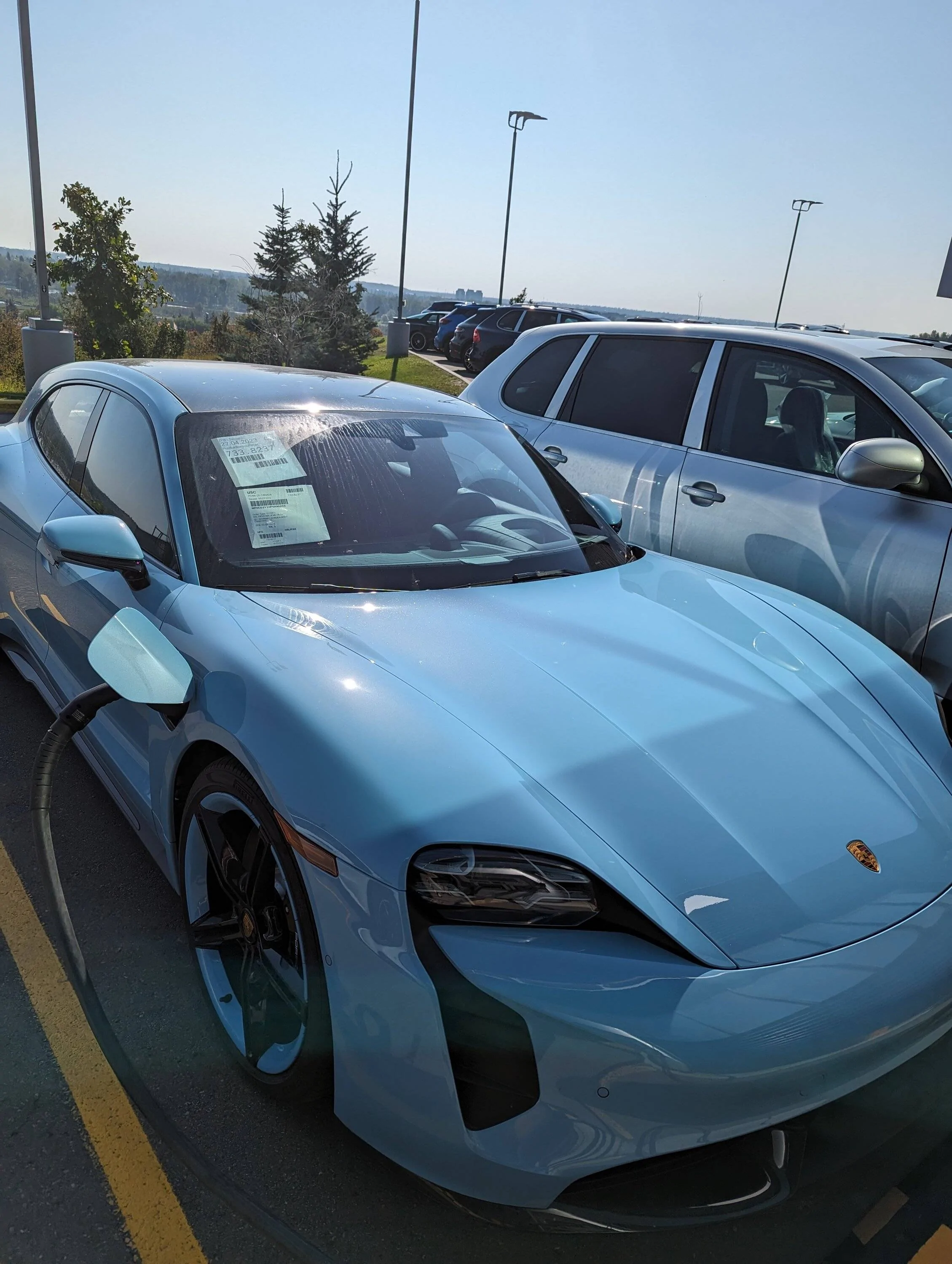

That said, the car looks quite nice for a vehicle that's been parked for 3 months and then shipped across the Atlantic and trucked most of the way up the continental US.
Porsche Taycan New (Sept 2023) global stop sale on all Taycans? Recall APB2 updated Sept 11, 2023 1693694588791
Yes it's dirty, and when we showed up unannounced the SA really wanted us to let him wash it before we took pictures. We didn't care about the dust, more that the car was real and actually existed after being delayed for so long. Heck, the car being delivered to the dealership late Wednesday night, Track Your Dream still thinks it's on a truck somewhere between Houston and Minneapolis.

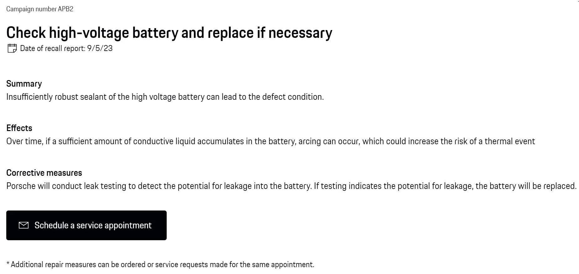

Details just popped up in My Porsche this morning. I guess we now know the issue is poorly sealed battery assemblies. Disturbing to think that battery fires could be a result of a pinhole leak in the battery casing.
