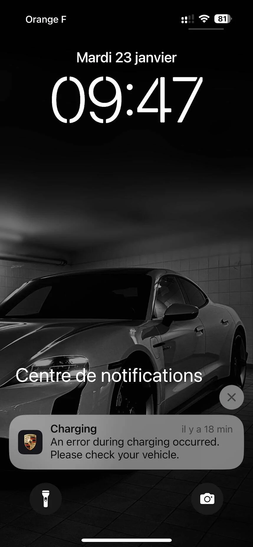

I have a wallbox too. I'd like to adopt the same charging profile as yours (the actual one). Plugin the car outside of the wallbox charging window, is the Porsche app sending an error message after the initial handcheck and each time you go back to the MyPorsche app?
The charging seems to start properly when the Wallbox time window opens though... Do I just have to live with the error and forget about it?
Yes - I ignore the errors.

Thanks. I tested this schema today and worked. Interestingly, no error at the end of the Wallbox time window if the car's charging session has ended first. Profile adopted!
