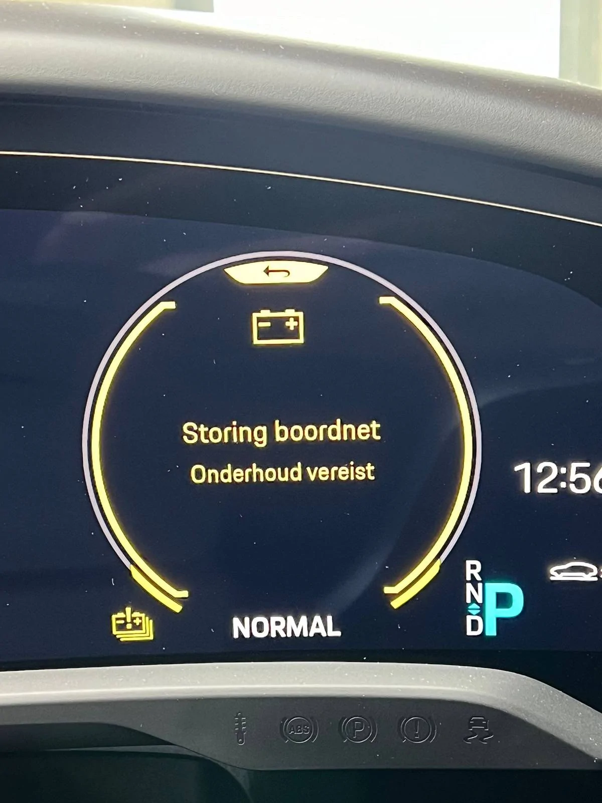

I am so happy that now I am not only member of the broken heater group but also the broken onboard charger group.
We are leaving on holiday tomorrow. Trip and hotels planned for chargers etc.
No power in the house when I woke up this morning. Taycan stopped charging at 4 am around 70 % soc. Turned the power back on but charge fault in the Taycan. Tried both ports and the house hold plug charger but nothing worked. Wallbox did work with my wife’s CLA.
Left to work with the CLA. My wife tried again after an hour but nothing. Asked her to go to a near Fastned to see if DC would work but she got the well know board failure message, srevive needed. Car would only go into neutral nothing else. Not forward or back.
Called Porsche assistance and they picked up the Taycan left me a RR Evoque. It is smaller and slower as the CLA so probably we will now go With the CLA. I have to return the RR next Friday but we are still abroad. still hace to,see how we will work that out.
I hope they can fix it soon because I want to return the car to the leasing company. I can stop the contract for 3000 euro and return the car. Can’t return it when it is broken.

Having my car back and driven it for a couple of times I am reconsidering everything I have written the last days.
It so nice to drive but do I trust it enough to keep it.
Now that the OBC has been changed and the heater software opdate, is it safe to presume I will be happy and out of trouble for the next two years of lease. All repairs are covered by the lease contract anyway and I have booked additional Porsche assistance for two years.
