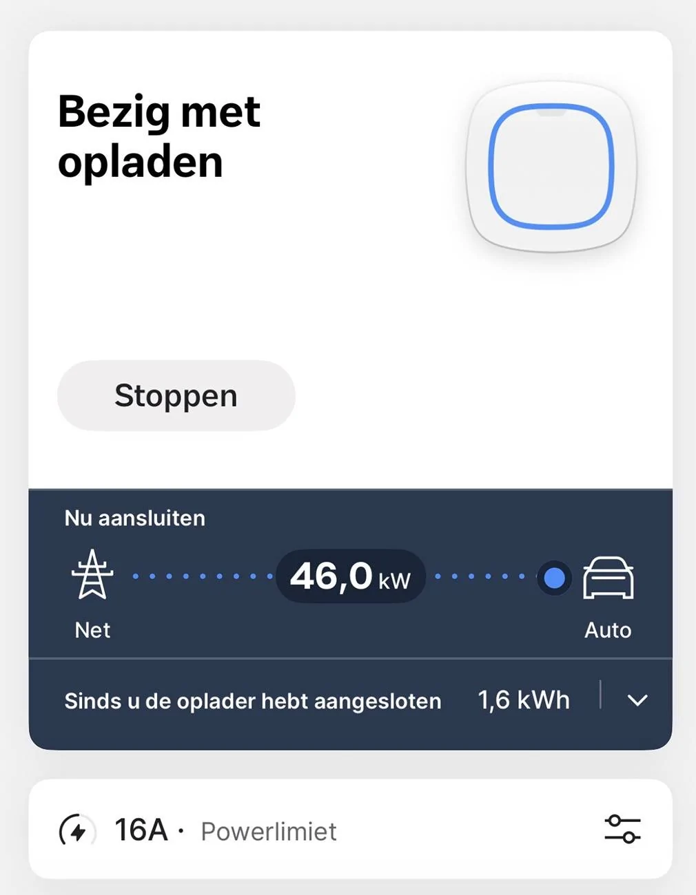

Has your wallbox been fixed? I’ve run in the same issues as you, woke up this weekend with no power in the house. Taycan stopped charging at 7 am around 80 %. I turned the power back on but charge fault in the Taycan. Car is now at the dealer to replace the OBC. But I also have the same issue with my wallbox pulsar pro, the charger shows over 40kW… So if you got it fixed, I’m very curious how.
I ended up installing a new one. They first changed the power meter but that didnt solve it. The charger worked but I couldnt register anymore wich was necessairy for my company. I didnt forward the costs to Porsche because I didnt want to give them a possibilty to blame Wallbox for the defect in the car and void the warranty.

I did not understand your figures.. EVSE's showing 40 kW?
However the charging problems sound familiar to me. OBC and converter changed.
Whole story:
https://www.taycanforum.com/forum/threads/1-year-gone-electrical-system-fault.19064/
Yes correct EVSE showing 40 kW charging rate after the power out by the Taycan. Which is impossible with my 22 kW EVSE of course. Out CLA hybrid shows the kW in the charge screen and it was still giving 3,6 kW like it should but the Wallbox app indicated it was 40 kW. Something wrong with the internal meter in the Wallbox after the short circuit and not giving the correct numbers anymore.

OK. So a SW/FW bug then. I suppose you use 3x400V 16A plug where max. is the mentioned 11 kW.
