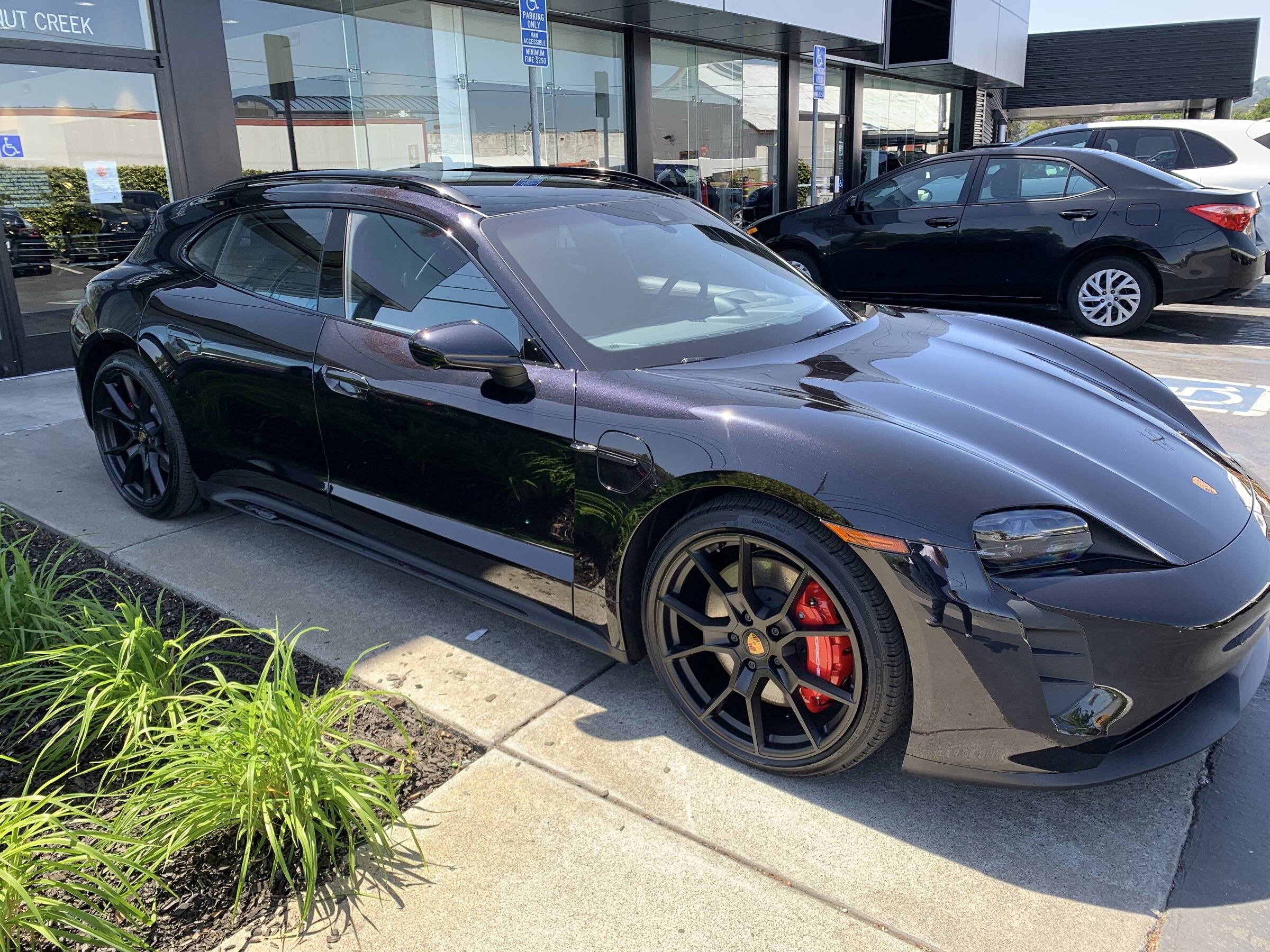

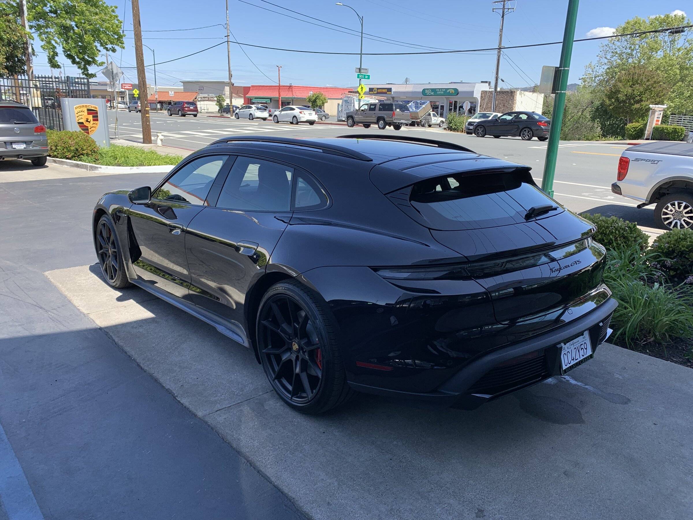

How about this. Took delivery of mt brand new 2022 Taycan GTS ST today. The car had EXPEL PPF installed at the dealership prior to taking delivery. While driving home a bird christened my Black Metallic GTS by pooping on it. I removed the bird poop from the hood with some water but there seems to be some residue on the PPF. How do I get rid of this!

I picked up my 2022 GTS Sport Turismo on Friday. Although I was advised by many to do the PPF by an installer I had the dealership do it as they claimed they had done many Taycans. Well, that was a mistake. They did not do a very good job in wrapping the seams or the mirrors. Now I am arguing with the dealership on some kind of refund. So, lesson learned. DO NOT do a PPF Wrap through a Porsche dealership.
