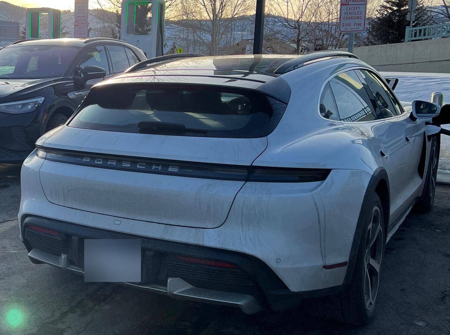

Mine is a CT so cannot comment on the sedan, but when road tripping, the back of the car gets the most dirt, so powered trunk is very useful to keep your hands from getting wet/dirty opening and closing it. Here is mine during last week's road trip. It started in pristine condition as the road-trip started at the dealer where I picked it up, all detailed and shiny.

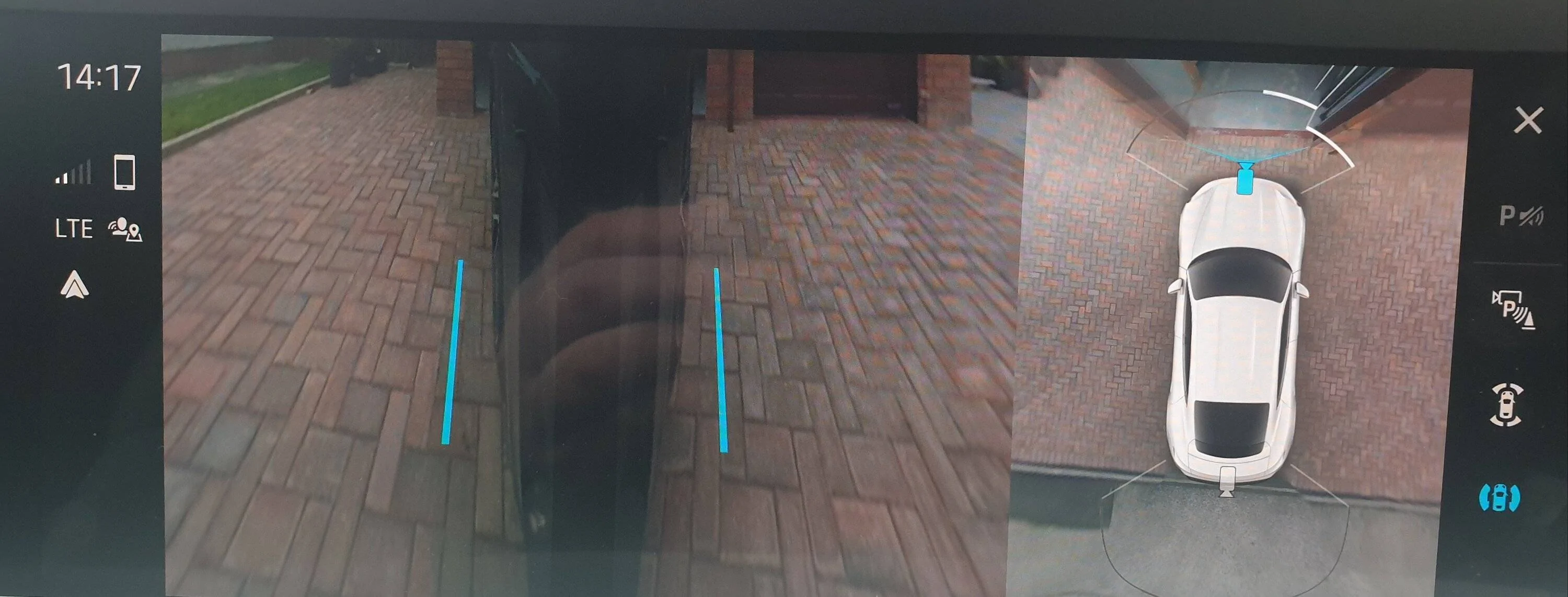

Kerb view is part of the Park Assist package(s). Cars with 360 pano view or higher (e.g. Remote Park Assist with 3D) will have a side view of the car displayed from each door mounted camera and a solid blue line to denote the safe distance from the wheel(s) to the kerb.
On the camera display you will see a solid blue line on the left and right-hand side views. When parking and your Park Assist is active simply tap the sideview icon to display.

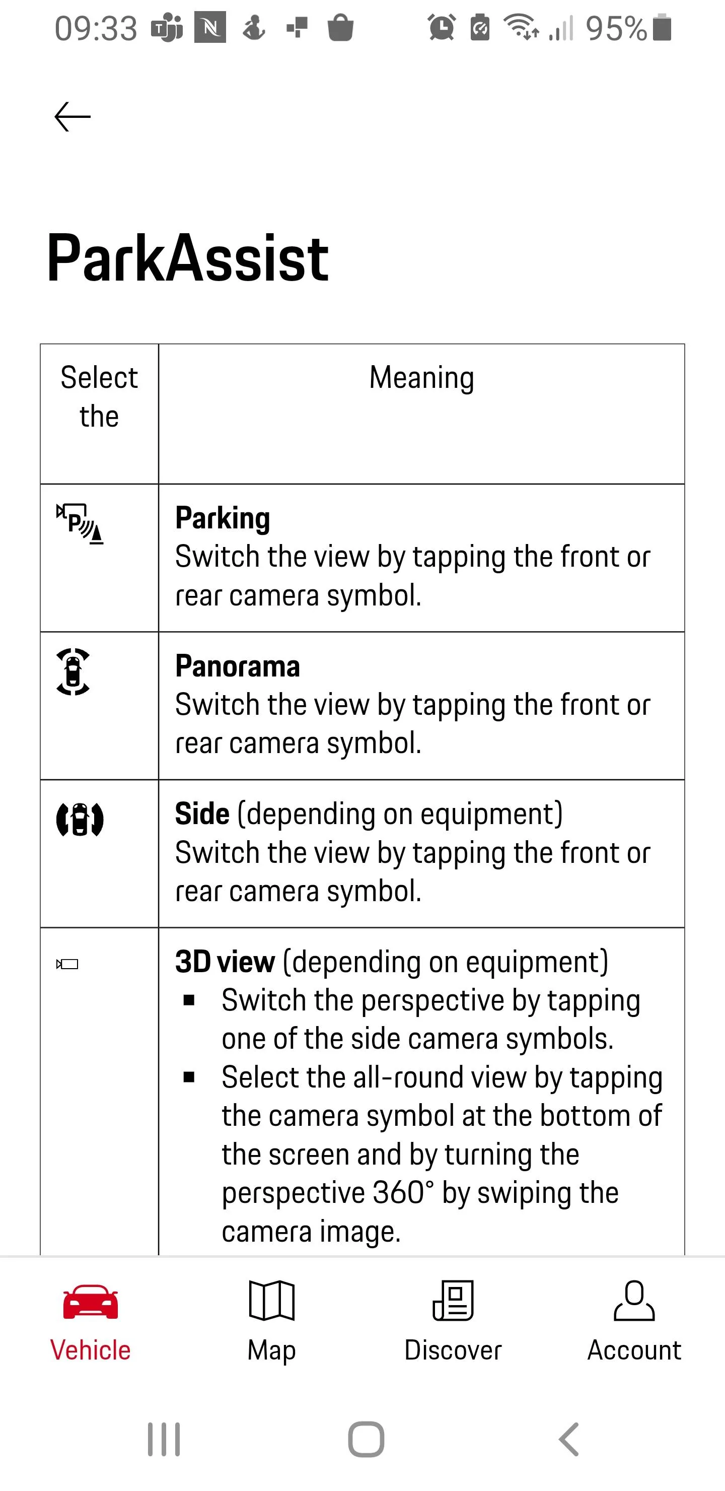

Hey, I cannot seem to find the “side view” button. I have the others, including 3D. What an I missing?

Mine is a CT so cannot comment on the sedan, but when road tripping, the back of the car gets the most dirt, so powered trunk is very useful to keep your hands from getting wet/dirty opening and closing it. I get that some people keep their Taycans in pristine clean condition, but I guess those people don’t drive a lot in the first place, so probably don't use the trunk much (unless they converted it into a beer storage for their garage, if the Taycan’s primary function is to be a mancave decoration ;) ).
Not sure. Can you send an image of your PCM with Park Assist active?

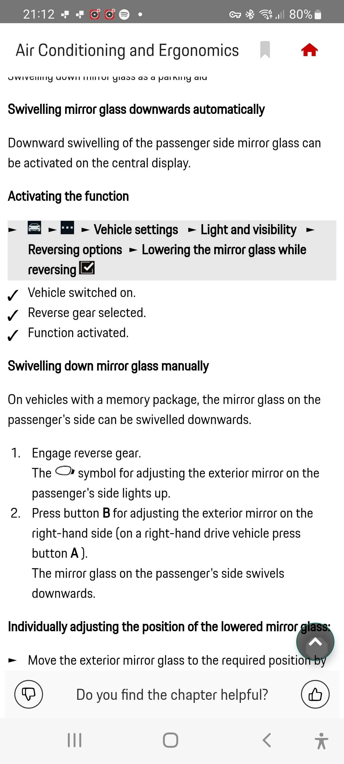

Also worth noting for OP perhaps and anyone following this thread that the dipping passenger (only) side mirror is not a function with the base 8 way seats unless you have Driver Memory Pack. Standard with 14 or 18 way seats.
Do you know if it's possible to add the option? even in EU? as it's available in US... I mean, I used to go through Bimmercode for BMW.
No, no idea - Guessing probably not
