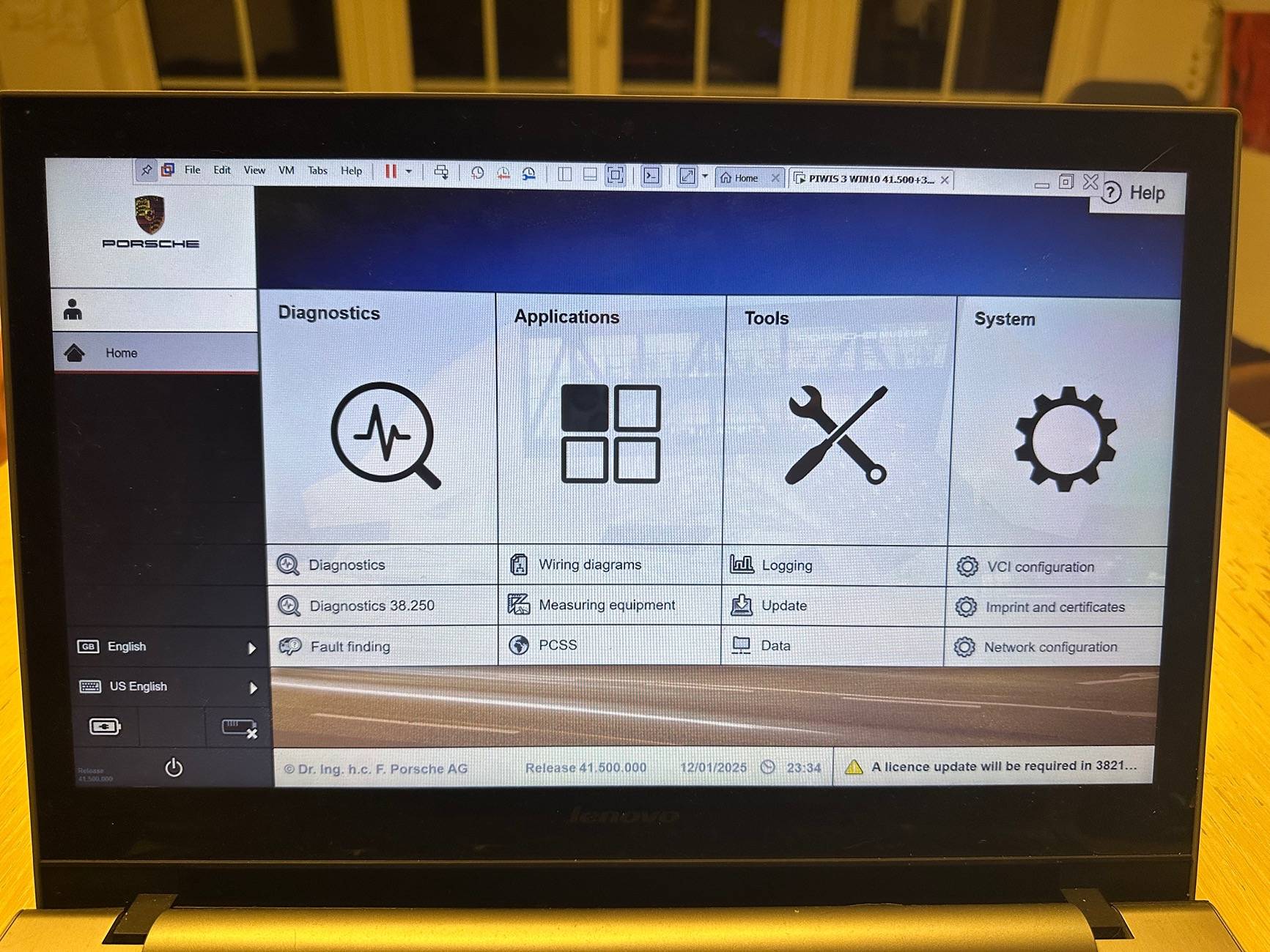

Once you have the VCI driver installed, you should see something like this:-
Porsche Taycan Piwi diagnostic program for Porche Taykan 1736716655944-g2
The sequence to start using PIWIS is :-

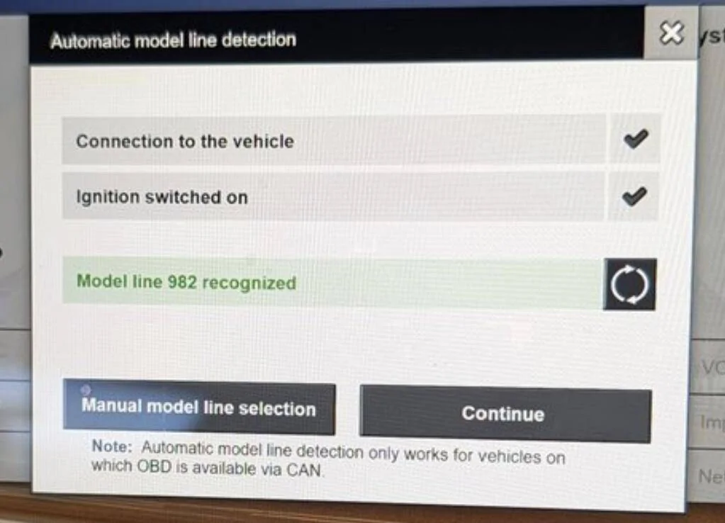

4. The system should auto detect your vehicle with a screen like this
Porsche Taycan Piwi diagnostic program for Porche Taykan 1736716795065-a3
5. On the PIWIS Tester start screen, call up the 'Diagnostics' application.
The vehicle type is then read out, the diagnostic application is started and the control unit selection screen is populated.

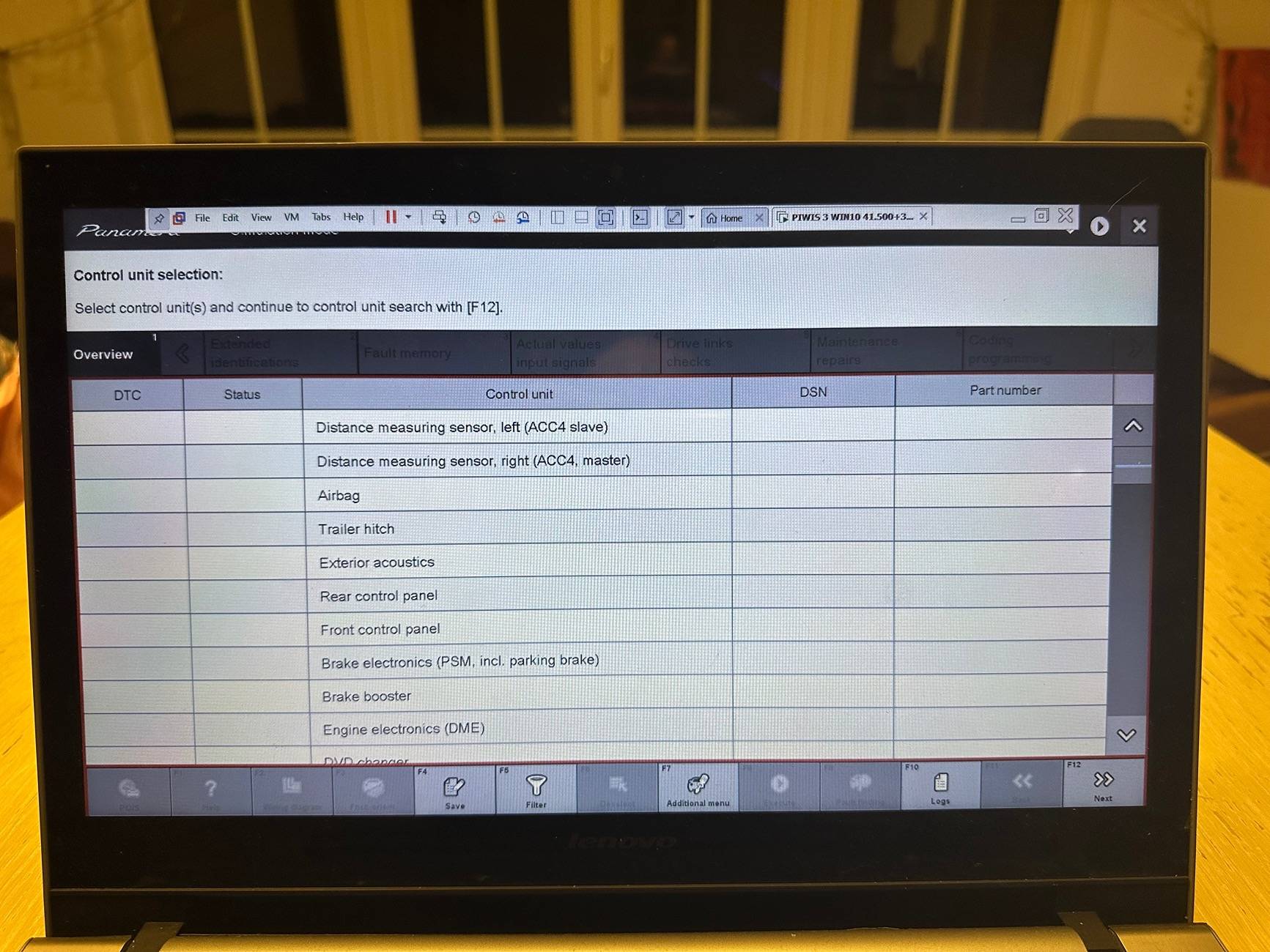

6. Read out and erase the fault memories of all control units.
6.1 Press F7 in the control unit selection screen” ('Overview' menu) to call up the Additional menu.
Porsche Taycan Piwi diagnostic program for Porche Taykan 1736718100913-n4
6.2 Select the function “Read all fault memories and erase if required” and press •F12“ ('Next') to confirm Erasing fault memories.
The fault memories of the control units are read out.
6.3 Once you have read out the fault memories, check the fault memory entries.
Information
6.4 Press F8“ to delete fault memory entries.
6.5 Press F12“ ('Yes') in response to the question as to whether you really want to delete all fault memory entries.
The faults stored in the fault memories of the various control units are deleted.

According to what I read in the explanation for installing the Drive, they say, Next up is to get the link to the VAS 6154 up and running. The software instructions have this ominous message:
Never and under any circumstances DON’T start the VCI driver with computer connected to the Internet and VAS6154 connected to it, as this will immediately remove the license from VAS6154.

Have read about the warnings, but have to say that I cannot see why the VCI will call home on its own, so no idea where that has come from. Personally, I would ignore those warnings.
From what I understand, you would need to open the VX manager programme and request an update to the firmware to make changes to the VCI.
However, if you want to be sure. just make sure you are not connected to the internet when using PIWIS. PIWIS does not require the internet, so disabling it will make no difference.

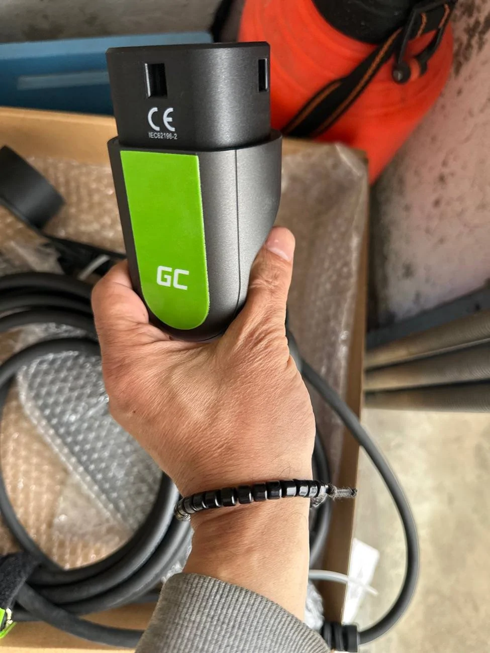

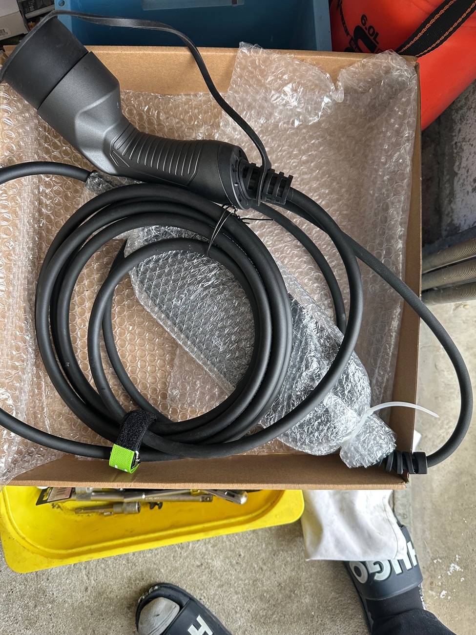

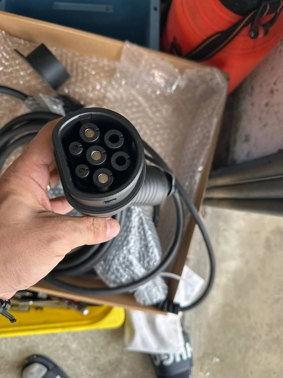

Hi Shug, good afternoon, ok, the charger for the 800V battery has arrived. I'm going to finish assembling the interior, connect the 12V battery, remove the high voltage switch from off and put the car to charge at least up to 80% with a slow charge.

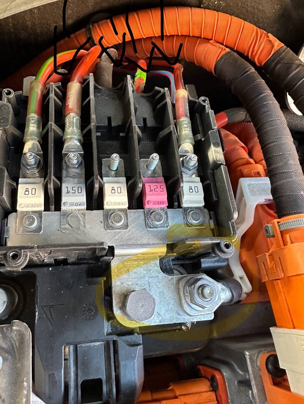

Carlos,
I think there are two layers of fuses above the 12v battery.
Check the wires coming in, everyone has a fuse.
I apologize, I only saw your message now... do you mean that underneath this line that I checked today there is another line of fuses on the 12v battery... ????...
If so, tell me something, because I haven't connected the 12V battery today and I also haven't connected the safety switch to charge the car. I was thinking of doing that in the morning. If there is another line of fuses underneath this one, in the morning I'll disassemble it again and open the bottom part after this line, which I think only has fittings for the top part to come out...
As you can see in the photo, in order to climb up this fuse line and access the one below, in principle I will have to remove the positive screw (circled in yellow) and lift, unclip the fittings from the black box above the battery and remove the fittings...! Can you tell me how I can access the bottom fuse line???? Yes, I saw that several cables enter the bottom of this line in the same box,... (black arrows in the image), high voltage cables (orange) pass alongside and behind... Isn't there any problem, is there????

That is correct Carlos, you will have to remove the screw circled in Yellow to get to the wires / fuses underneath.
When I remove the screw and pull that row of fuses up to access the bottom, there is no problem with the orange high voltage cables coming out of the back and side... I ask this just as a precaution...
