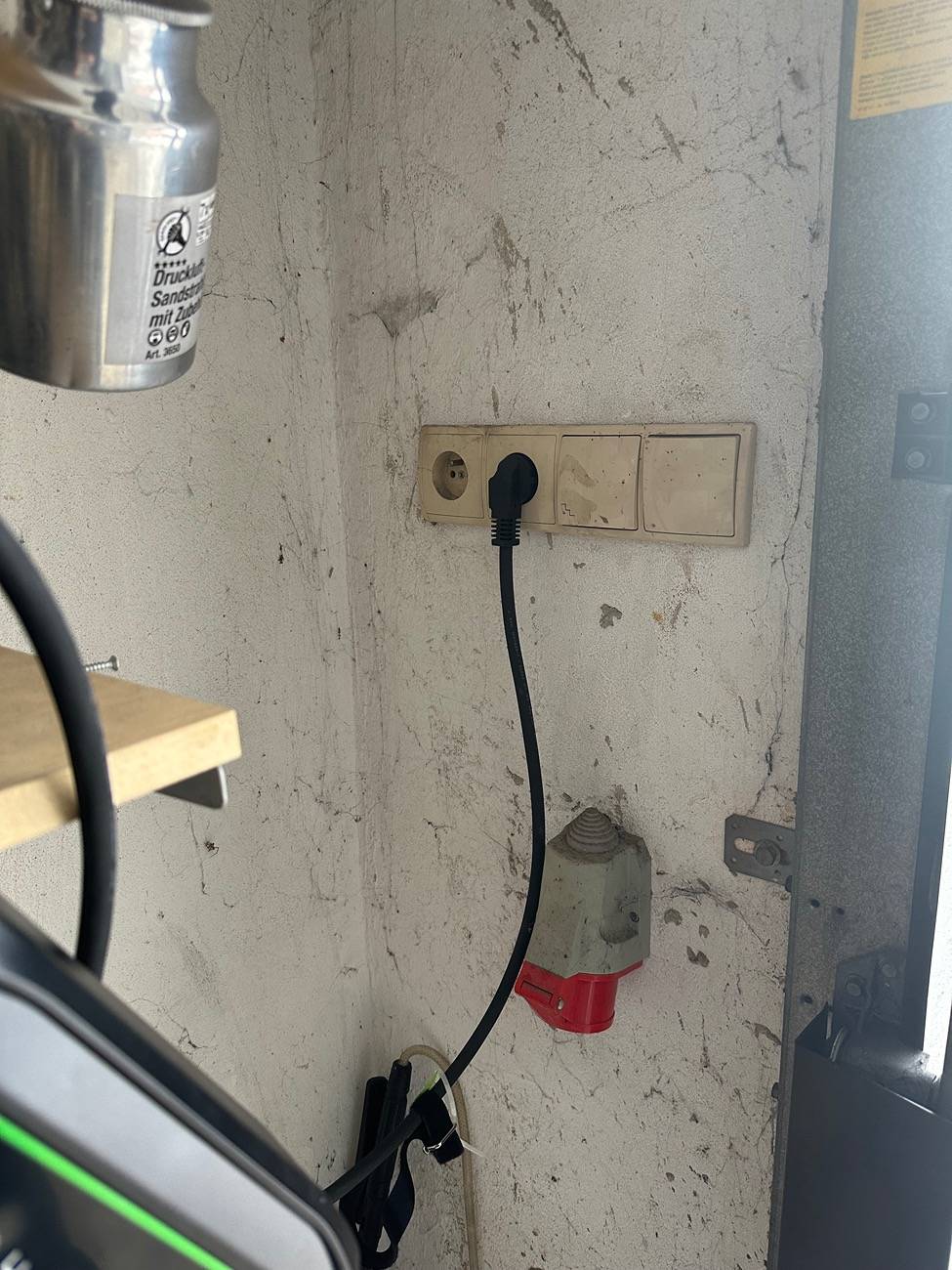

Just to be clear, my concern was for your house wiring, socket and a plug, your can can deal with 195V AC no problem. But, if the voltage drop is due to a loose connection in your socket, it could over time damage/melt it - something you would not not noticed in the past because nothing was drawing 16A for 12hrs straight.
Yes, I understand, but that being the case, there is no problem...

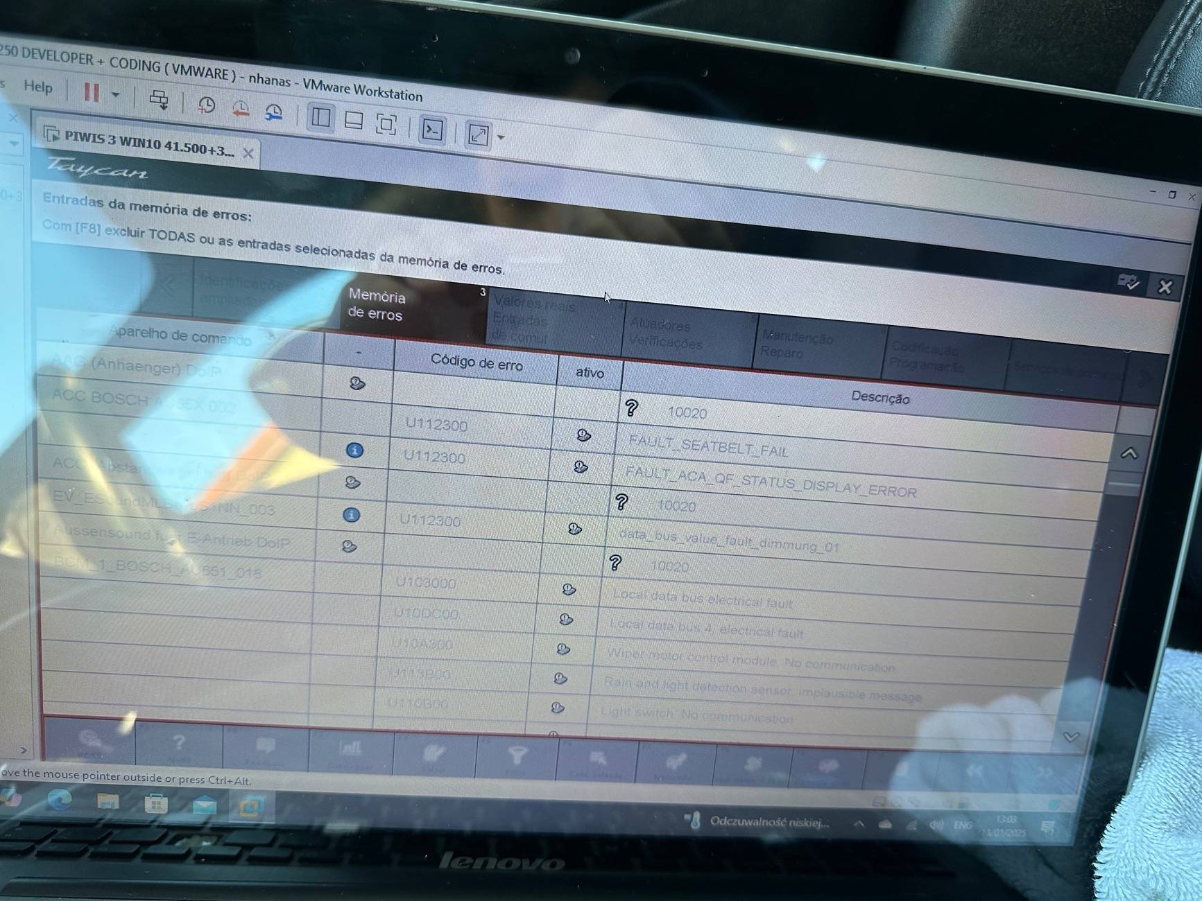

Hi Shug ,hope you are well. I wanted to share an update on the diagnostics I intend to perform on my car.
I am still waiting for the 12V battery charger to arrive, I am considering continuing the diagnostic process in the meantime. My goal is to:
Run diagnostics to identify existing issues.
Temporarily clear fault codes to see what issues persist.
However, I am aware of the potential risks of running diagnostics without a fully charged battery, such as inaccurate results or power issues. Before proceeding, I will ensure that the battery has sufficient charge by checking the voltage and minimizing power usage during the process.
I have no idea how long it might take to diagnose the car's errors and erase them, hence my request for information and opinion.
If you have any additional advice or suggestions, I would greatly appreciate your input!

Hi Carlos,
No problem to run the initial diagnostics routine that I gave you without the charger, just be careful to monitor the battery voltage on your dashboard and you will also see it displayed on PIWIS.
With the charger, set it to 14.5V offline before you connect to the 12V battery and it will keep the voltage where it needs to be.
Without the battery charger you should see 13.5V, whitex can maybe confirm what he saw on his car, but do not let the battery voltage drop below 12.5V.

I pressed f8 to erase all selected entries from the error memory and the program doesn't seem to have frozen, nothing... what should I do now...???????
Porsche Taycan Piwi diagnostic program for Porche Taykan IMG_8591

Please describe all the steps you have taken to this point?
You can copy the list I gave you and confirm complete for each step

Information
6.4 Press F8“ to delete fault memory entries.
6.5 Press F12“ ('Yes') in response to the
question as to whether you really want to delete all fault memory entries.
I was in the penultimate step (….press F8 to delete fault memory entries…..) But in the meantime it froze, I waited for about 40 minutes nothing changed and I removed everything, I turned off the car's ignition and now I turned everything back on again I will start from the beginning again to check the existing errors again, delete the errors and get back what is left, I hope it does not freeze again the battery value has always been at 13.5 V

The Battery at 13.5V means you should be fine.
