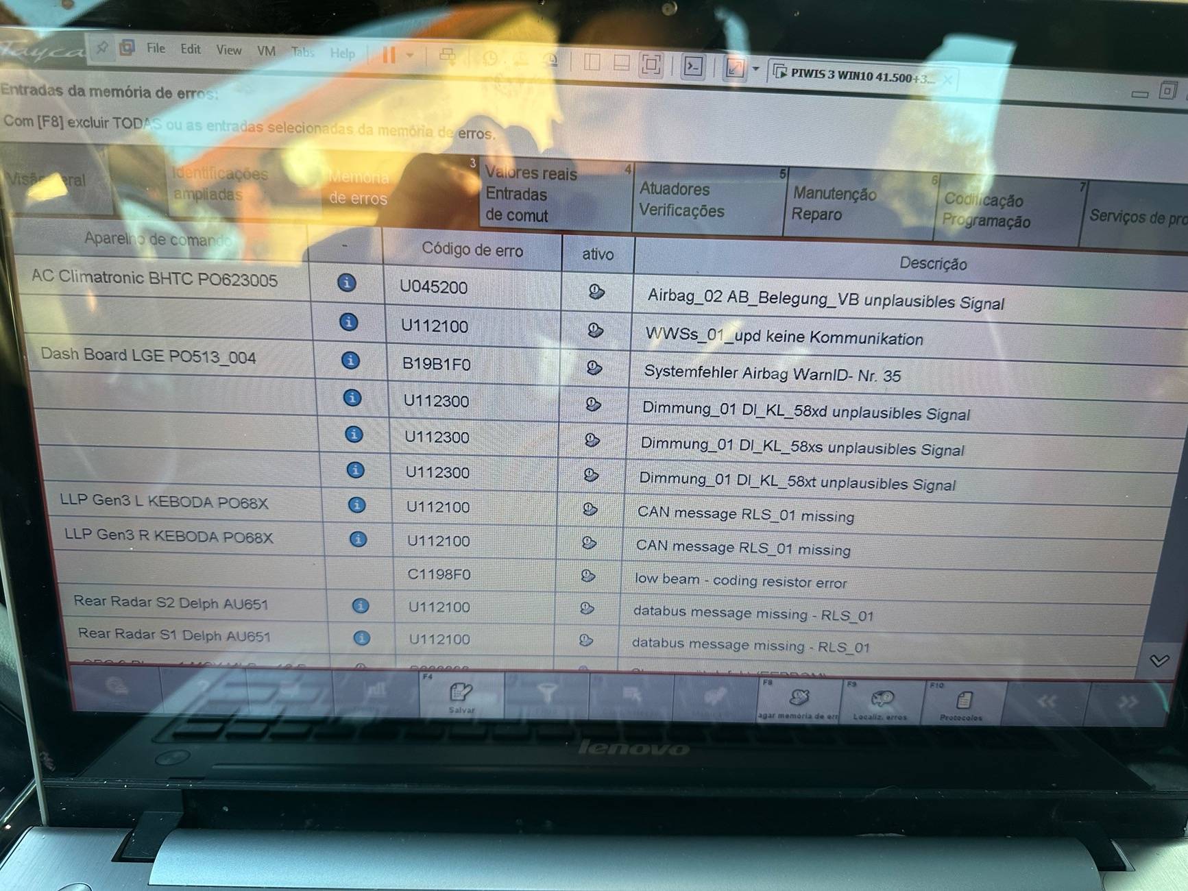

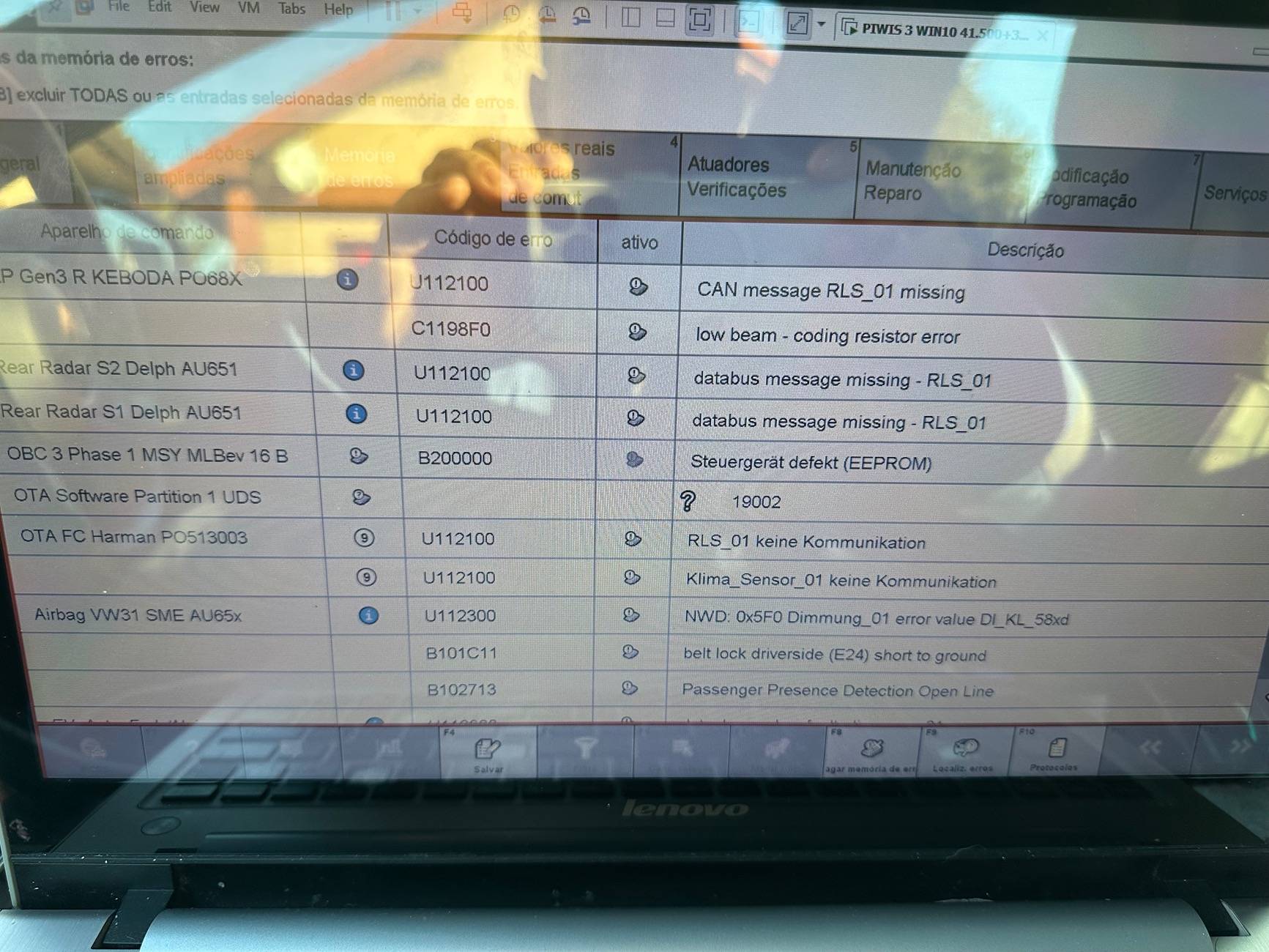

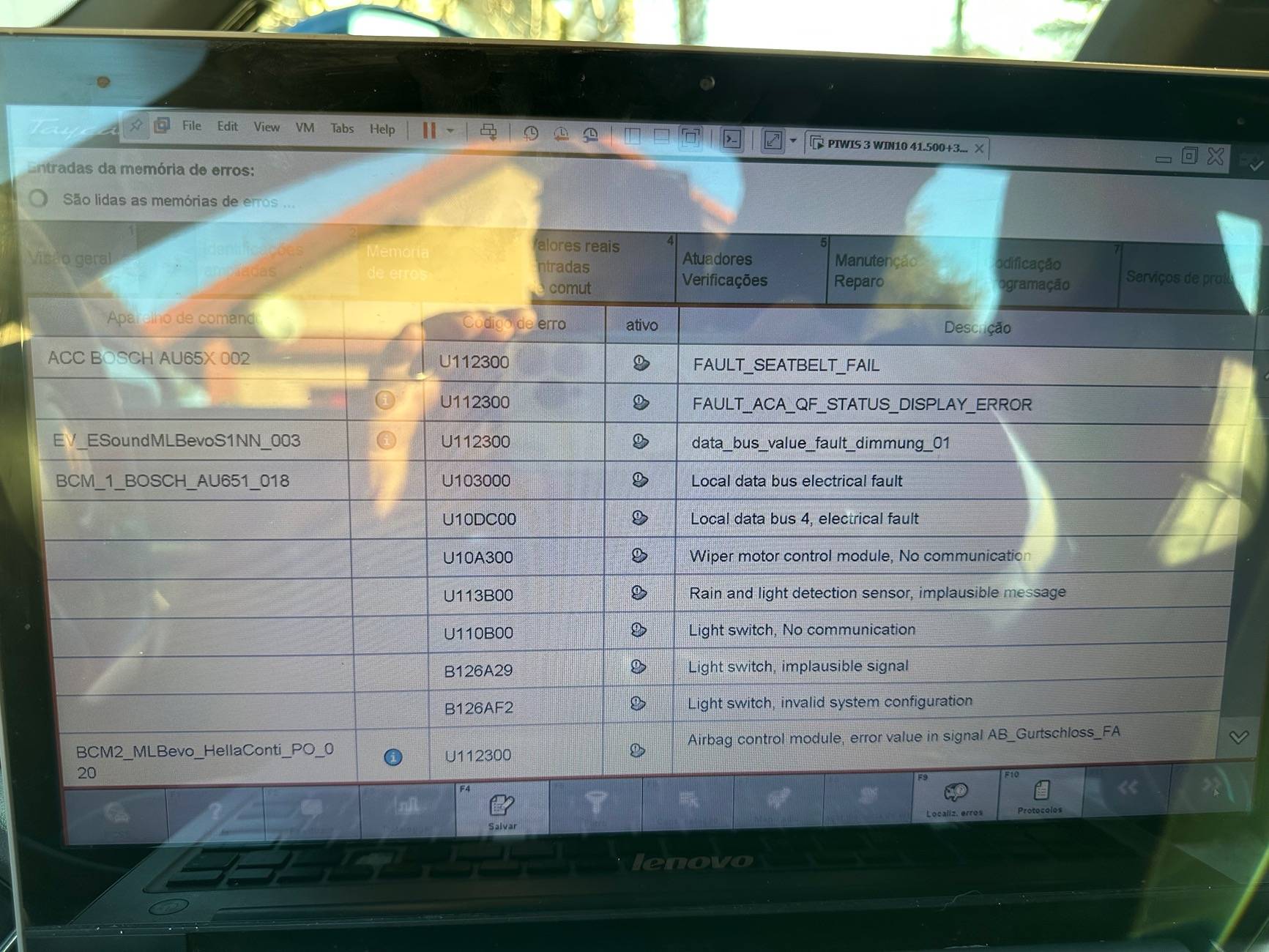

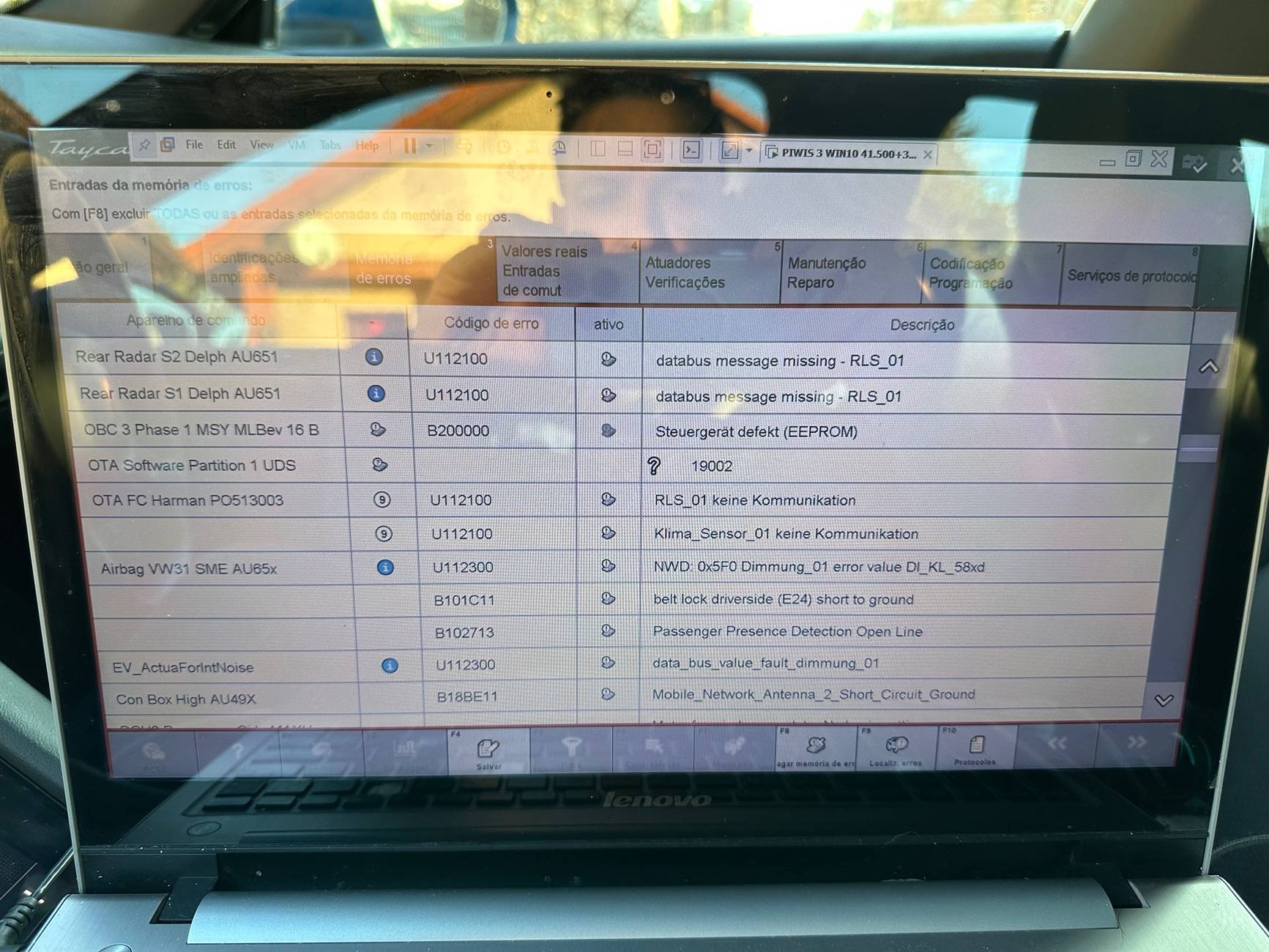

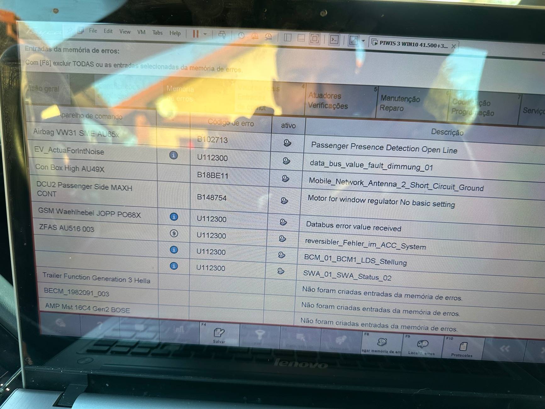

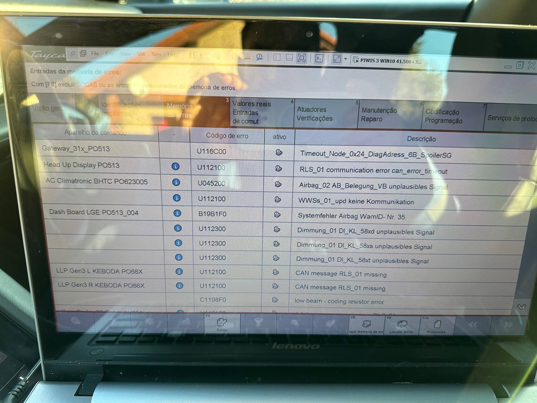

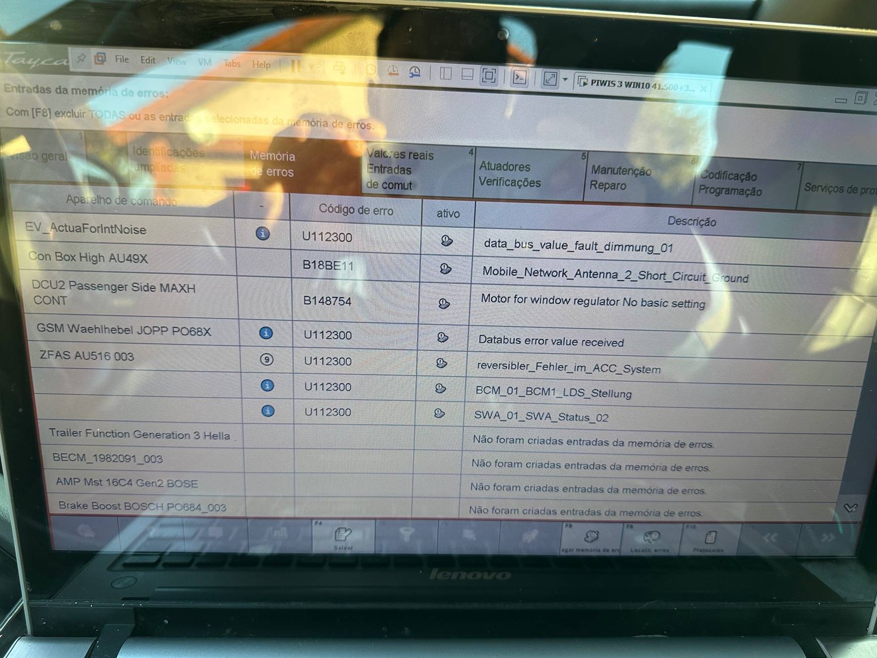

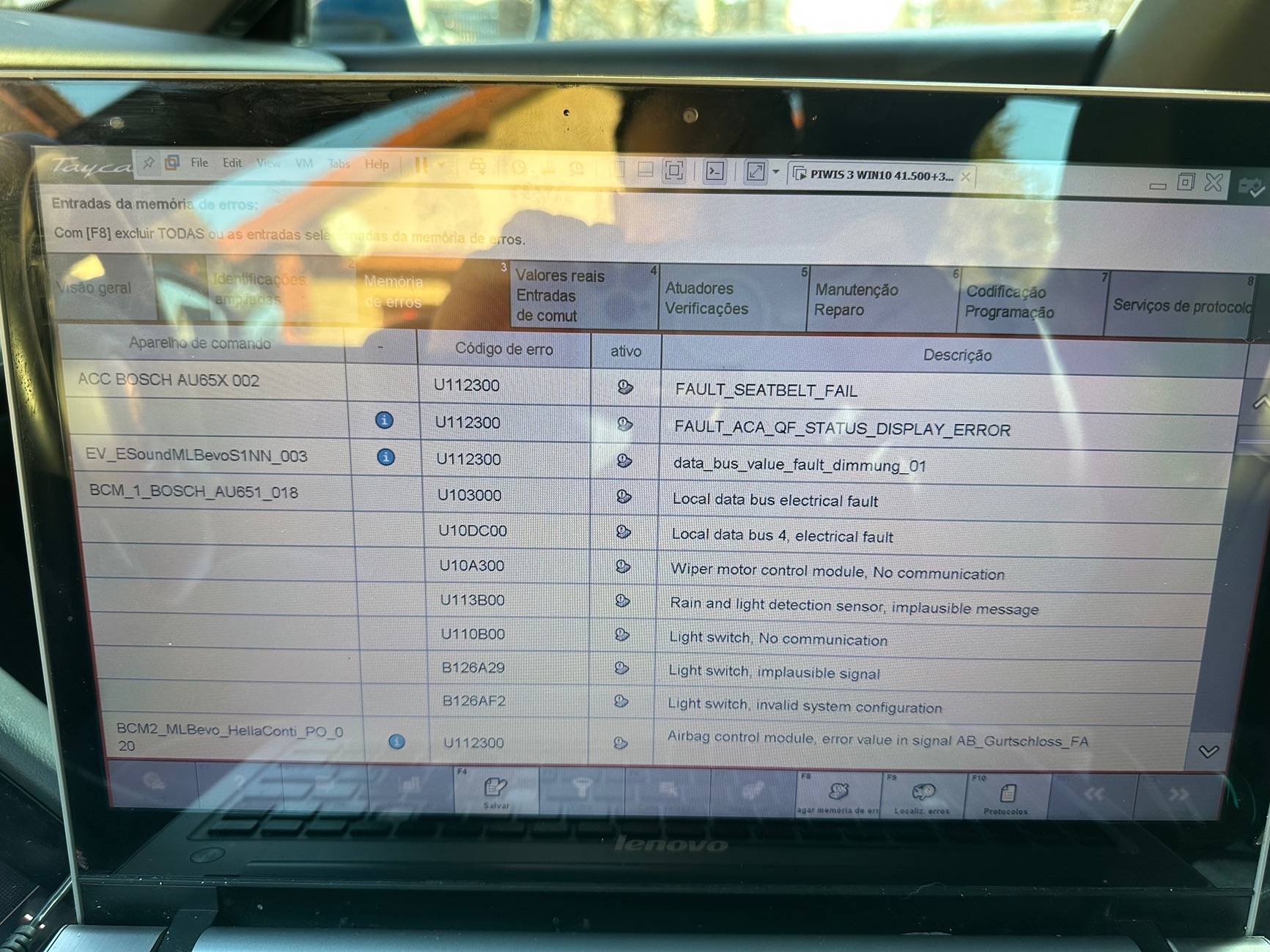

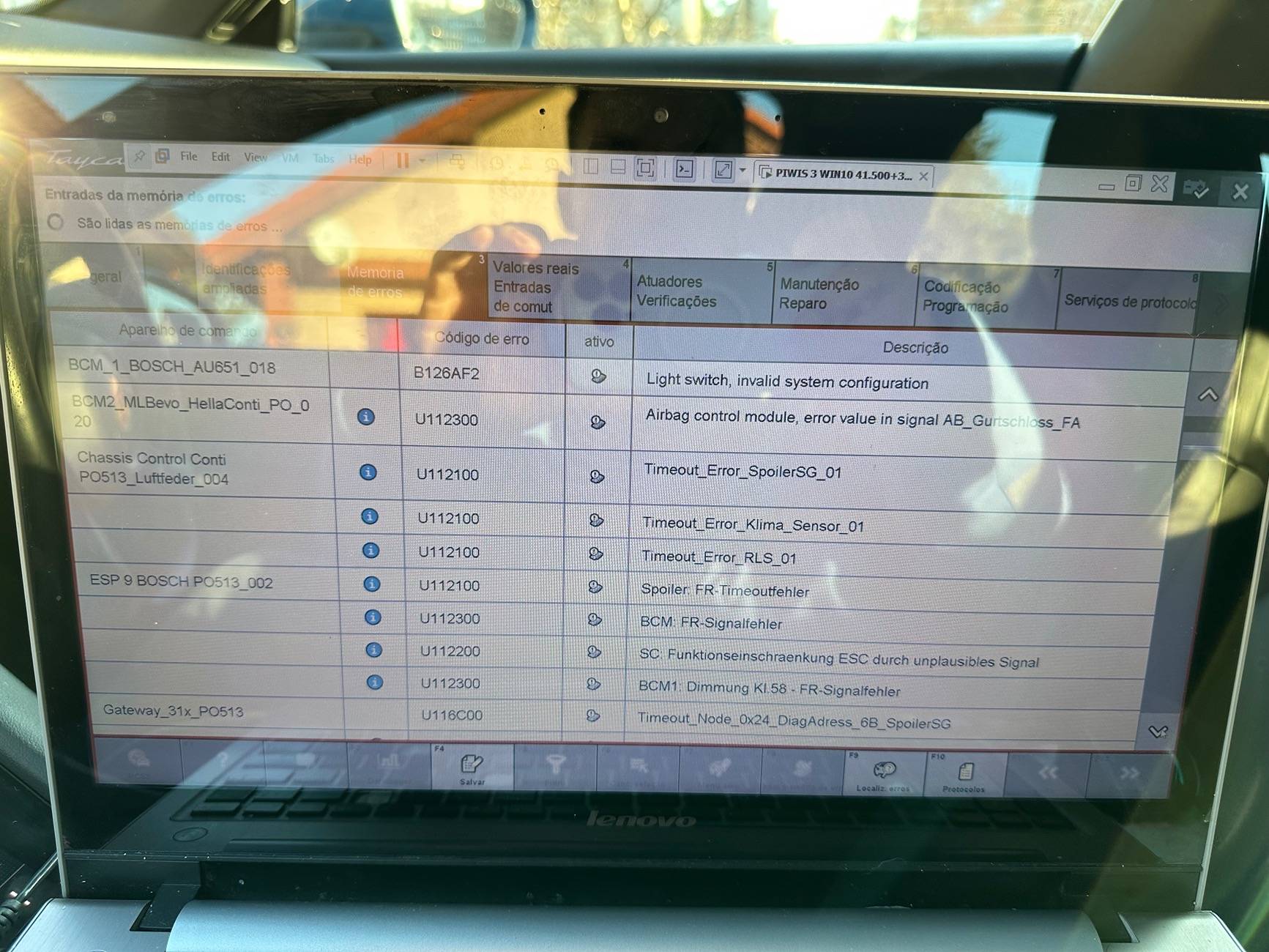

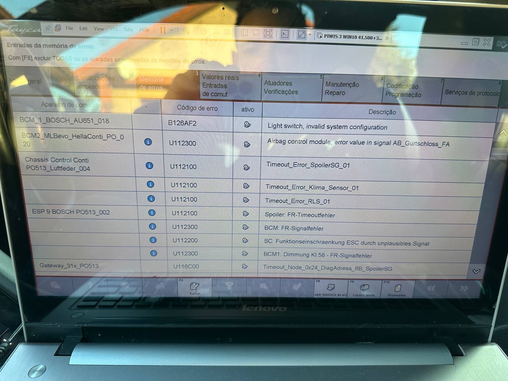

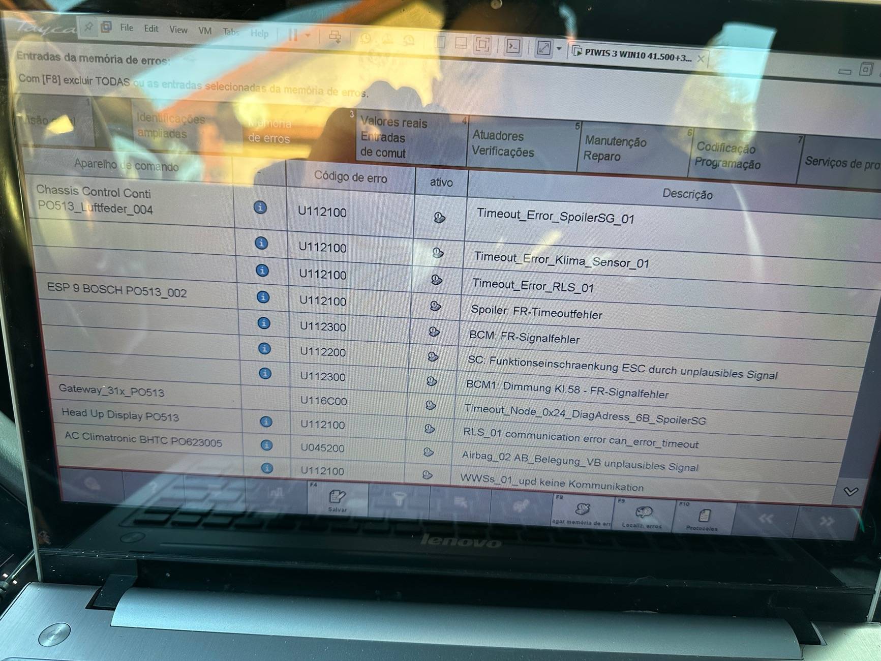

this is what appears after you have erased all errors in memory...After deleting all the errors in memory, these remain, what will be the next step….???

You have not deleted the errors, only red are active errors.
Grey are not active and should disappear.
Suggest you go carefully, you can use your mouse to click on the onscreen buttons or use the keyboard buttons.
Also suggest that you work in English if you want us to understand what is on the screen.

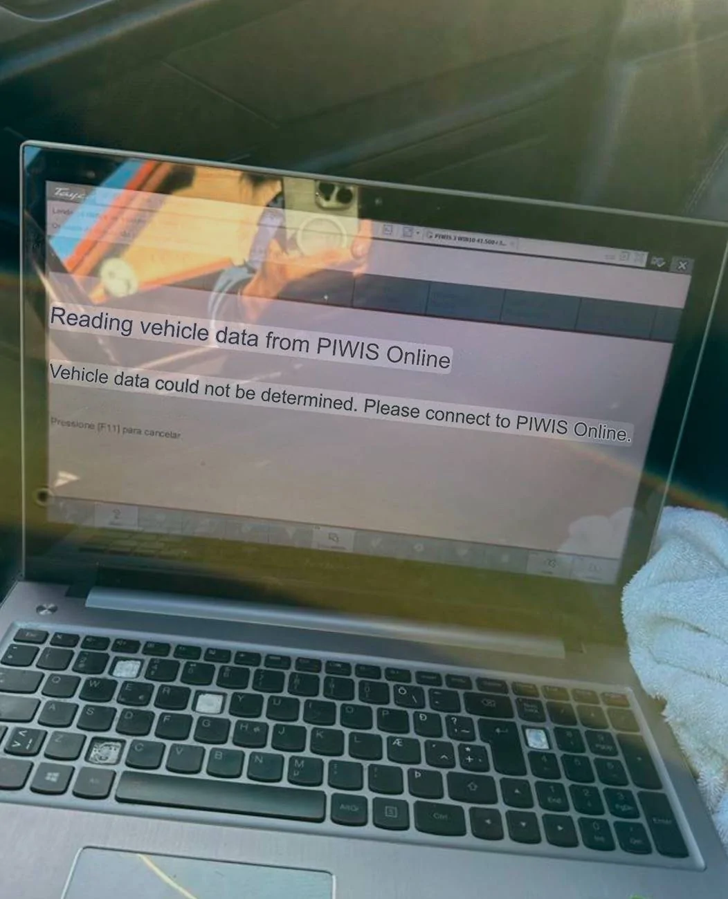

When I was reading the errors, this appeared to me, and it is better to connect the computer to the internet...is that correct???

Not sure what you have done, but that is trying to dial into Porsche
Go back or start again
I didn't do anything special, I just followed the sequence you sent me earlier, yes, it is trying to connect to the Porsche server, but I don't have the internet connected, I'm going to go back!
