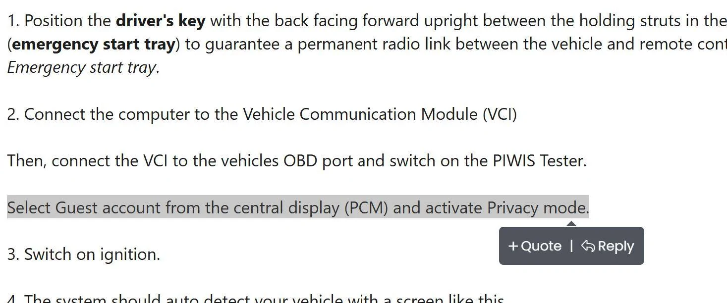

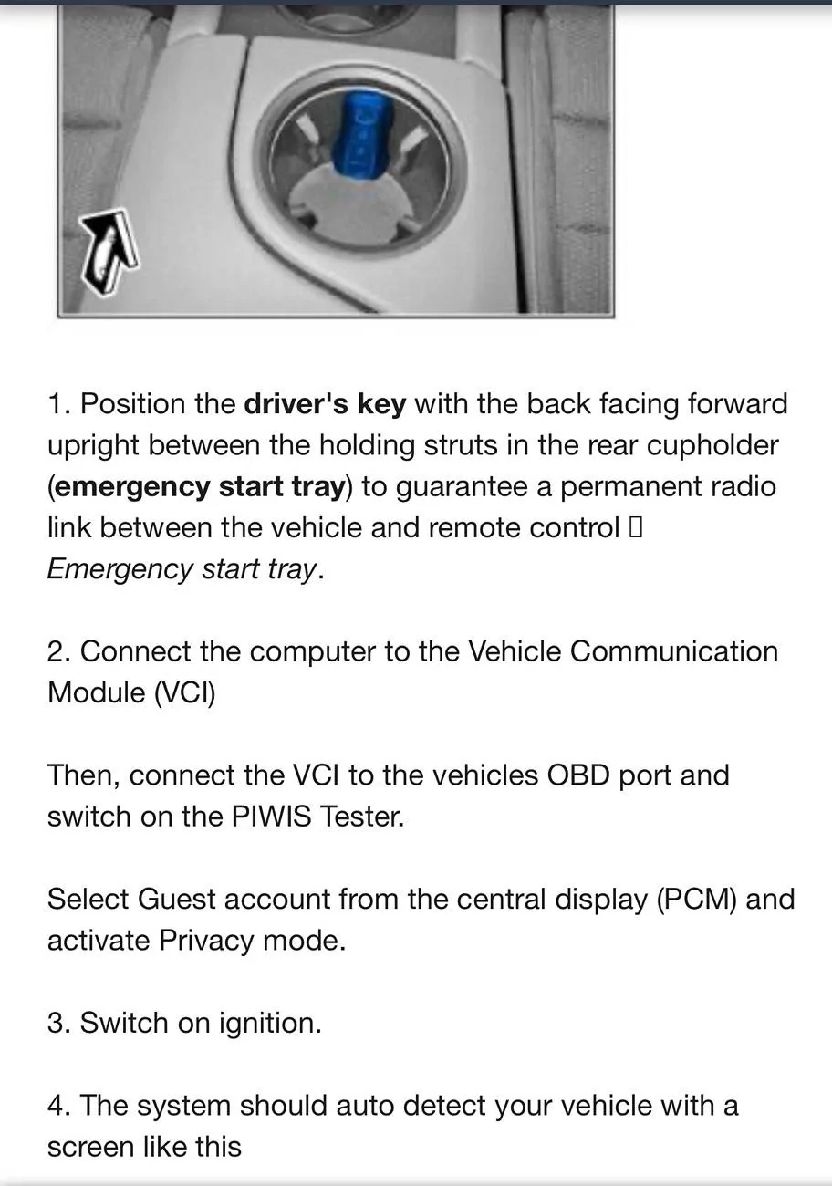

Did you set the dashboard to guest account?

Is that a yes or a no?

yes, and private mode, unfortunately I always have to log in as a guest because I can't log in with my account and have remote access, just yesterday I was trying and in the end the SOS light went from green to red (another error) I have the application open and registered with the dealer but I can't log in with email and password

OK, I wondered if this is why PIWIS was trying to dial into Porsche, not seen that before and wondered if that was adding to the errors you are seeing.

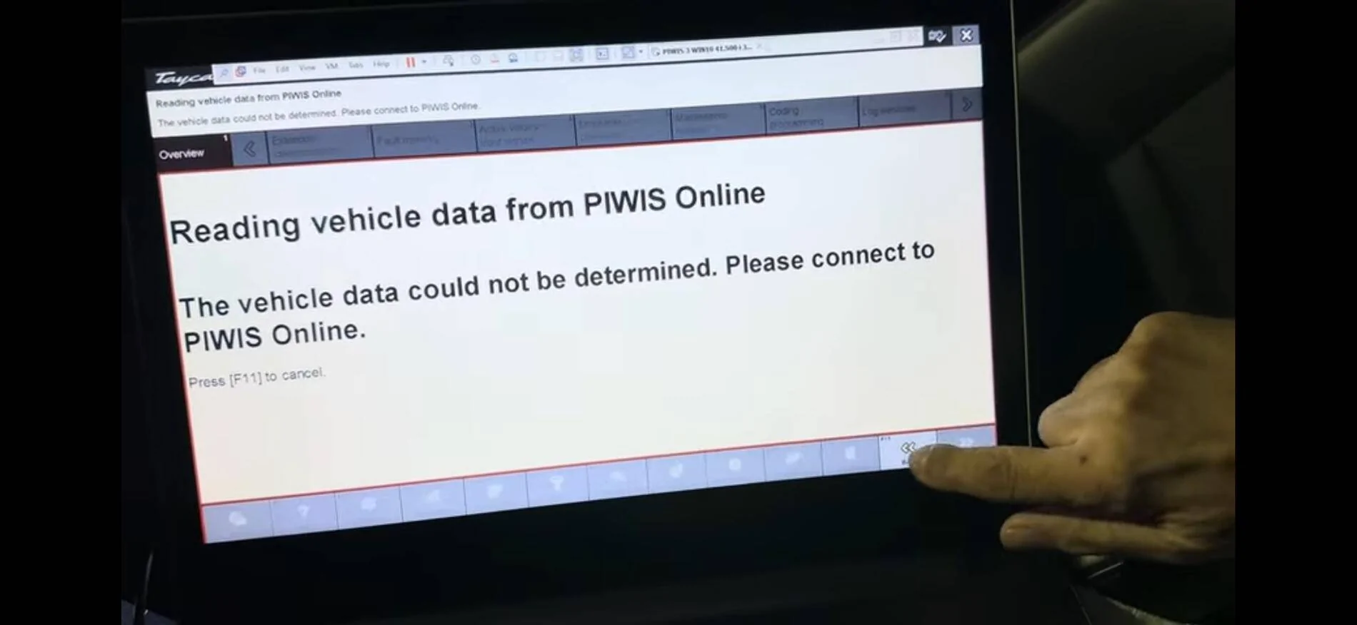

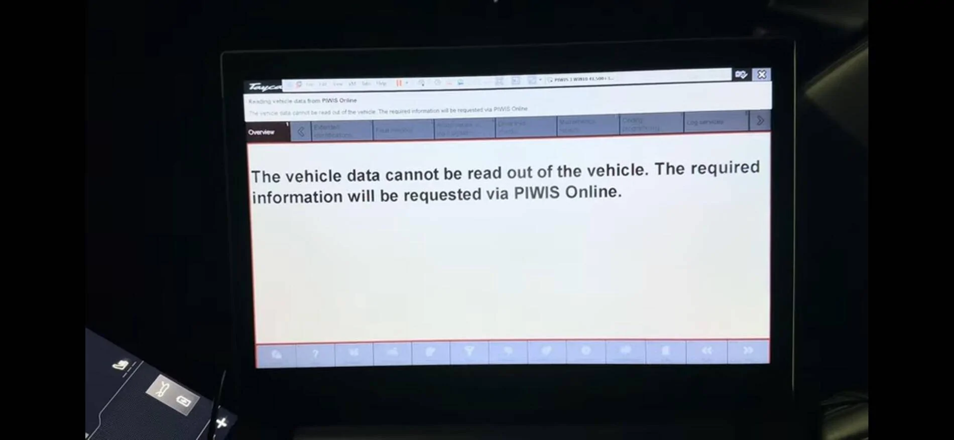

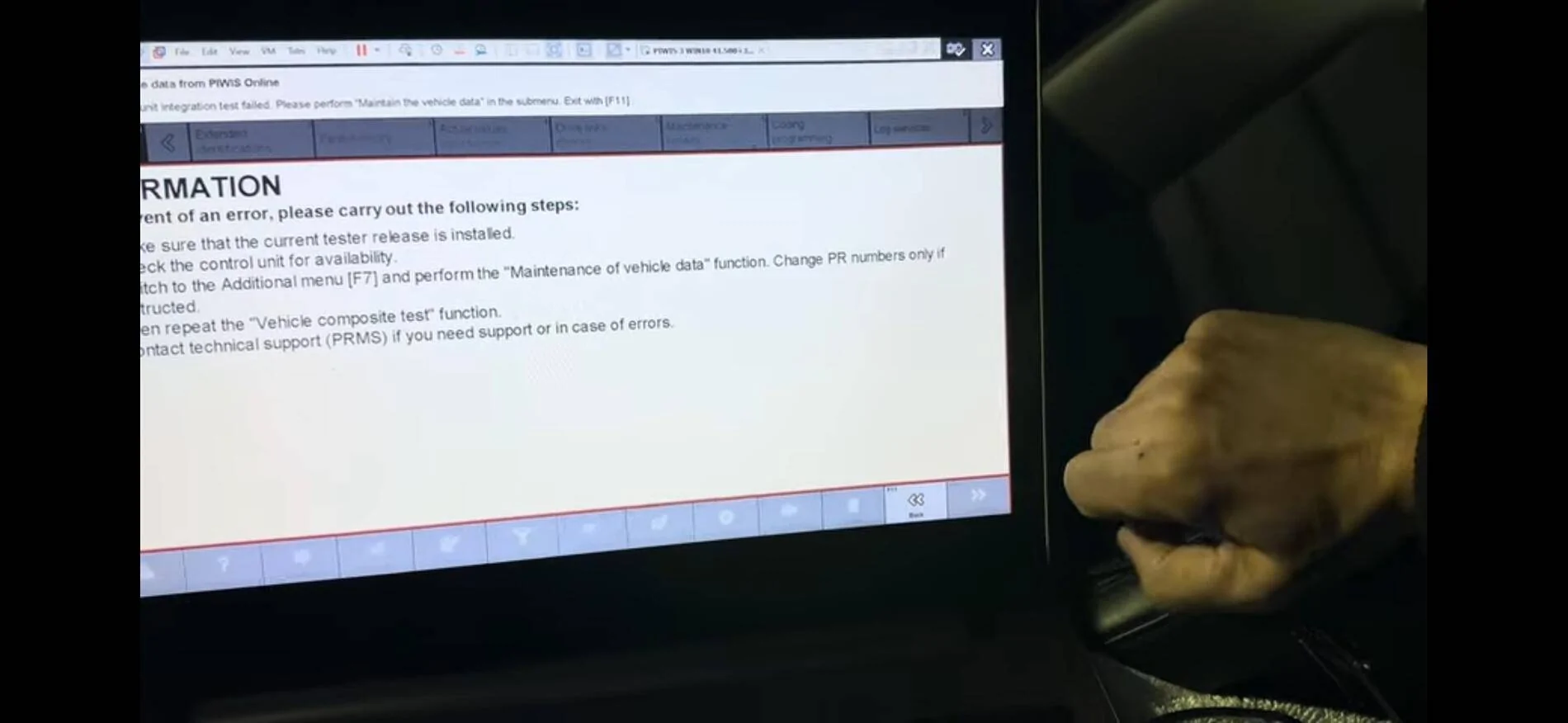

I don't know why either... I'm pretty sure the car has never been in an accident, but it's actually strange because it gives an airbag error and the airbag light is on yellow on the dashboard but there are no open airbags... Can you determine which airbag the diagnosis refers to...??) I also don't understand why all the errors are in English and German too... Yes, tomorrow I'll do a new diagnosis and publish the active errors here!!!! But do you think this piwi is working as it should in the video, as you can confirm by pressing f7 (it says it's reading the vehicle's data online) (then it says that the vehicle data can not be determined) I have to press f11 to go back and then I can check errors, the errors don't appear in red, and German is mixed with English... I think there's something here that shouldn't be working like this……

OK, I cannot answer why it is trying to call Porsche, but get all the errors up on the screen and copy them here. so that everyone can see.
One thing you can check is whether all the airbag wiring connectors are fully home, especially the ones near where the damage to the door was evident

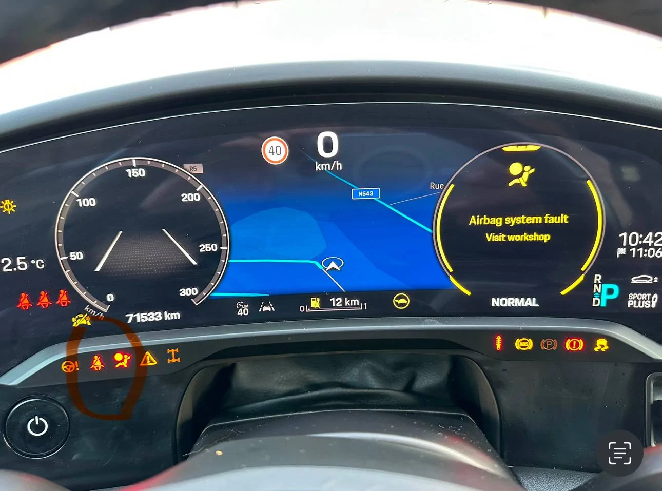

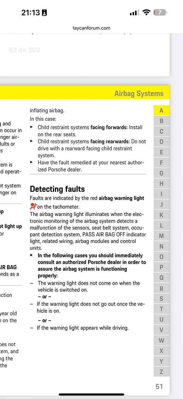

As you can see, in addition to the airbag error, it also shows an error in the seat belt (that is, the warning light for putting on and taking off the seat belt is always on, only in the front seat belts, I already had the old seats, I put in new seats that are the same as the original ones in the car and the seat belt light remains on on the dashboard and until now no front seat belt error has been mentioned.

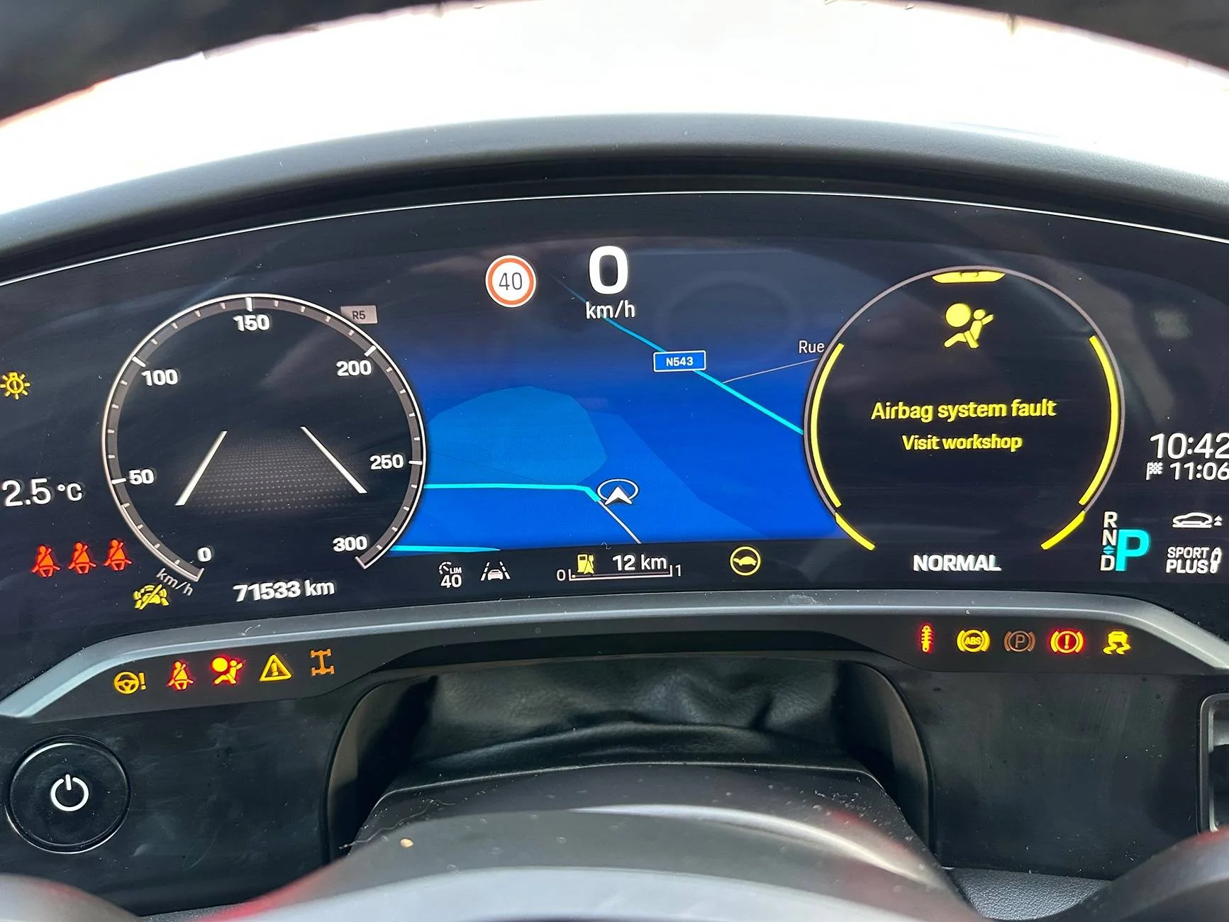

When I bought this car, the first thing I bought were the original back and front seats, the same as those in the original car. And why? Because the back door was vandalized, the back and front seats were also a little damaged at the top of the headrests. Since these seats are leather, I decided to change everything. The car already had the front seat light on on the instrument panel with the old seats, which was on when the seat belt was removed and put on. When I changed the old seats for the new ones, because our new seats had the new seat belt slot. I was waiting for the light to go off on the instrument panel, but it didn't. The new seats work perfectly, because they are the same as the originals, but the front seat belt light is still on on the instrument panel.

When I bought this car, the first thing I bought were the original back and front seats, the same as those in the original car. And why? Because the back door was vandalized, the back and front seats were also a little damaged at the top of the headrests. Since these seats are leather, I decided to change everything. The car already had the front seat light on on the instrument panel with the old seats, which was on when the seat belt was removed and put on. When I changed the old seats for the new ones, because our new seats had the new seat belt slot. I was waiting for the light to go off on the instrument panel, but it didn't. The new seats work perfectly, because they are the same as the originals, but the front seat belt light is still on on the instrument panel.I'm starting to think that the Aibags error light has everything to do with the safety light or vice versa

I would check the Airbag wiring to be sure you have not got a bent pin and that the plugs are correctly seated.
PIWIS might tell you where the airbag fault is

Yes, it could just be an error in the pins or the fitting, but the question is, is it possible to know which of the airbags is emitting the error…???
