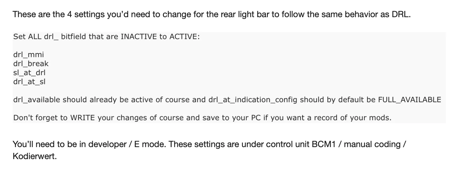

Mars did mine last year on my J1.2 and that outcome is a little different. Matrix works perfectly but afterwards, my parking lights are always on. I can manually turn them off but only while parked. It’ll automatically come back on once I move. Ie, stoplight then drive again.
Side markers are always on as well as rear parking lights and my lit logo. Got used to it so I don’t mind.

Check these parameters. DRLs function like that as a result of having the rear light bar always on.
Porsche Taycan PIWIS Matrix coding - lost option 1773079264076-zf
